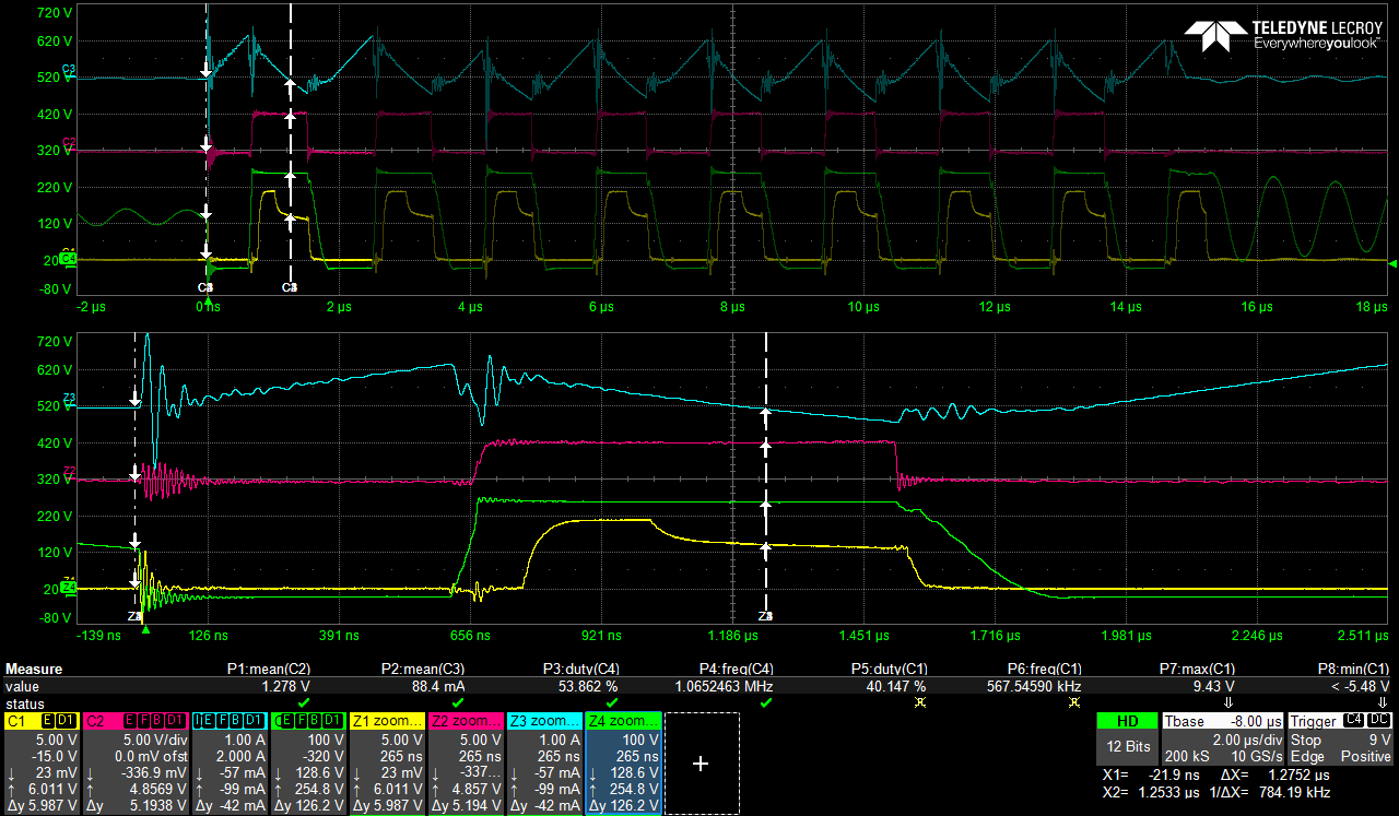

As you can see on the scope picture below, I think the PWMH needs to be delayed in order to get the High Side transistor in ZVS.
  • CH1 : Vgs of SR mosfet
  • CH2 : Vgs of high-side mosfet
  • CH3 : Current in primary of transformer
  • CH4 :Voltage at switching node
Tests conditions : Vin = 140Vdc, Vout = 22Vdc, Pout = 20% of Pmax
Is it possible ? Because it seems that at low Vin, it is fine but when the voltage goes up, the losses are too high for the cooling.
