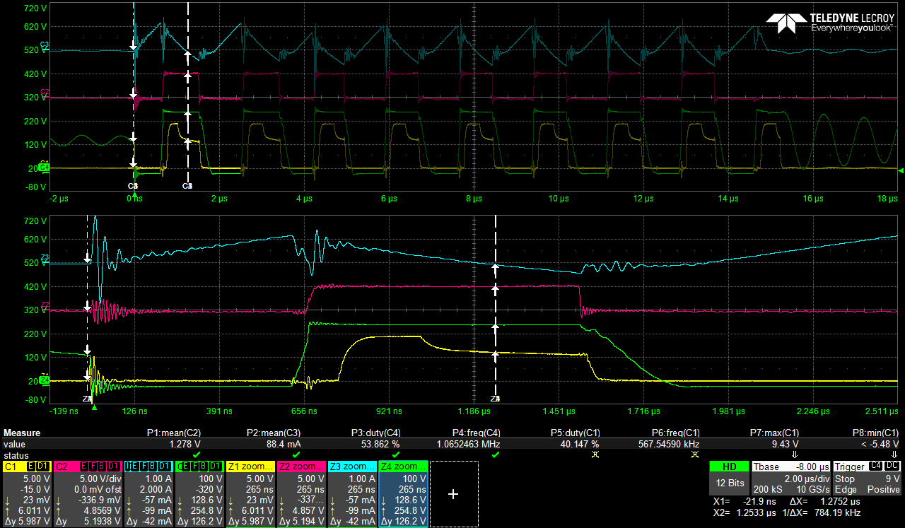

I have tuned the ACF so far at Vin = 140 Vdc.
However I can not get too much higher because I think I have a wrong behaviour of the converter.
Correct behaviour (at least, I think it is...) at 140 Vin:
  • CH1 : Vgs of SR mosfet
  • CH2 : Vgs of high-side mosfet
  • CH3 : Current in primary of transformer
  • CH4 :Voltage at switching node
(maybe the 3rd peak current is a little bit smaller than the others)
Wrong behaviour at 200 Vin :
The second peak current is too low (because Ton_L is too short) and after the 2nd pulse of high-side, the controller seems to transition to valley switching (LPM). Also, synchronous rectification is lost at the second pulse.

  • Hi Julien,
    Some comments as below:
    1.  Different peak current at 1st and 2nd pulse , if you added a ARC circuit (a resistor + MOSFET driven by RUN)on FB pin , this circuit will pull current out of FB pin when RUN is high , usually , there is a delay for ARC circuit to impact FB current . that is why you can see a different peak current. another impact is from line compensation. the higher input voltage , higher compensation current out of CS pin , then a offset voltage generate on the resistor connected between CS pin and current sense resistor.
    2. SR missing pulse at 2nd PWMH on time . the clamp capacitor was over discharged during the first PWMH on time(Also see SR turn on time is longer than other cycles) . in the next cycle , almost all of energy was transfer to clamp capacitor other than to secondary side . so no current through SR . this is a normal behavior.
    3. Missing PWMH pulse (ABM--> LPM mode), if at 20% full load , it should not generate ABM 9 pulses and 6pulse , it looks  to me like the ABM mode is unstable , caused missing PWMH pulse . So can you share the schematic to me for reviewing . the parameters on schematic should be match with on the board.
