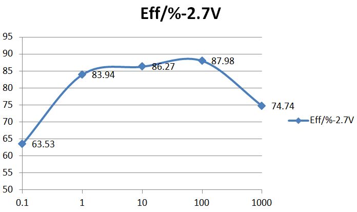

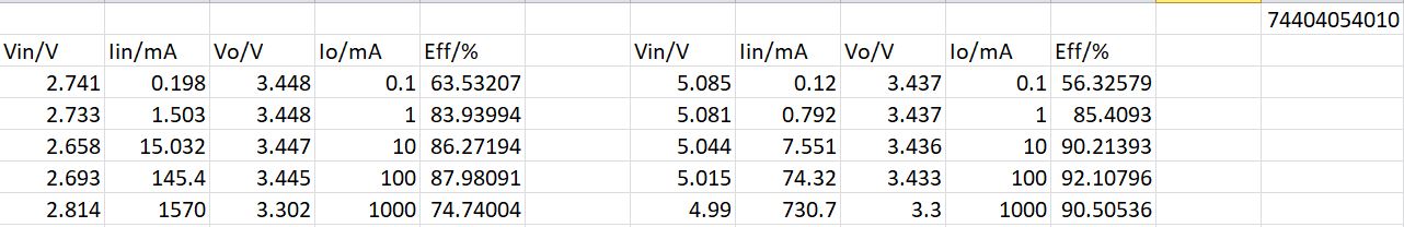

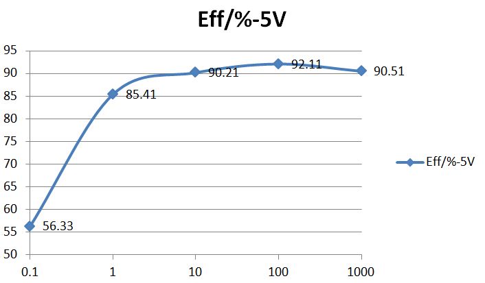

Dear team,
Do you have the efficiency of the following conditions?
VIN=2.7V/VOUT=3.3V 100uA~1A and
VIN=5V/VOUT=3.3V 100uA~1A
WEBENCH does not support this device.
