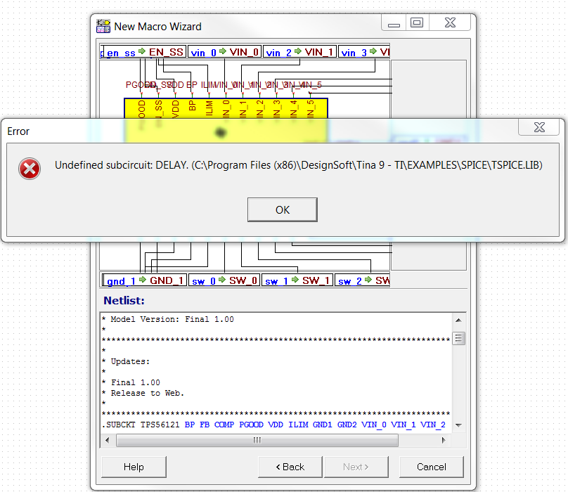

Hi
I am trying to simulate a dcdc TPS56121 buck converter circuit but I met a error on TINA and PSpice-for-TI. The error on TINA is "Undefined subcircuit: DELAY."
The error on PSpice is shown below

ERROR(ORPSIM-15461): Incorrect number of interface nodes for X_U1.X_U8_U11.
ERROR(ORPSIM-15461): Incorrect number of interface nodes for X_U1.X_U8_U12.
