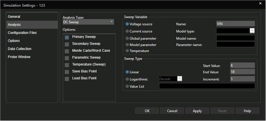

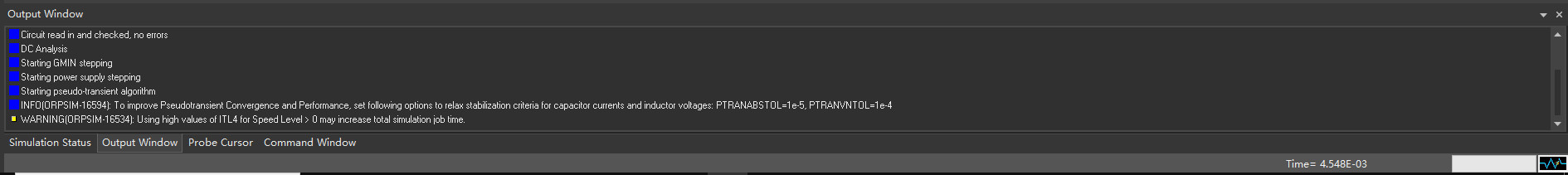

The Simulation Setting is as the picture shows.when i run the simulation,The command line window is shown,"WARNING(ORPSIM-16534):Using high values of ITL4 for Speed Level",and the progress bar is still zero present.I want to know how to use this model for simulation.

    Is the warning keeping the simulation from running? Have you tired lowering the PSPICE runtime variable ITL4 to see if this improves the run time of the simulation?
