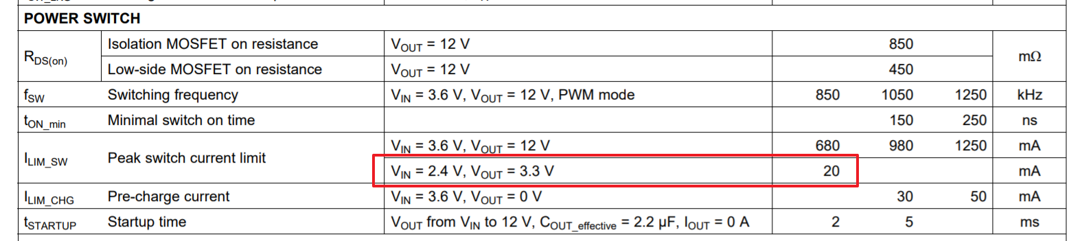

Hi, TI expert,
How should we understand the 20mA peak current in the datasheet as in the picture shot below?

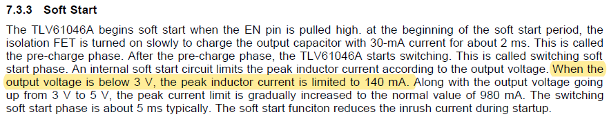

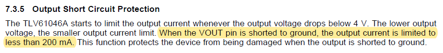

Hi Jayce:
That's related to the soft start and short protection function. You can check the details in datasheet.
If the Vout is higher than 5-6V, the current limit is back to normal value typically.
Hi Minqiu,
The current should be more than 140mA, rather than 20mA.

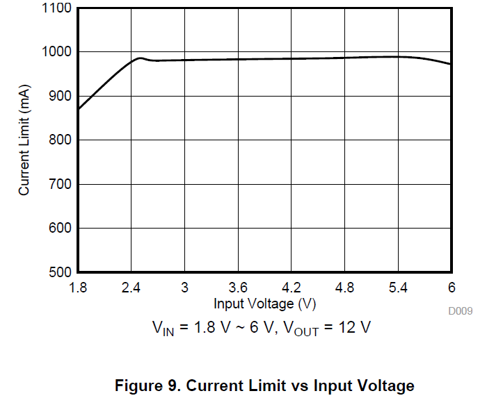

Why does the spec related to short protection? Input 2.4V and Output 3.3V are both in the recommended range of the working voltage.
Only Fig 9 show the relationship of the current limit and the input voltage, and cannot get the conclusion you give from this Figure.

Hi Jaycy:
140mA is a typical value, and the 20mA is the minimum value.
The current limitation increase after the Vout is high enough.
