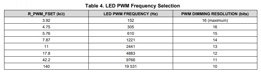

LP8863 datasheet is described about PWM_FSET resistor, what is the acceptable range of the R_PWM_FSET?
I found the other thread, it is described R_BST_FSET range is 1%.
Is R_PWM_FSET also 1% recommend?

Hi Satoshi,
Yes, your understanding is correct.

R_BST_FSET and R_PWM_FSET recommend value is E96 series by datasheet.
When should to use E24 series only, it is difficult to match 1% accuracy range.
Can E24 use R_BST_FSET and R_PWM_FSET resister?
If can, please let me know recommend value and range.

Hi Satoshi,
We only recommend 1% resistor. For other resistor, the device may identify the wrong selection of BST_FSET and PWM_FSET frequency.

When in the case of 4.75kΩ: 305Hz, please let me confirm about 4.7kΩ ±0.5% resistor can use or not.
(4.7kΩ ±0.5%: 4.6765kΩ~4.7235kΩ, 4.75kΩ ±1%: 4.7025kΩ~4.7975kΩ)
By the way, one of LP8863 changed 305Hz to 152Hz(3.92kΩ_typ) value is 4.21kΩ.
I think that resistor value mean below range, correct?
305Hz: 4.75kΩ ±1% = 4.7025kΩ~4.7975kΩ
152Hz: 3.92kΩ ±1% = 3.8808kΩ~3.9592kΩ
⇒3.9593kΩ ~ 4.7024kΩ: unknown range for 305Hz or 152Hz
If correct and if there any histogram for unknown range per parts, please let me know.

Hi Satoshi,
For this range, I would say the majority of device will select the correct frequency and the very small part of device may have a risk to select the wrong frequency.
