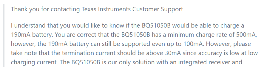

They told me that it was possible to go down to a value of 100mA for Ibulk and 30mA for Iterm (see the figure attached). So, I set the Ibulk=190mA and the Iterm to 30mA.

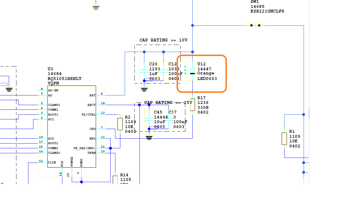

2) Ending phase: the LED which turns on only when the chip is in the recharge phase (see the image attached) does not turn off anymore if I leave the board under recharge, while before the modifications it turned off after the expected recharge time.

    2) Ending phase: the LED which turns on only when the chip is in the recharge phase (see the image attached) does not turn off anymore if I leave the board under recharge, while before the modifications it turned off after the expected recharge time.  -- Bill J - At Ending Phase (charge complete) the RX will send EPT01 packet (End Power Transfer Charge Complete) and the TX will turn off.  At this point the LED will go out, RECT voltage to 0V. The charge current will go to 0mA, can check voltage at ILIM pin.  Current out of pin is proportional to output current, ratio is 1 to 360 and should be 0.
    The TX will need to power up the RX and check if it needs more power, this power up is often a short ping at 5 sec rate.
