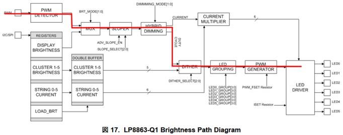

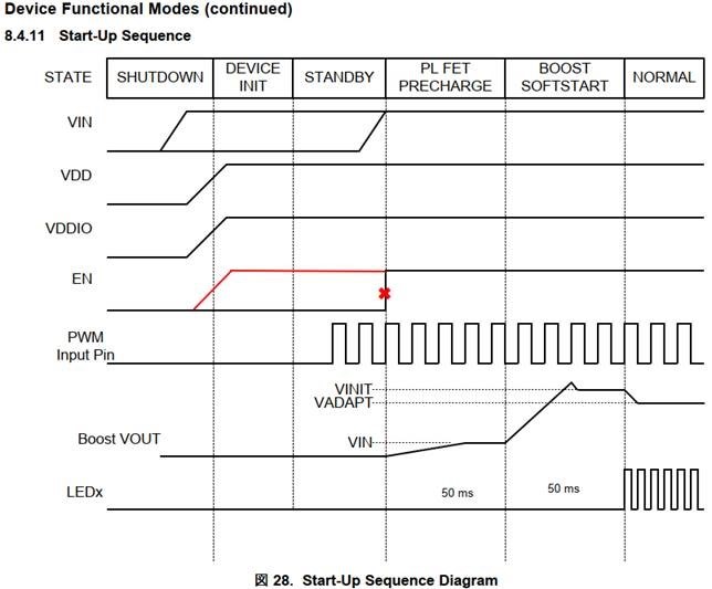

Please let me know about EN pin setting below;
・When EN control is unused, is EN pin pullup to VDD no problem?
・If EN to VDD no problem, is below condition on default register setting not to lighting?
 IFSEL pin: Low (SPI)
 SDO_PWM pin: High
 EN pin: High
 ⇒When no problem (not to lighting), please let me know about which default register is affecting.
I guess that above condition occur to SDO_PWM pin valid PWM input because default BL_MODE Register is "0h = Brightness controlled by PWM Input", but power up timing is SDO_PWM pin left high level.
Is these understand correct?
