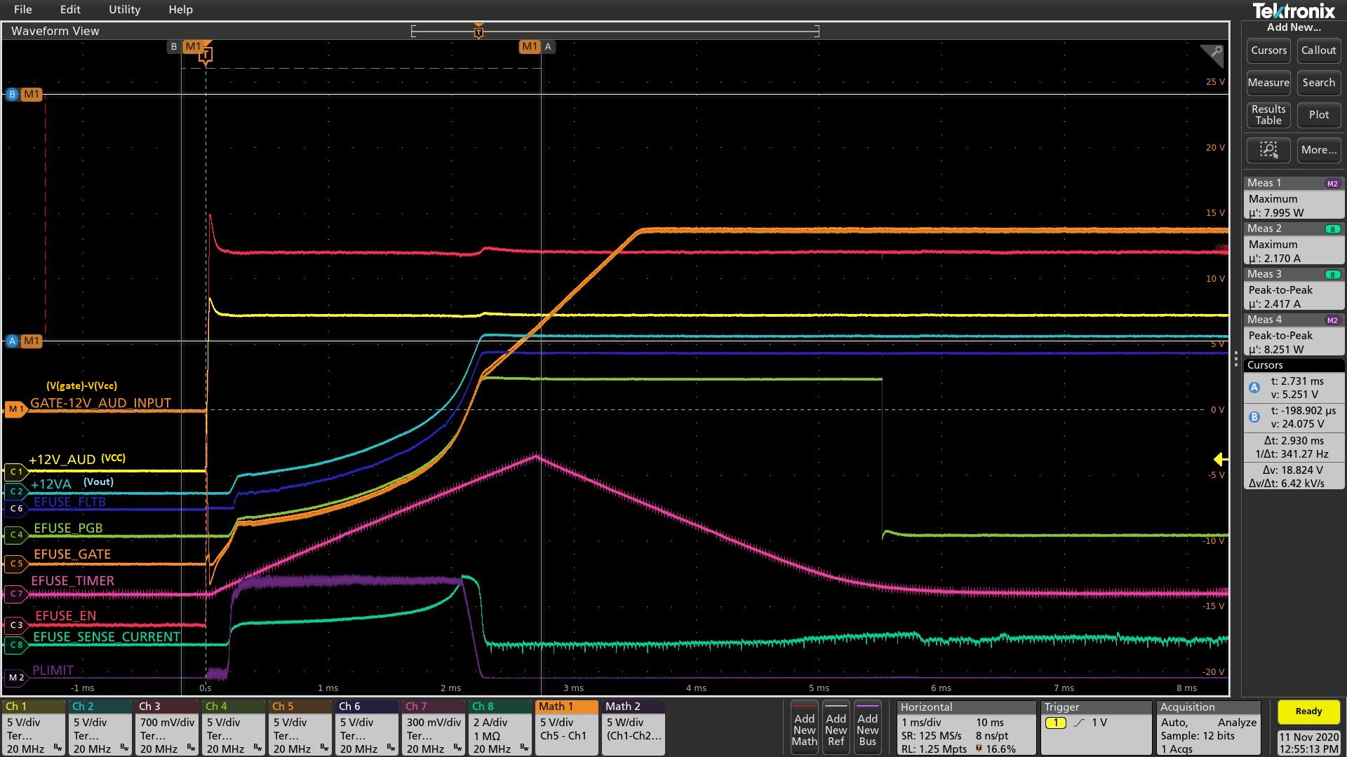

  • Hi Praveen,
    We have done few captures for earlier design.
    SET resister
    61.9
    Sense resister
    5
    mΩ
    IMON resister
    1.27
    kΩ
    PROG resister
    37.4
    kΩ
    Timer Capacitor
    47
    nF
     Below are the limits which we are getting from values chosen
    Current Limit
    6.5799
    A
    Power Limit
    21.992
    W
    Actual Fault time of our design
    6.345
    mS
    I see maximum power limit during inrush is always ~7.8W (which is the minimum PLIM mentioned in excel)
    We have configured PLIM to ~22W using PROG resister (37.4k), why PLIM is reduced to ~7.8W in inrush?
    The design looks good to me with the values shared in the design calculator. The actual inrush current is around 2 A which is as per your requirement of <2.1A.
    What is the Gate capacitance on the  board for the condition when you have tested and shared the waveforms ? Please share the design calculator with filled in parameters as per your actual test conditions.

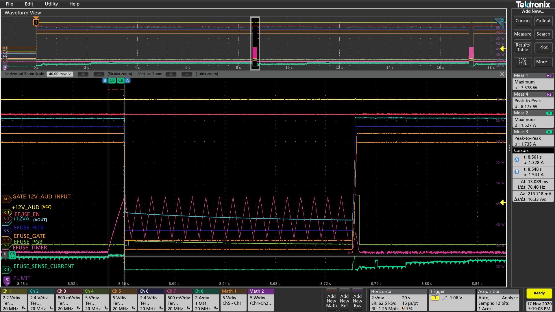

  • Hi Praveen,
    We have tested with new values also.
    SET resister 51.1Ω
    Sense resister 10mΩ
    IMON resister 1.37kΩ
    PROG resister 31.6kΩ
    Timer Capacitor 56nF
    I am hitting current limit at ~1.34A and Vout is going down for 16 cycles and rising again.
    putting a snapshot of the capture.
    I have some doubts on why current limit is hitting at different point than programmed. I will get myself cleared and get back to you.
    About query on gate capacitance, we have an option of 4.7nF on design but currently we have de-populated it for testing purposes. Once all the values are set, i want to populate gate capacitance.
    What are the test conditions at which you have captured the waveforms ? Is it during startup or over load conditions ?
    With the below configuration values, the Actual I-limit value = 2.5 A and the Actual power limit for Rprog = 9.9 W.

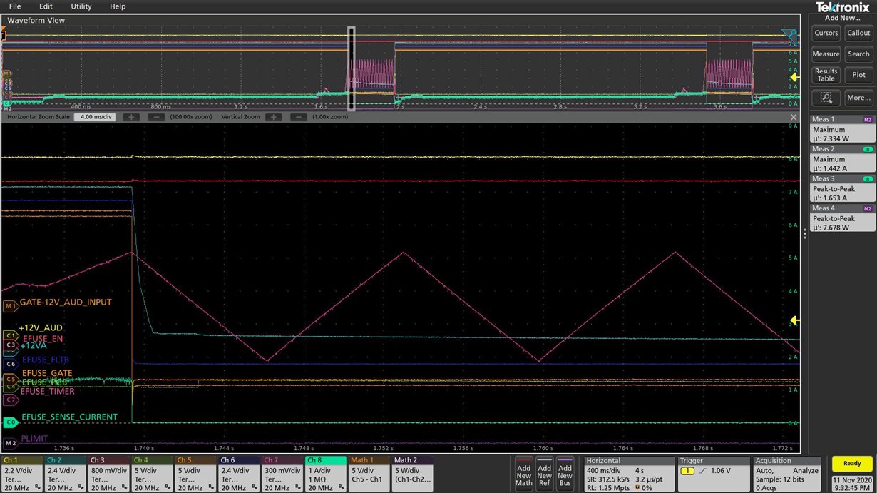

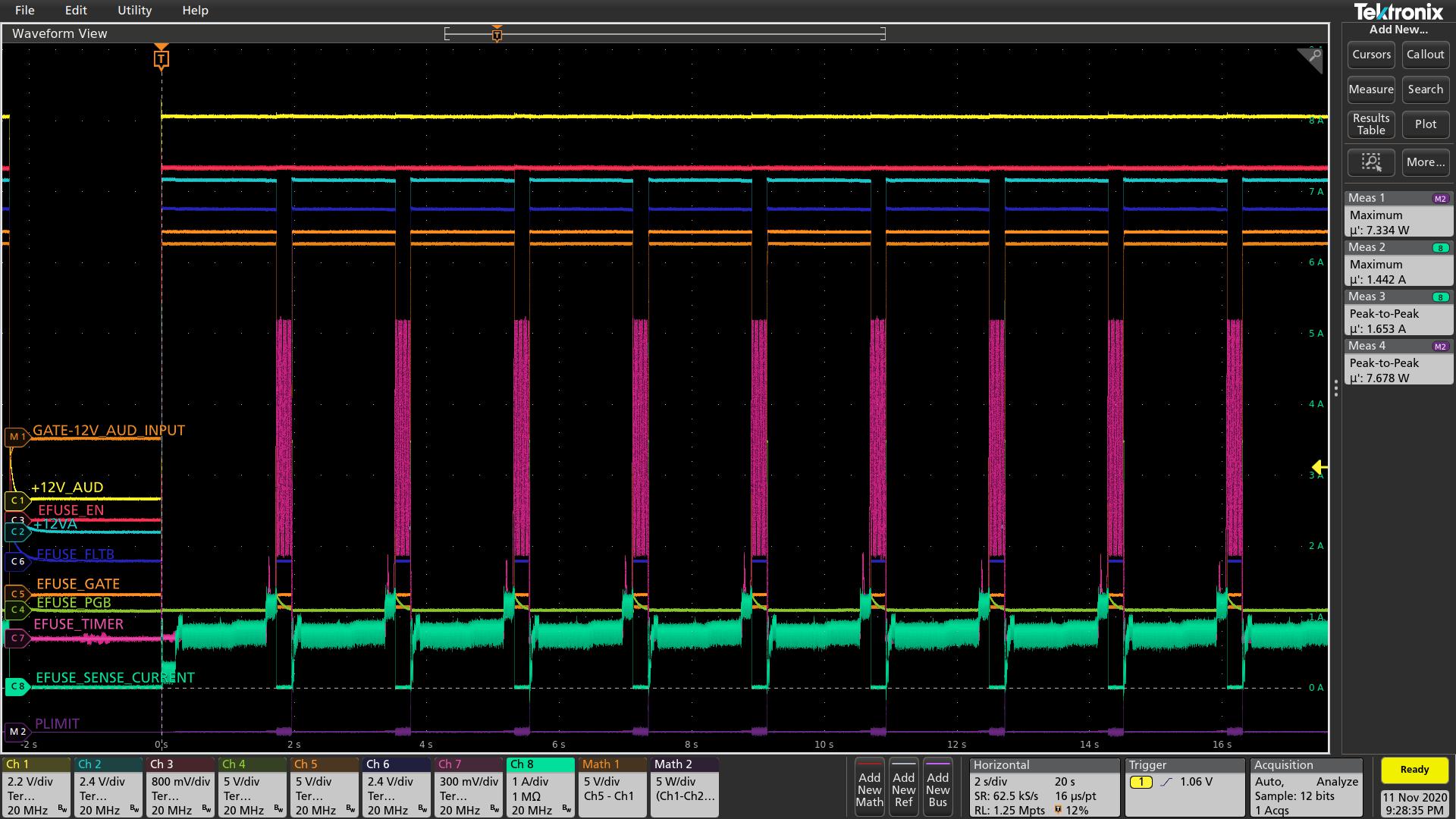

  • Hi Praveen,
    Regarding the measurement conditions,
    First capture Trigger point shows the Power ON, after Power ON ~2seconds there is a current rise of ~1.34A where i believe TPS24751 is sensing current limit and starting timer to rise and after timer rised to 1.35V Output,Gate all are driven LOW and after 16 cycles they are restarted.
    same process going on.
    The design values which above captures(PLIM=22W,ILIM=2.5A) were taken are with
    • SET resister 51.1Ω
    • Sense resister 10mΩ
    • IMON resister 1.37kΩ
    • PROG resister 14.3kΩ
    • Timer Capacitor 56nF
    • No dvt/dt control
    What we are seeing is even though current limit is configured for ~2.5A, actually current limit is triggering (Timer voltage is raising) @ 1.34A.
    We have tested for another configuration: PLIM = 22W, ILIM = 2.7A;
    • IMON resister 1.27kΩ
    • PROG resister 15.4kΩ
    • No dvt/dt control
    Here, same behavior is happening @ ~1.54A (instead of 1.34A as for 2.5A ILIM case as above).
    attaching capture for the same.

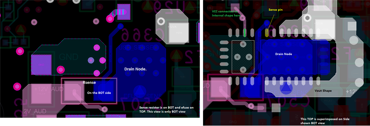

  • Hi Praveen,
    These values are same as what we took.
    1. Can we use Timer capacitor as 56nF?
    Below is the layout, I am not sure how much it will be clear.
    In the Layout Sense resister is placed on the BOTTOM side and TPS24751 is placed on TOP Side.
    In the image shared, Left side Part Only BOTTOM layer is shown and then in the right part TOP portion is overlaid on BOTTOM view.
    I would recommend you to try the following,
    • Use the same configuration, IC and Components on TI EVM and test the circuit on EVM.
      • This will tell us if there is an issue with the IC/ components or your layout
    • Use resistive load while testing current limit behavior of IC. Using e-Load, especially in CC mode can cause problems
    • Replace the IC on your board with a new IC and test the same.

    From the layout side, i see our layout different from EVM layout -> But its difficult to me to access the % of error from deviation in the layout.
    One more thing " In Layout Rsense shown as single resister, because we don't have 10mOhms in hand, we connected 2 no's of 5 mohms resisters in series with common pad in air other 2 pads to Board"
    Do you see directly any evident problems with our layout from your experience with TPS2475x,
    or
    Previously this kind of layout also given good results.
    Currently, i didn't used any e-load/Resistive load. Board load varies from LOW to MEDIUM and then to MAX from BOOT-UP.
    Currently in from BOOT-UP until load is "LOW" no current limit is hitting TPS24751 behaves correctly, But once Load reaches to MEDIUM, current limit is hitting.
    We will test with 2.7A configuration in another board to confirm(This will clear if we have assembly issues on board (unlikely checked multiple times) or wrong values on board).
    Thanks for your response. I will get back to you on this within a couple of days.

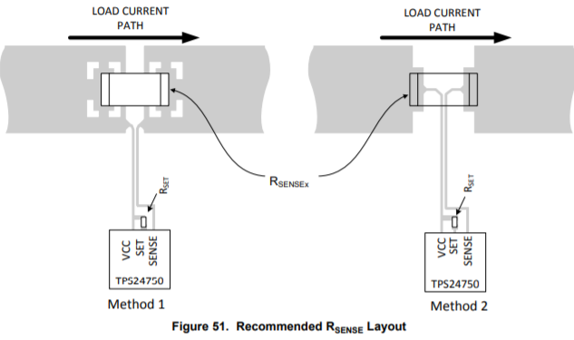

    Yes, it is very difficult to estimate the %error in current limit from the layout.
    Soldering 2 x 5 mohms resistances in series with the common pad lifted up may not be a good practice and the amount  of solder used also contributes to the resistance and hence increases the error.
    The tapping point of sense lines tapped from the sense resistor need to be in such a way that the sense lines are not in the current carrying path to avoid error.
