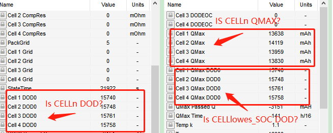

Hello, I have two questions about the external balance of BQ40Z50:
1. The balance is calculated based on dQ, dQ = CellnDOD – CellLOWEST_SOC DOD × CellnQMax (mAh), which are the only parameters in BQstudio.
2. What is the difference between dQ and open balance.
