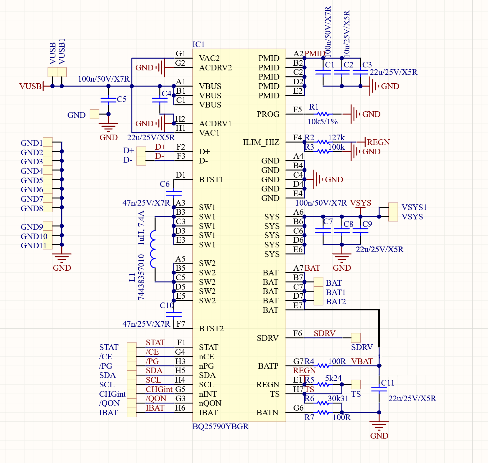

I've a custom development board with the BQ25790 on it. I want to use it to charge a 3-cell battery from the 5V source. For now it is connected in the VBUS only mode. It is also important that automatic recharge is working.
MY GOAL
So what I want is when VBUS is applied, charging should start and finish when VBAT is 12600mV. Then when VBAT falls bellow 11800mV the charging should restart automatically without any pin toggle or register read/write. Don't know it the termination is needed or if it is connected with the automatic recharge process (didn't find that info in the datasheet)...
BQ25790 is initialized at the boot in the "bq25790_init" function. Then its status is displayed every second inthe function "bq25790_monitor". When INT pin of the BQ25790 is pulled low the "bq25790_on_int_low" is called and then the flag registers (REG22 - REG27) are read in the "bq25790_process" function.
SO WHAT IS THE PROBLEM
At that point the battery voltage is around 12V and VBUS is applied, charging cycle started and status line from charger is:
VBAT: 11954mV, IBAT: 295mA, CHG STATUS: 3, BAT PRESENT: 1, S0: 0x89, S1: 0x63, S2: 0x01, S3: 0x00, S4: 0x00, F0: 0x00, F1: 0x00
So this looks normal, current flows in the battery and charging mode is "CC charging" (status 3 from the datasheet). Then when battery voltage increases, charging status changes to "CV charging" (status 4) and the IBAT current decreases. If the load is connected to the VSYS at this time, battery voltage drops and charging status changes back to "CC charging" and the IBAT register value increases, which is normal operation.

  • Hi Ales,
    Based on your status and fault registers, the charger appears to be running in DPM/supplement mode which means that the input power supply is not strong enough to both power the load at SYS and provide the total charge current.  When in DPM, the charger does not terminate and so cannot recharge.  I have some questions:
    What is your load on SYS?  Is the voltage at BAT pin greater than or less at SYS pin?  If V(BAT) > V(SYS) then the charger is in supplement mode.
    Is your IBAT measurement using the charger's ADC?  If so, are you accounting for the two's complement which will report negative current if there is no VBUS or if in deep supplement mode?
    At the moment, I can't explain why power cycling the charger results it in starting to charge again.
    Jeff
  • Hi Jeff.
    I see... Somehow the chg_status0 register wasn't updating during the time when screenshot was taken... I fixed this and now the chg_status0 is 0x09 and not 0x89 as before. Also I cheched the VSYS voltage and it'is the same as VBAT.
    The current measurement that is used are the 2 bytes read from the bq25790_ibat_adc register (0x33). So the 0x33 and 0x34 registers and then stored in 16-bit unsigned integer. So a ray value from the BQ's register is displayed...
    The problem occurs even if SYS is totally unloaded. So charger is in the CV-charging state, some current flows in the battery and then at some point status changes to CC-charging state and no curent flows in the battery (checked with the A-meter in series with the battery)... Then even when voltage falls, charging doesn't start automatically... Then again if the bq25790_chg_ctrl4.force_vindpm_det bit is set, charging is started again...

    Schematic
    Aleš Zupanc, firmware developer
    PoLabs d.o.o. 1000 Ljubljana, Slovenia
  • Hi Ales,
    Unfortunately, your schematic did not come through.  Can you repost?
    Regarding the two's complement code, I am hardware person, not software.  I will forward to someone else and ask them to review.
    Regarding your reads, you are not reading all of the Status and Fault registers. If charging has stopped, there should be a fault generated when it stops. They run from REG0x1B to REG0x27.  If you cannot read those, then I will need oscilloscope plots of the waveforms, SYS, BAT, VBUS, SW.
    Jeff
  • Reposting the schematic again here.

  • Hi Ales,
    I do not see an obvious error with the schematic.
