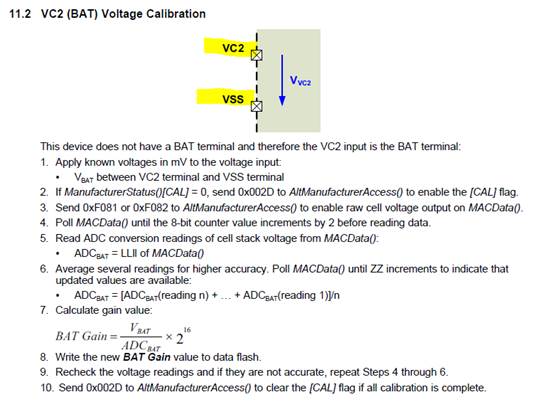

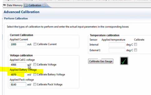

  • What is the correct setting for [Applied Battery Voltage] ?
    The video on the TI website and the calibration of the Technical-Reference are different.
     ㅡ  TI website   :   [Applied Battery Voltage]  =  1-Cell Voltage
    ㅡ  Technical-Reference  :  [Applied Battery Voltage]  =  2-Cell Voltage
