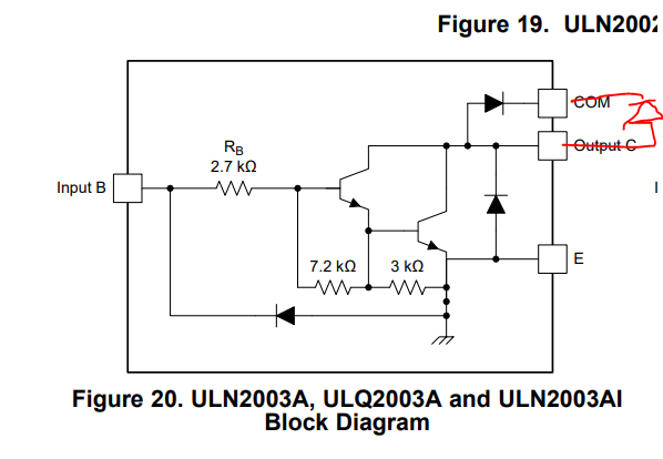

A customer is asking if is it necessary to connect isolation diodes on the input or output of this part? Please the schematics below. Thanks

Thank you for sharing. I'm not sure where anode and cathode are but i am assuming as below photos.
Typically you do not need to add any form supplementary diode from output to COM as it is redudant to the internal clamping diode.
However, it will not cause any issue/harm and could even be beneficial as additional protection if are driving very inductive loads by shunting the extra current outside of the IC.
This shunting effect will be most effective if you choose a diode with low Forward voltage, e.g. schottky, as it will conduct earlier than internal diode. If that is your goal then this is a thing where you could even just have a DNP footprint just in case. If you are not driving inductive loads there is no point to use the diode.

Honestly even for inductive load / something like driving solenoid or motor, you most likely dont need to add it as the internal clamp diode is sufficient to protect against inductive voltagae spikes on the collector.

Hello, our question is in regards to isolation diodes, not clamping diodes. Sorry for the misunderstanding.
Revised question: Are any of the external diodes necessary when configuring the ULN2003A as shown in the attached (revised) schematic?

Those external diodes are not required and I have personally not seen them used. My idea is they would just burn power without any benefits.
Is there a particular reason you would want to add them?

Hello, our primary concern was in regards to any unwanted feedback on I2 when I1 is high or on I1 when I2 is high with O1 and O2 tied together. Simple enough to test on a breadboard, we just don’t have any samples in stock at the moment.

Thanks for explaining the setup. I do not expect any issue with that setup, don't think you need to add diodes.
If you get a chance to test it, could you report back here if you have issues and let me know your result?
