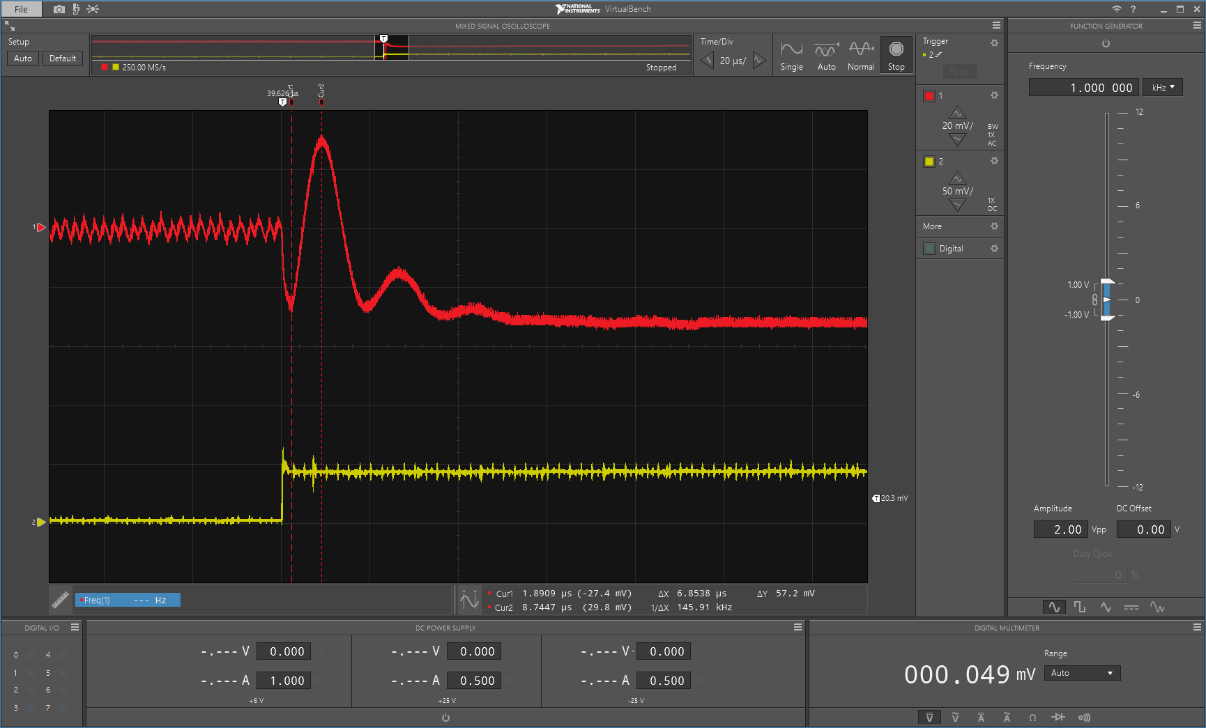

I have tried different Cff to improve control loop phase margin, but it seems there is no much room to make improvement by just change Cff values. I have read and followed the TI application note SLVA289B to calculate the Cff value base on the measurement on the load step response. The calculated Cff about 68pF. I have tried different values at the range of  47pF ~ 330pF. The best one ( in terms of  phase margin) is with Cff = 82pF. please see the attached scope shot for the step response with the load change from 100mA  to 400mA. Based on the step response waveform, the phase margin is about 30 degree, which is still smaller than  40 degree requirement for unconditional stable of control loop.

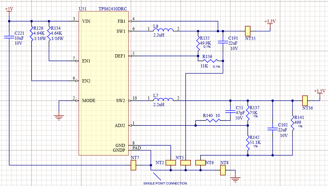

circuits description: Our design is using the converter 2 of a TPS62410 to generate 1.5V. A 75k Ohm and 51.1k ohm resistors are used as voltage divide to set out voltage. A 82pF feed forward capacitor is use, which is parallel to the 75k resistor. a 2.2uH inductor is used for this buck converter and a 22uF ceramic capacitor is used as a Cout. Mode/Data pin is tied to ground. EN1 and EN2 are tied to +5V input voltage.  Cin is a  10uF ceramic cap.

    Before we go a detailed discussion, can you please provide the complete circuit diagram?
    Thank you.

  • Hi Excel,
    Thanks for the response. Please see the circuit schematics.  The step response scope shot that I got  in my previous message is with R140 = 0 ohm and C51 = 82pF.

  • Hello Jake,
    Thanks for sharing the schematic diagram, and it looks fine.

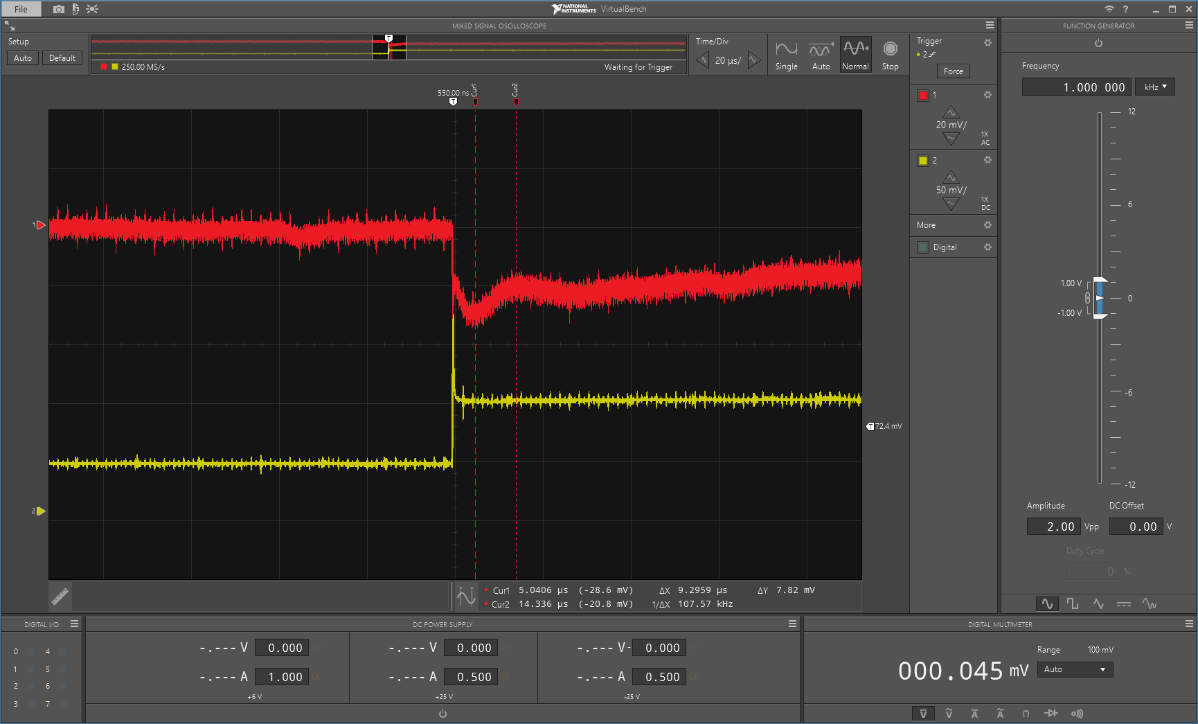

  • Actually we had similar thing ( Vout oscillation during transient load) on 3.3V rail as well, but a little bit better than that in 1.5 V rail. I have added an external Cff, which is 150pF, in parallel with R135  to knock down those oscillation. Can you confirm if it Is  a right approach?
    We do have additional 11 capacitors on the 1.5V rail close to our load device ( about 6.4uF in total).  They are listed below:
    1.  0.1uF    X 7
    2.  1nF       X 2
    3.  1uF       X 1
    4.  4.7uF     X 1

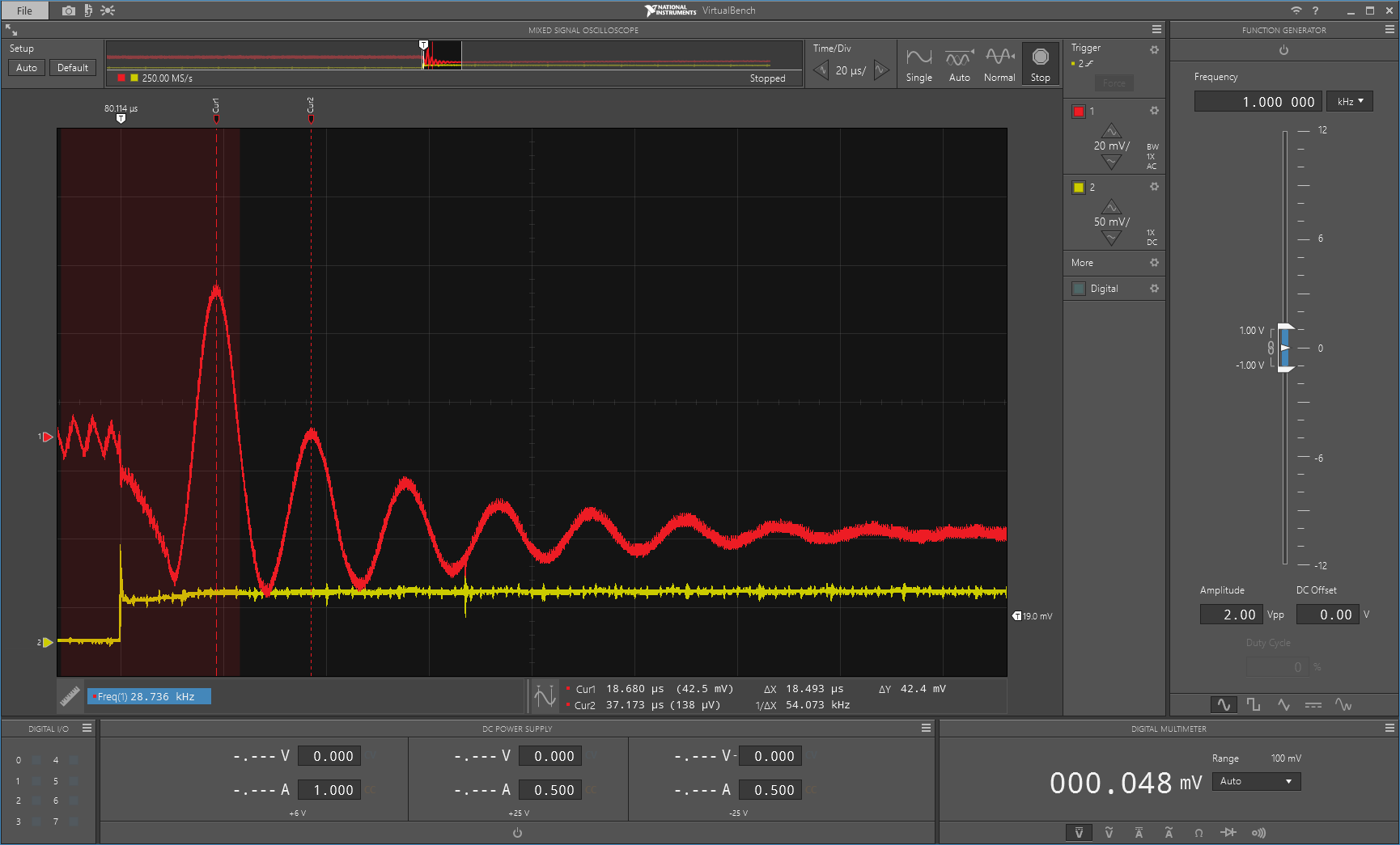

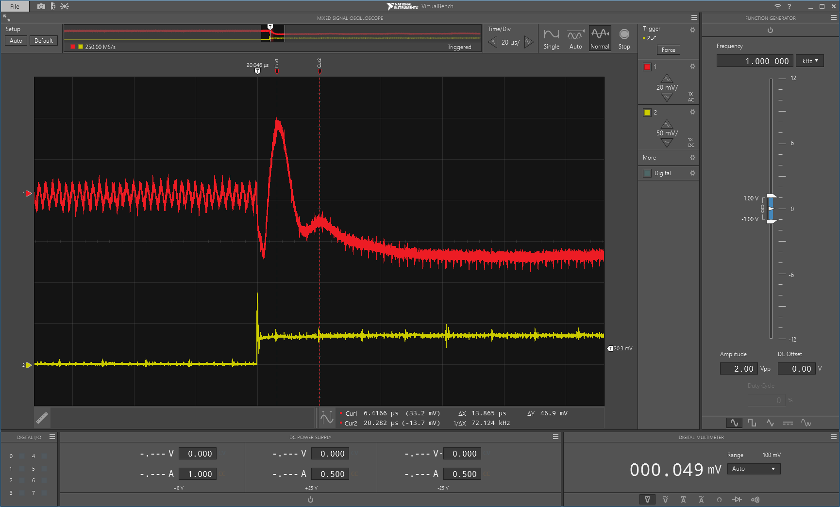

    Please see the scope shot on the transient response with C51 removed. I had measured the oscillation frequency. it is about 54khz. Based on this frequency and R137 and R142, the calculated the Cff  is about 61pF( based on the TI application note). I have tried 68pF, Then tried other values like 33pF, 47pF, 82pF, 100pF. The transient response with C51=68pF and C51=82pF are pretty close, but C51=82pF is a little bit better.

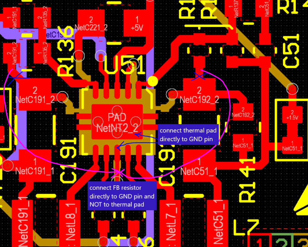

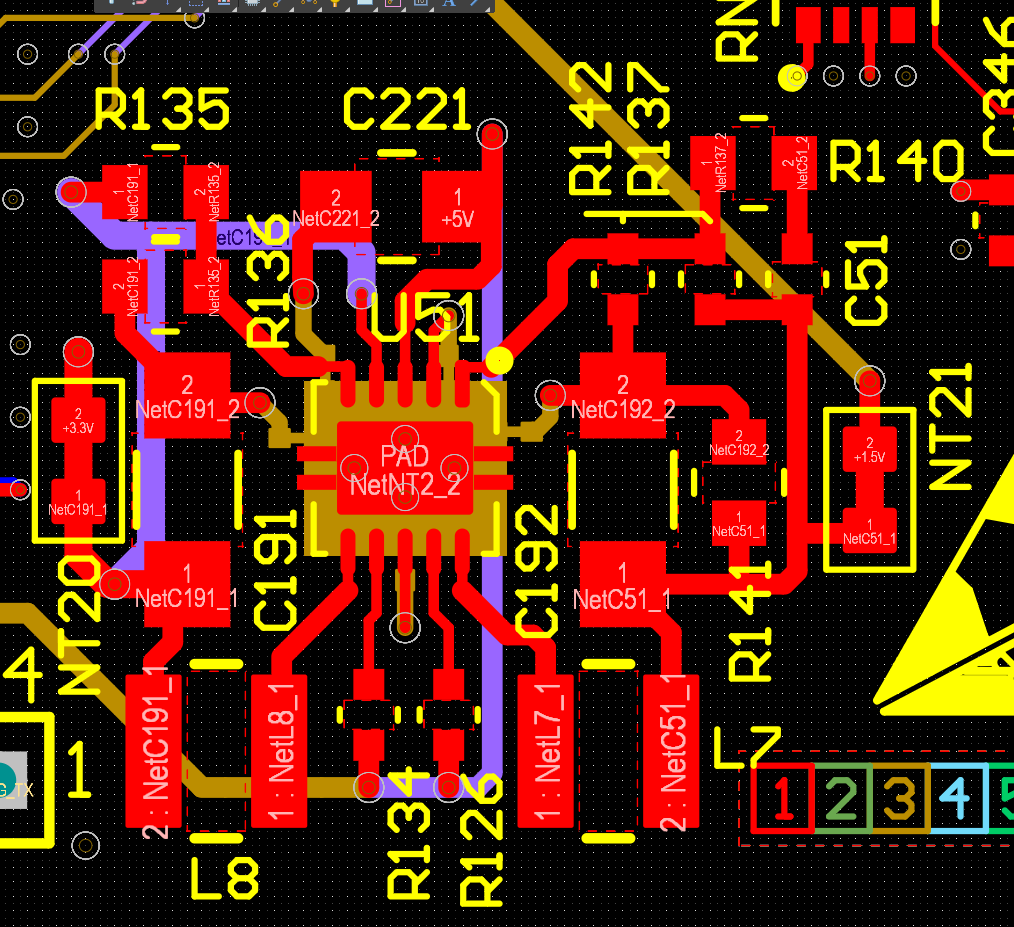

    Also please see  the PCB layout below.
  • Hi Jake,
    Thanks for sharing the waveform and layout.
    The transient response becomes worst with no Cff on 1.5V rail. Did you try to increase the Cff higher than 82pF? I'm expecting that the transient response will improve further. Once you achieve the desire transient response, please conduct bode plot measurement and the target is to have a phase margin equal to greater than 45 deg.
    For 3.3V rail, please conduct bode plot measurement as well (PM => 45 deg) to determine if the control is stable.
    With regards to PCB layout, please see comments below.
    1. thermal pad and GND pin should be connected directly on the top layer
    2. FB resistors should be connected directly to GND pin of the IC (see figure below)
    3. please follow the PCB layout reference indicated in the attached file

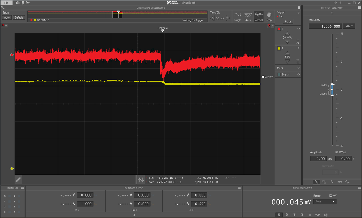

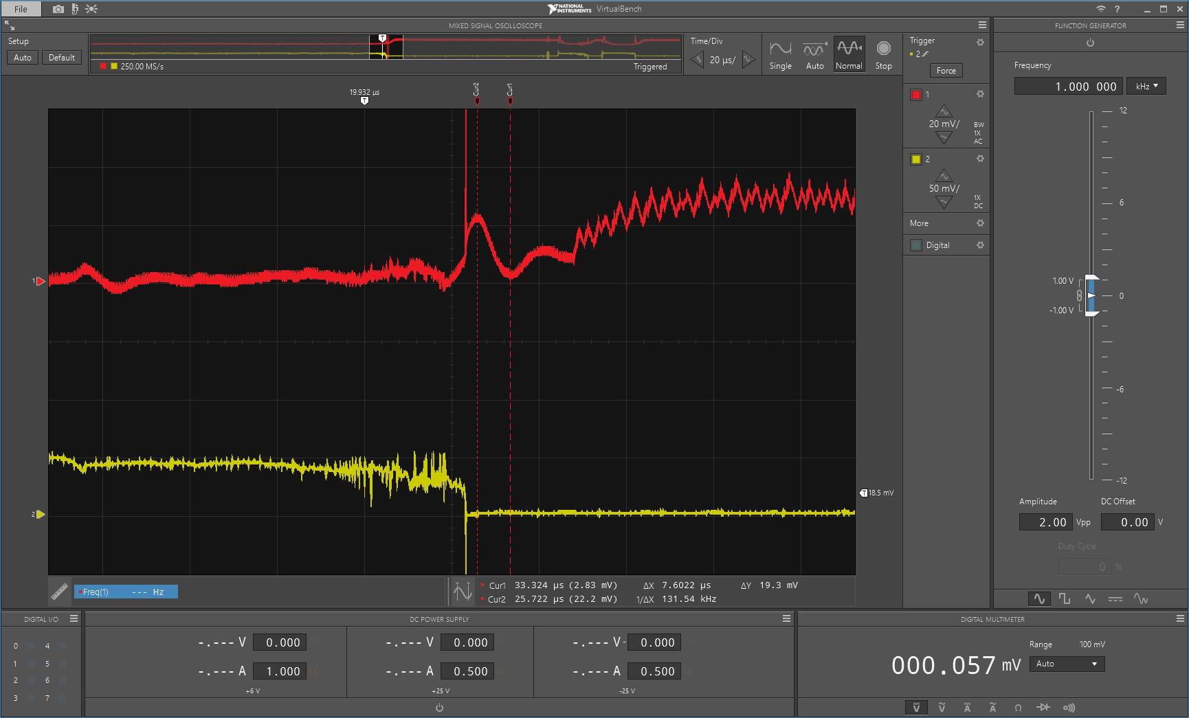

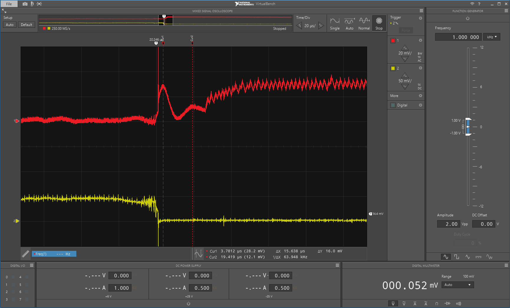

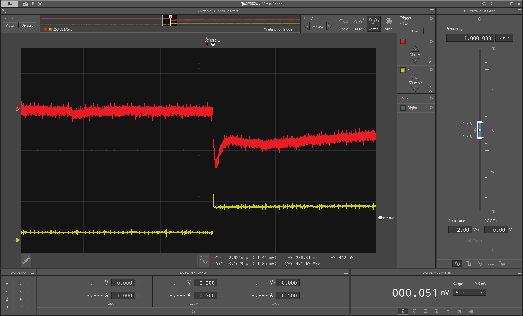

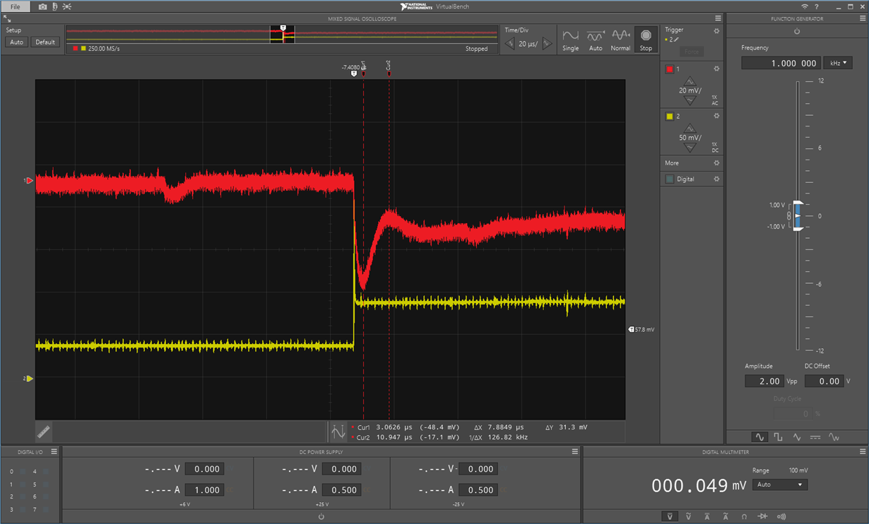

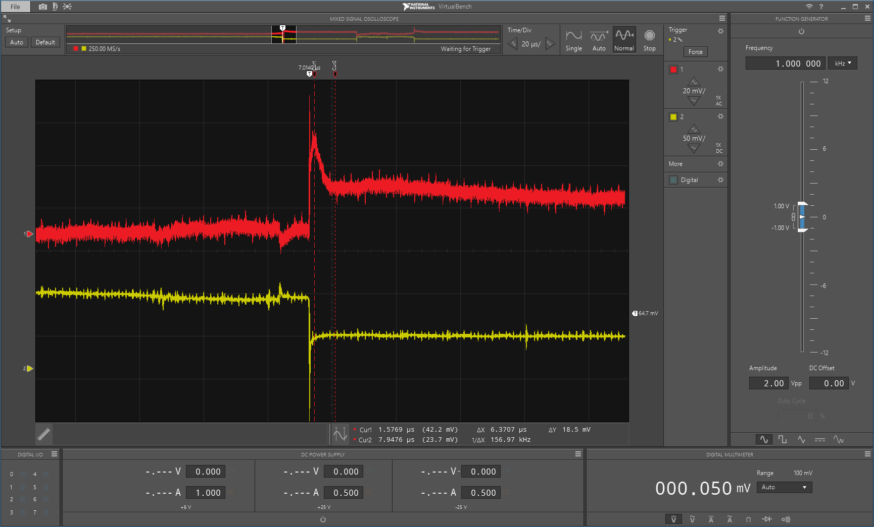

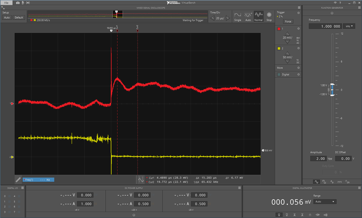

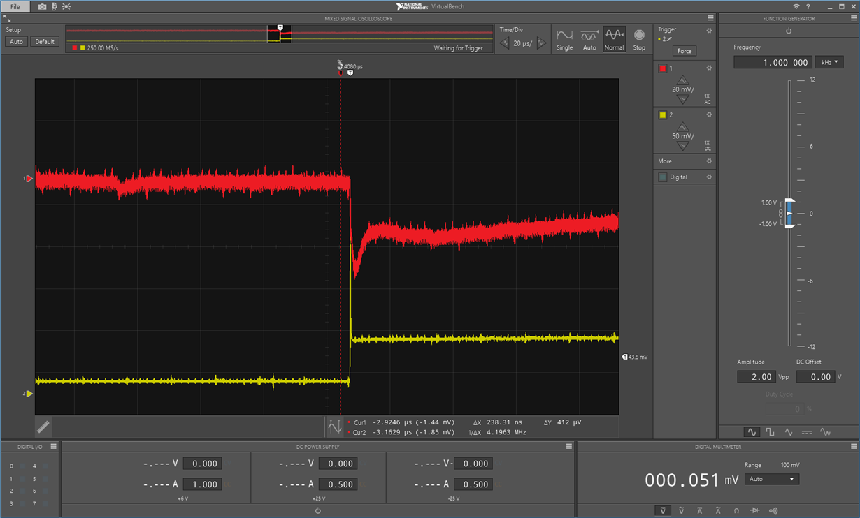

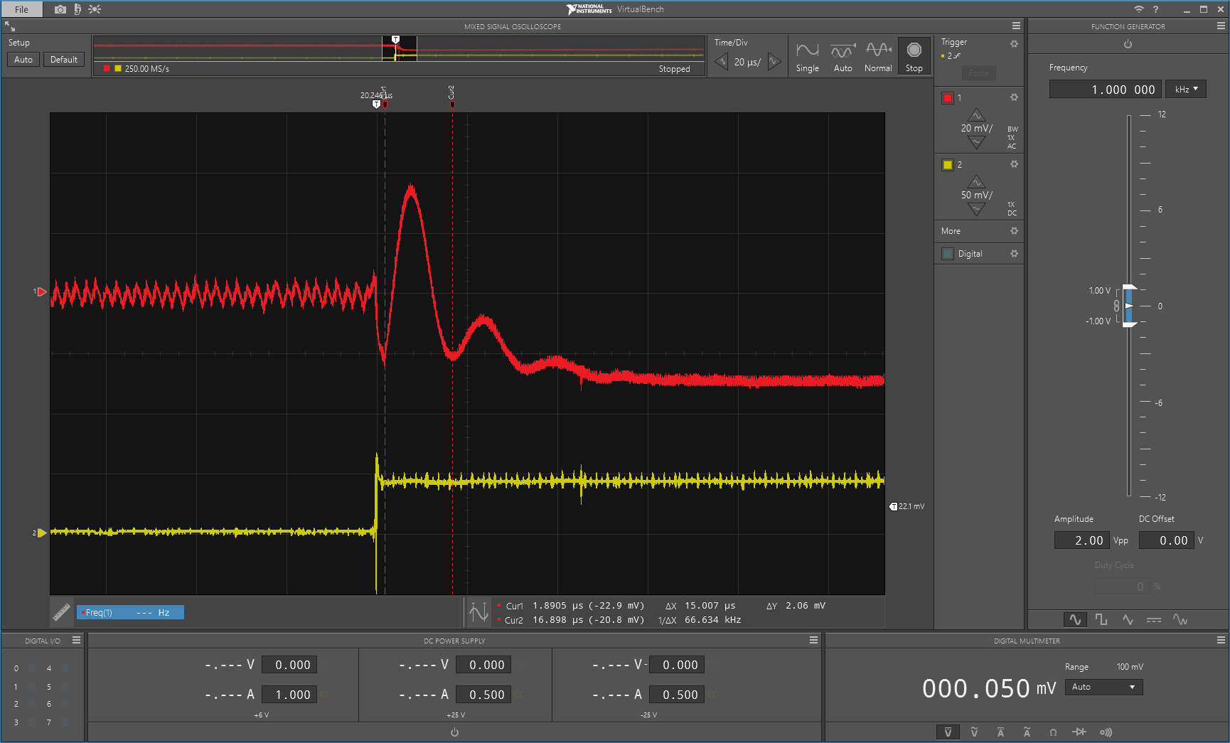

    In terms of the transient responses with different capacitance of C51, I had tried 47pF, 68pF, 82pF, 100pF, 120pF, 150pF, 330pF. Non of them is good enough. relatively the best one is with 82pF. Here are the two scope shots with C51=150pF,

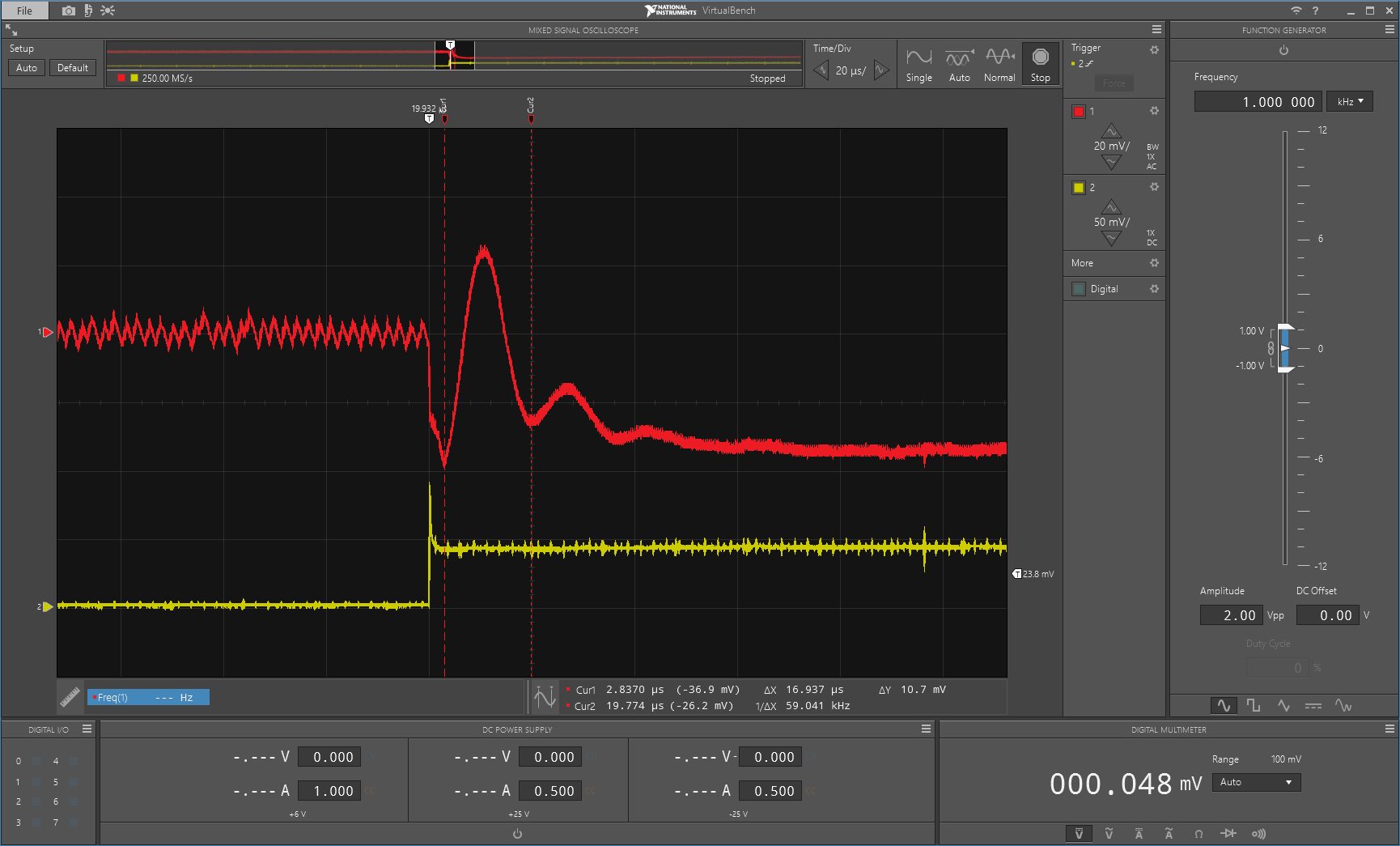

  • Here are two  the scope shots with C51= 330pF.

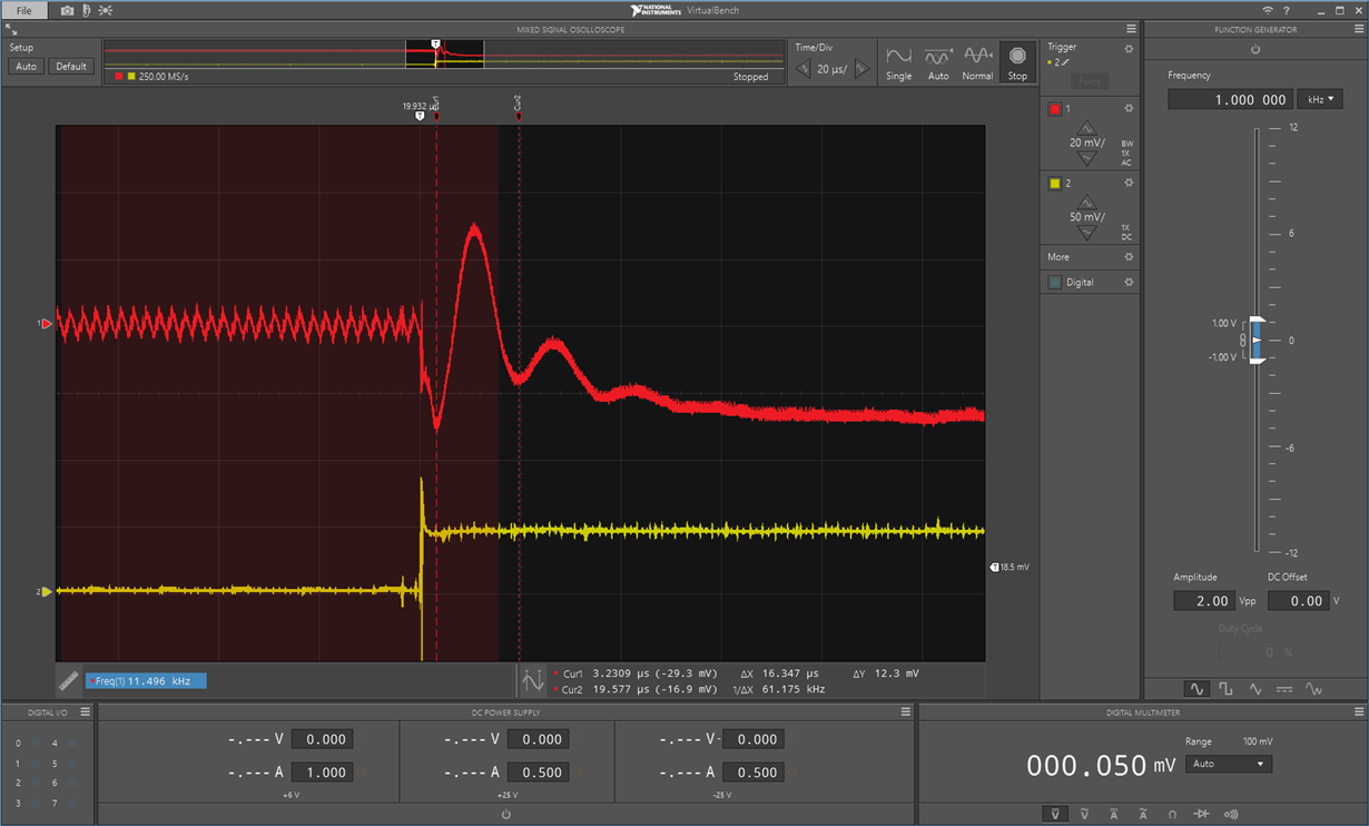

  • Here are two scope shots with C51= 100pF
  • Since it is getting worse when C51 is  330pF, I did not increase the value further.
    Jake

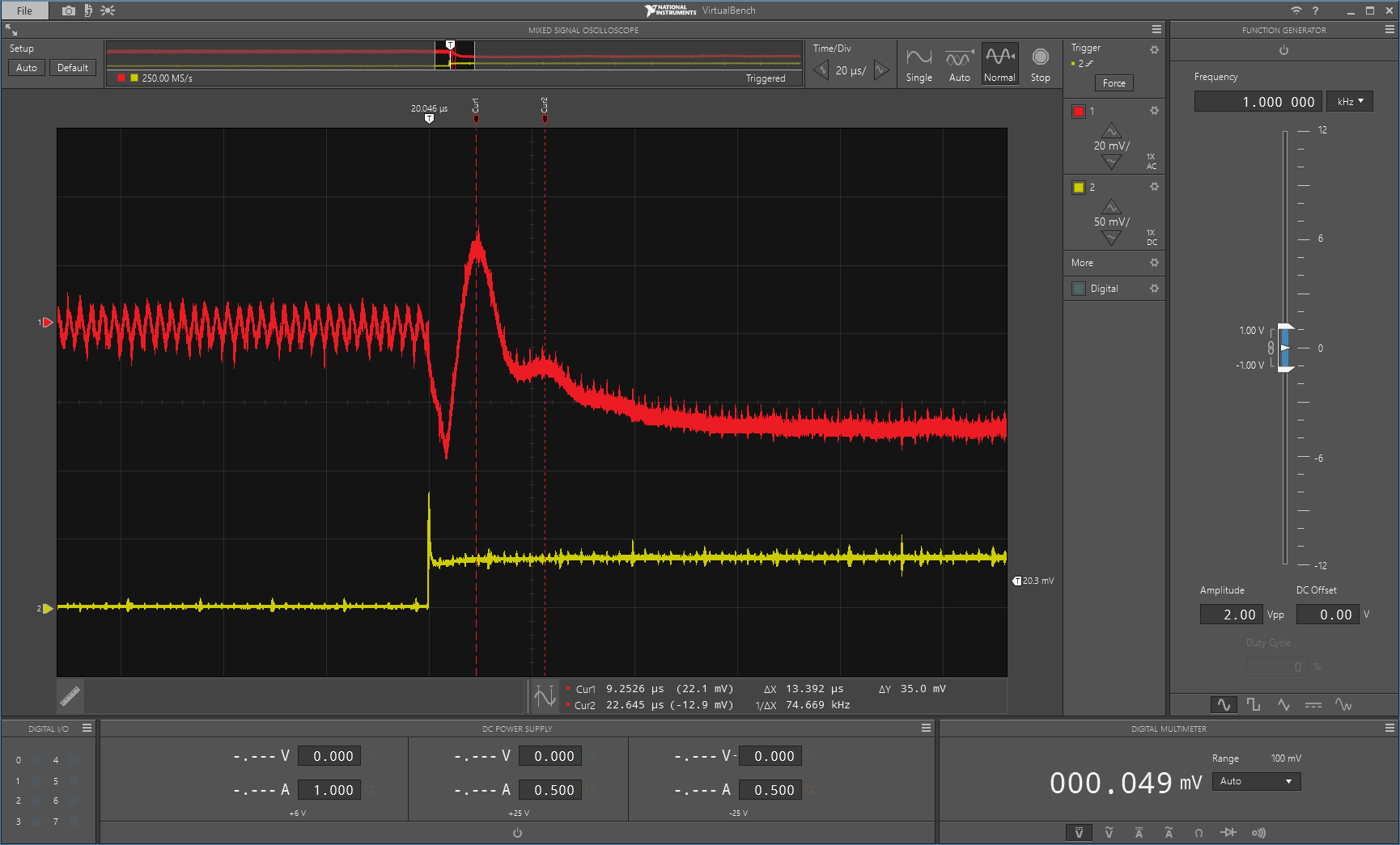

  • Here are two scope shots of  the transient response with C51=120pF.

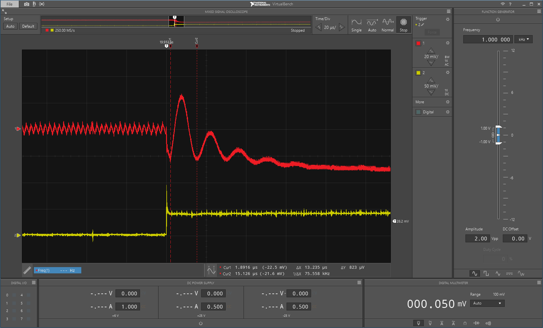

  • I also have scope shots for C51= 120pF.
  • Hello Jake,
    Thanks for sharing the waveforms. I agree it looks like that increasing the Cff further does not improve the transient response.

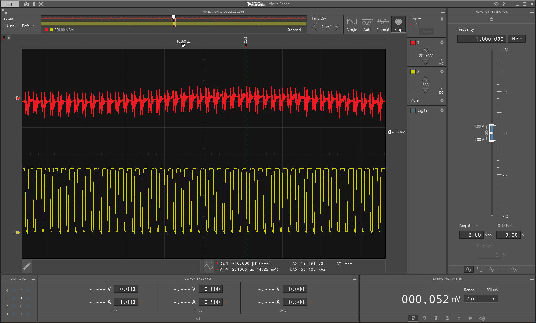

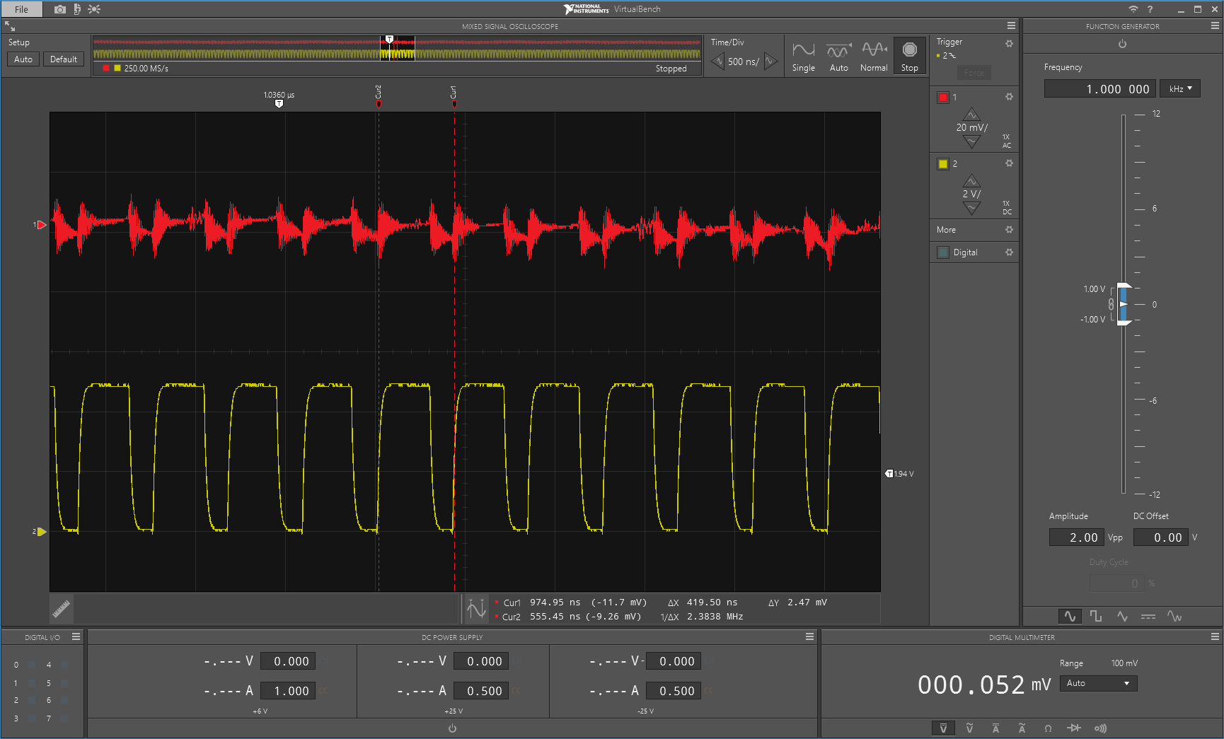

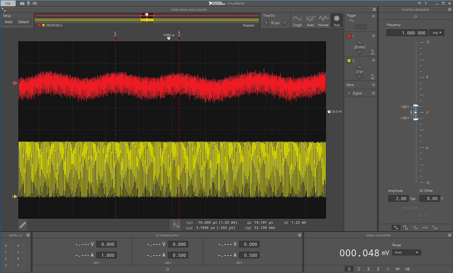

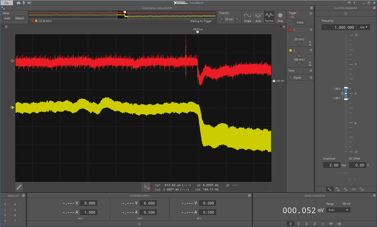

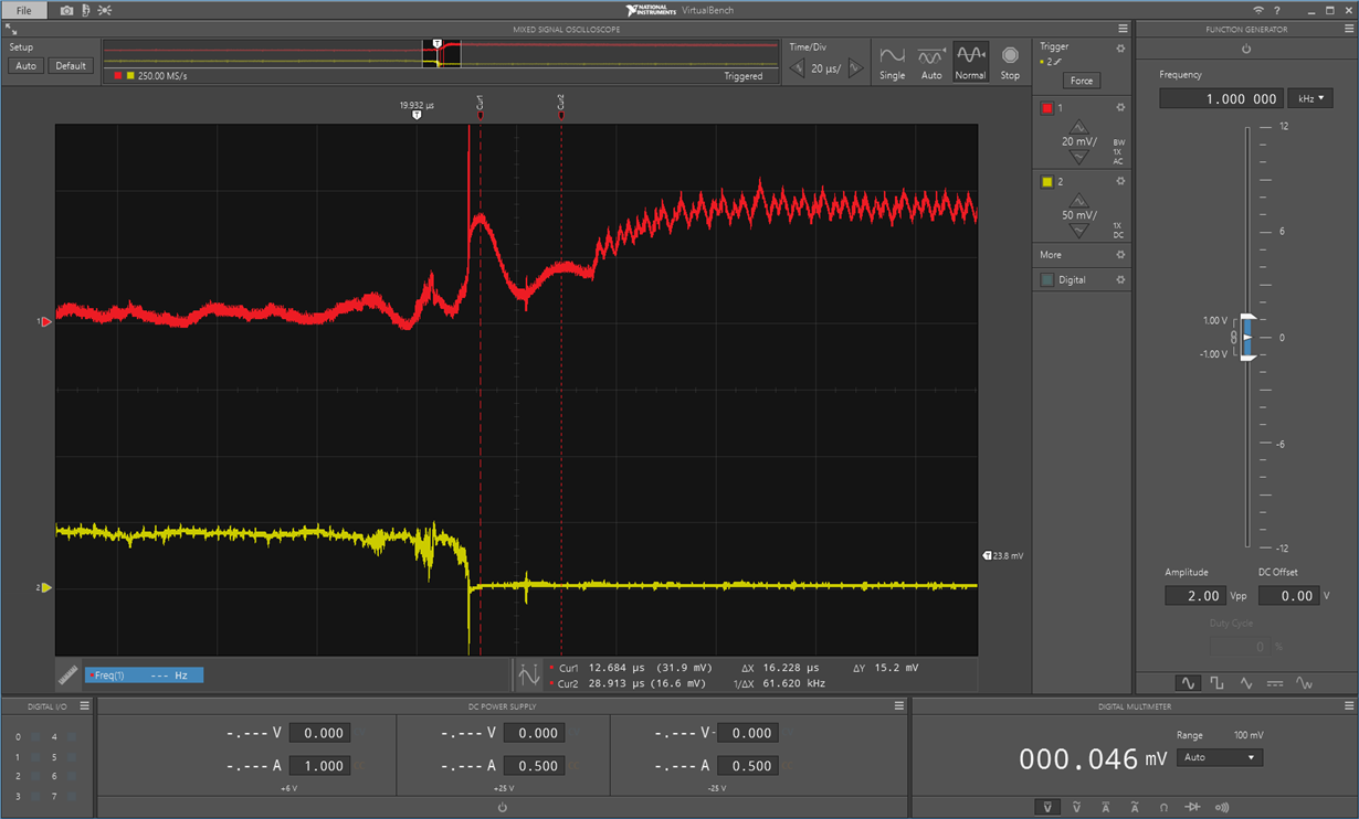

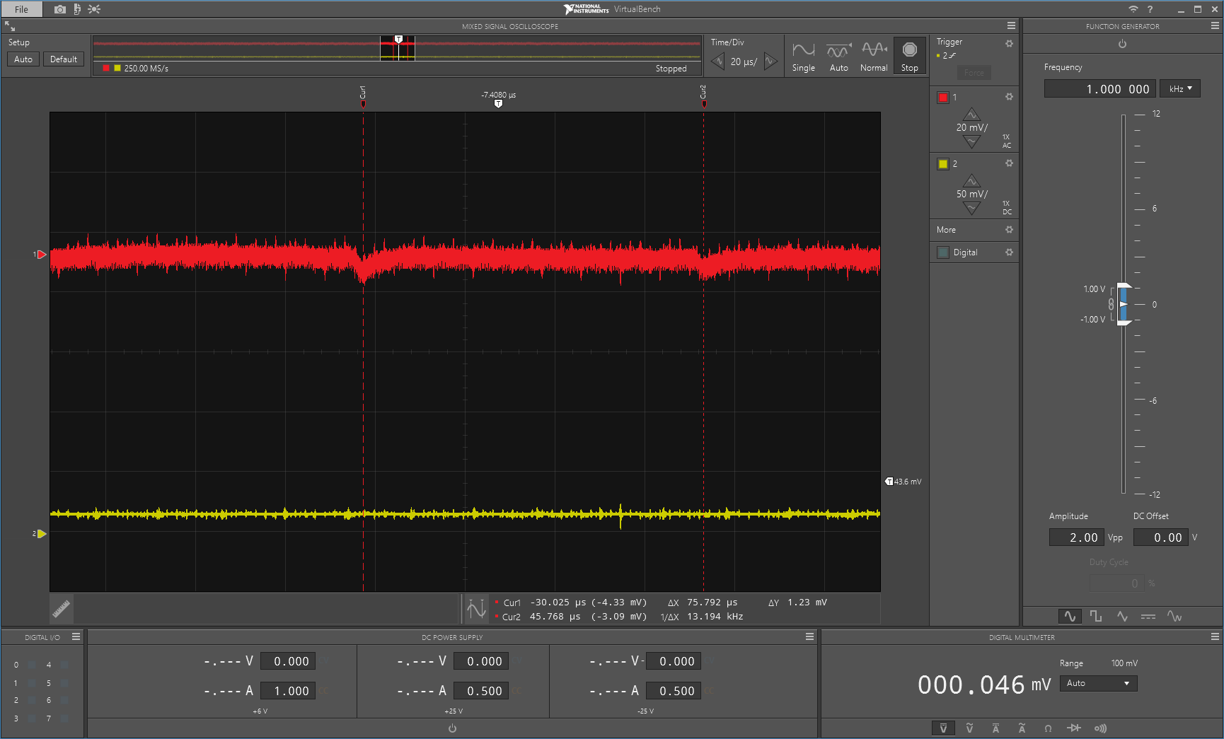

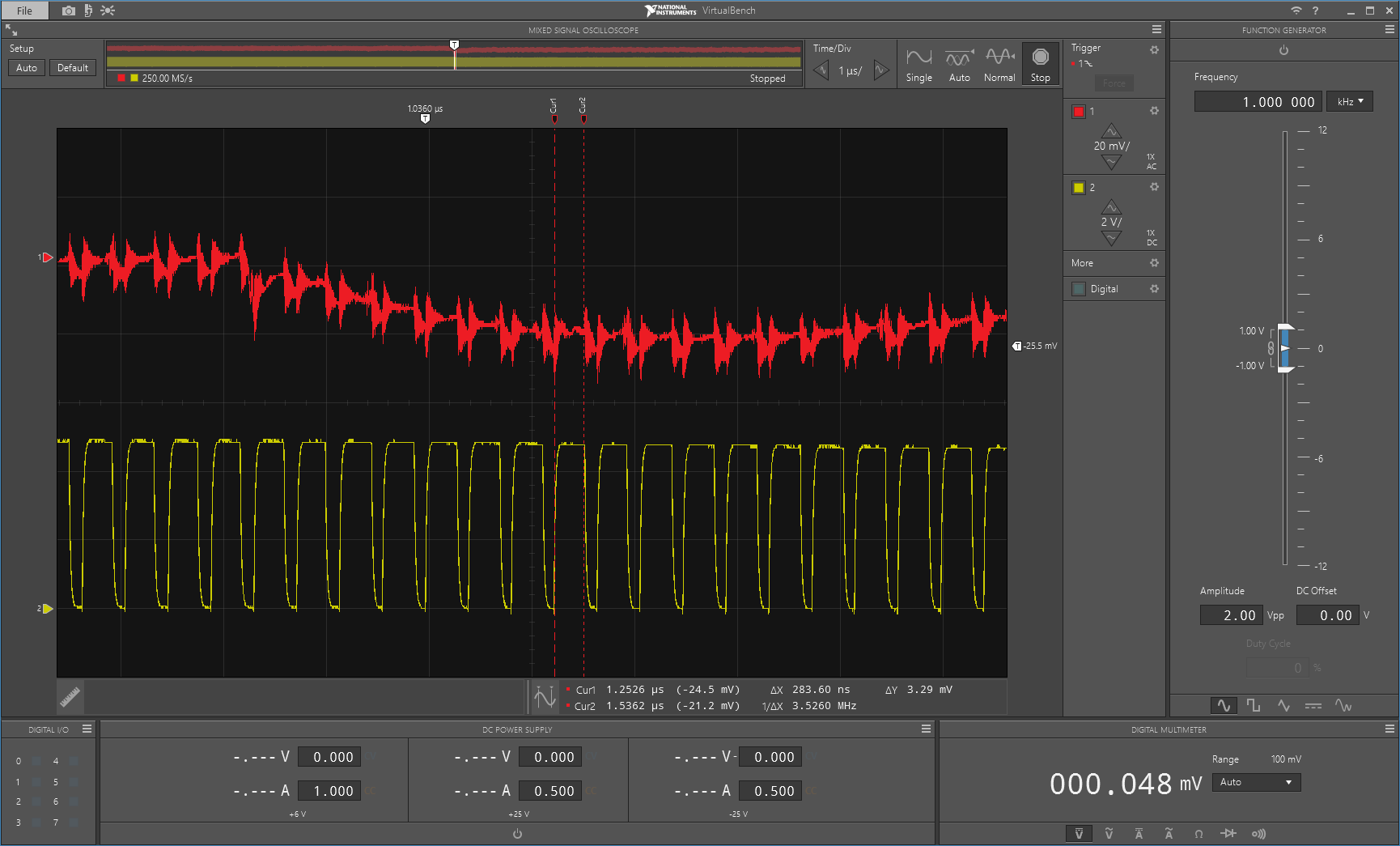

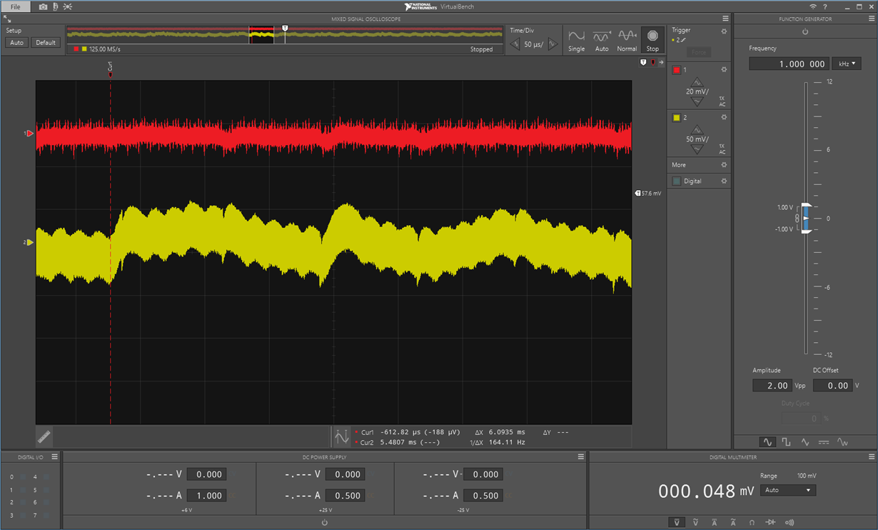

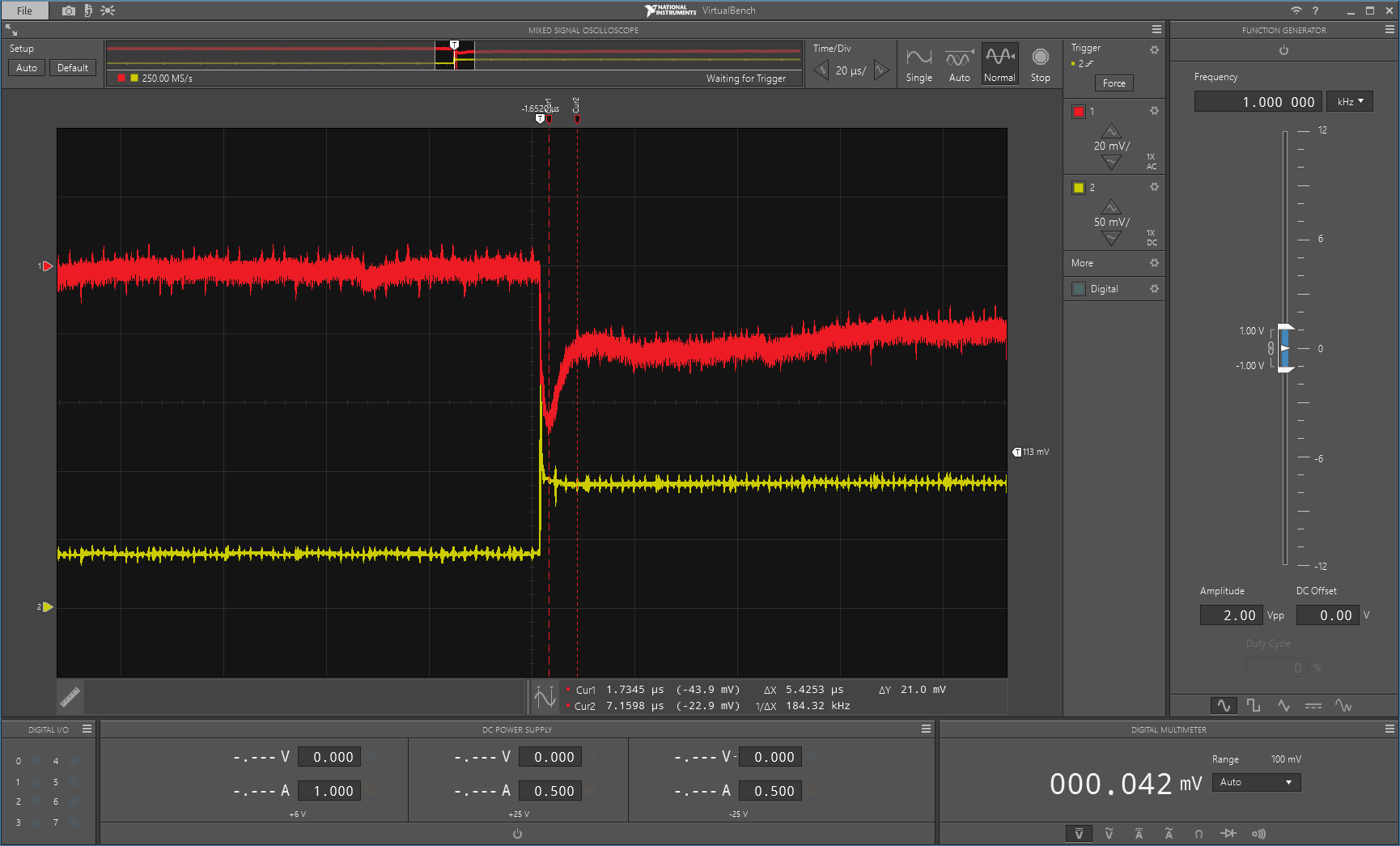

    Per our discussion during the meeting last week, I have captured the switch node waveforms of 3 during normal operation, transient, and low frequency noise appears on Vout. For the transient one, I see the turn on time gradually changes from 275.7ns ( before applying additional  330mA load) to 291.5ns ( after applying additional 330mA load). For the switch signals with noise appears on Vout, I can not really tell the details. Since the switch frequency is high, as we keep the picture of noise, it is hard to see details on switch signals. Please see scope shots. Red one is Vout with AC coupling, yellow ome is switch node signals.

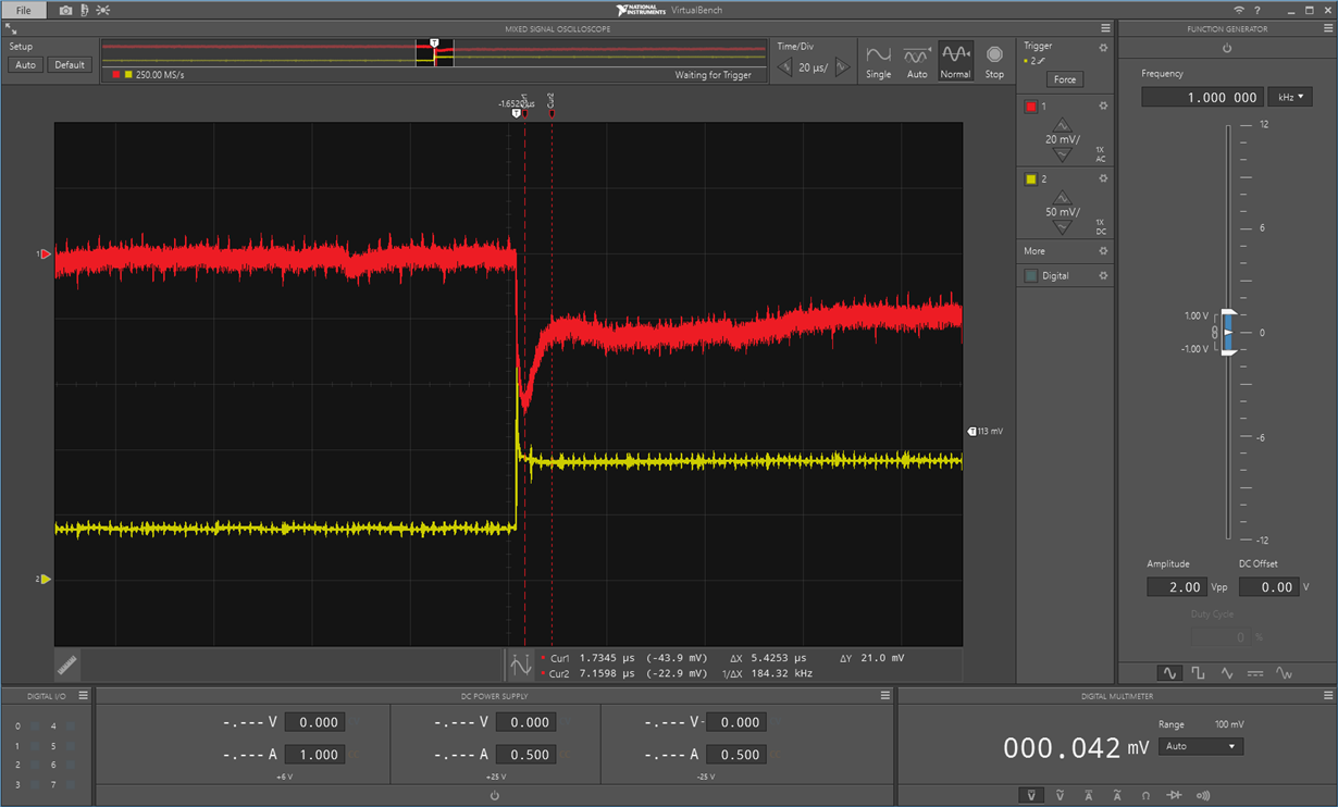

  • I also have tested this 3.3V power supply ( with Vcout = 10uF) with a pure resistor load.  I disconnected all the load on the board and provide a 220mA steady load via a external 15 Ohm resistor, the use an additional  10 Ohm resistor in parallel with it to provide a 330mA load step change.
    I have noticed that the low frequency noises now are different from those with our board loads, which have 26uF capacitance as a part of load. It appears it has less noises, and the noise frequency is lower. I have tested  cases with Cff=150pF and without Cff . It looks like it has slightly bigger phase margin with Cff=150pF. please see attached scope shots on 3.3V supply with  configurations of   Cff=150pF, Vcout =10uF, external steady current load of 220mA .
  • also please the scope shots on the noise I see and step response on  the 3.3V supply with  configurations of   no Cff, Vcout =10uF, external steady current load of 220mA .
  • Hello Jake,
    Thank you for sharing the waveforms.
    Both the ripple voltage and transient response improves when you disconnect the 3.3V rail to the system load with 10uF output capacitor. Please see suggestion below.
    1. With Cout = 10uF; Cff = 150pF @ 3.3V rail, can you connect R136 directly to pin 8 of the TPS624210 instead of the GND pad? Check the ripple and transient load waveforms. The intention of this experiment is to determine if the issue is related to FB resistor layout.
    2. Increase the Cout from 10uF to 26uF (10uF + 16uF) to simulate the actual capacitance of the system seen by the converter. Check the ripple voltage and transient load waveforms again.

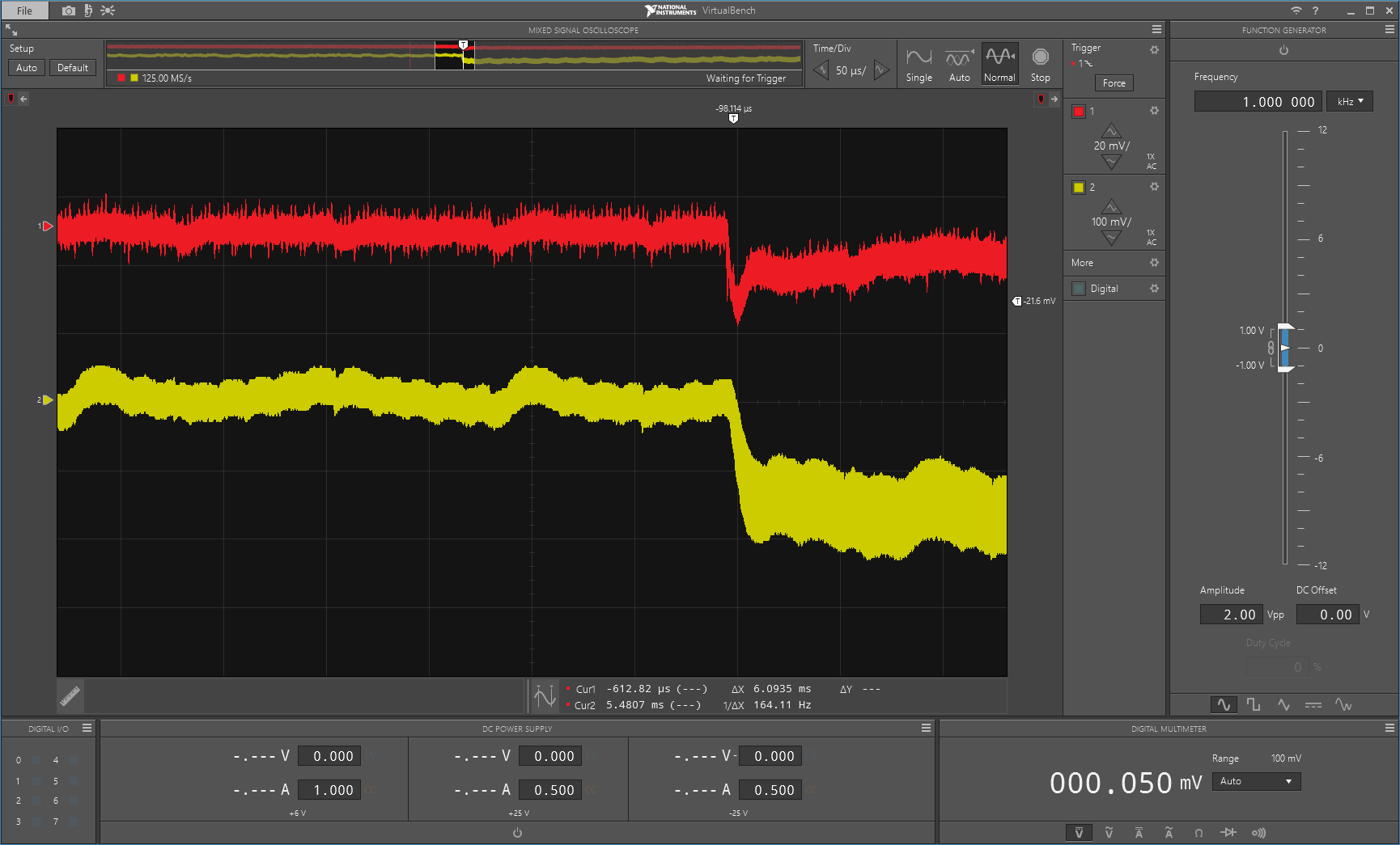

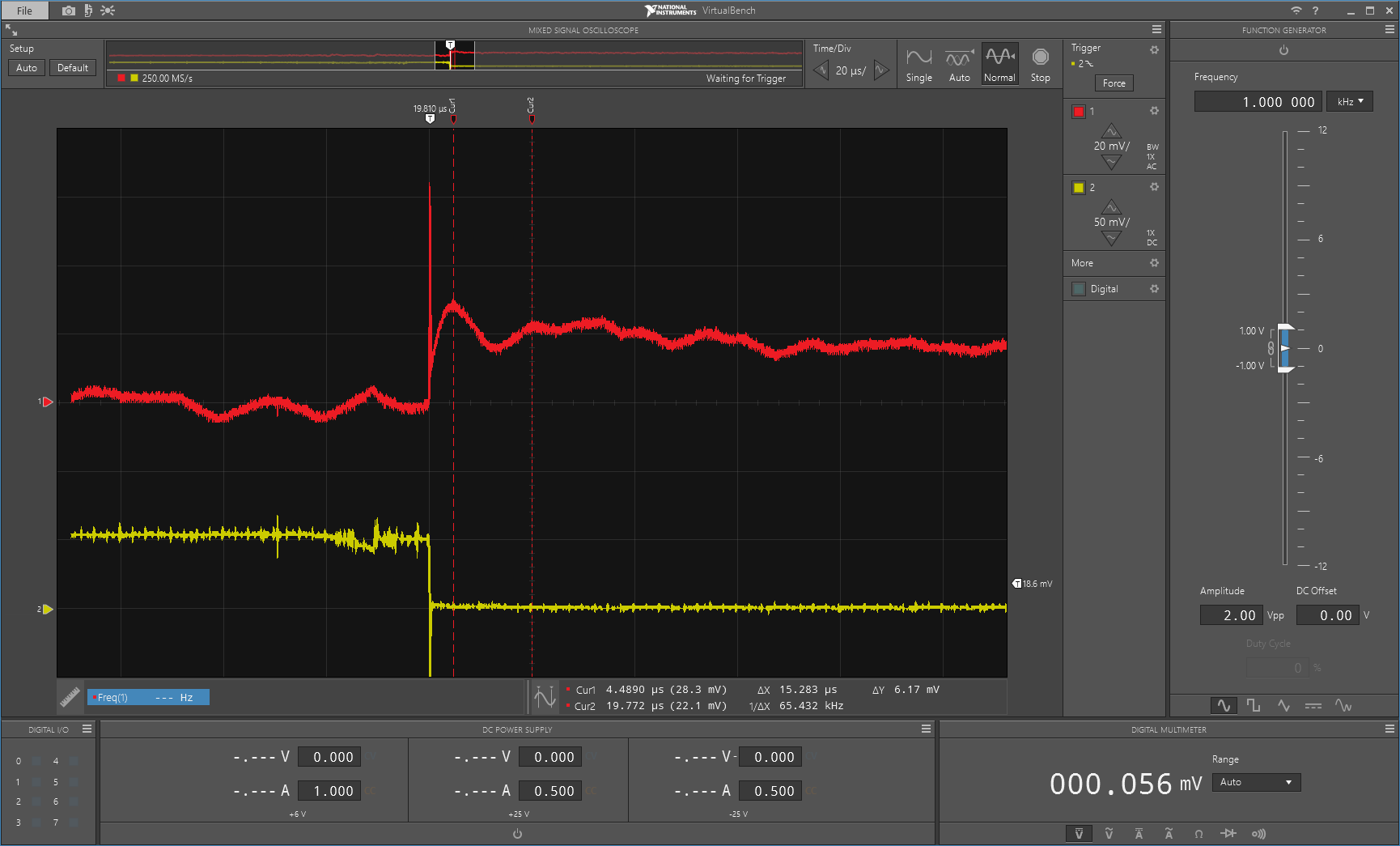

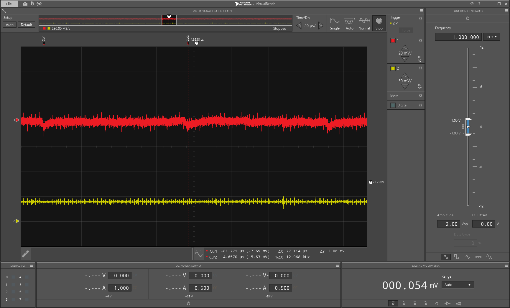

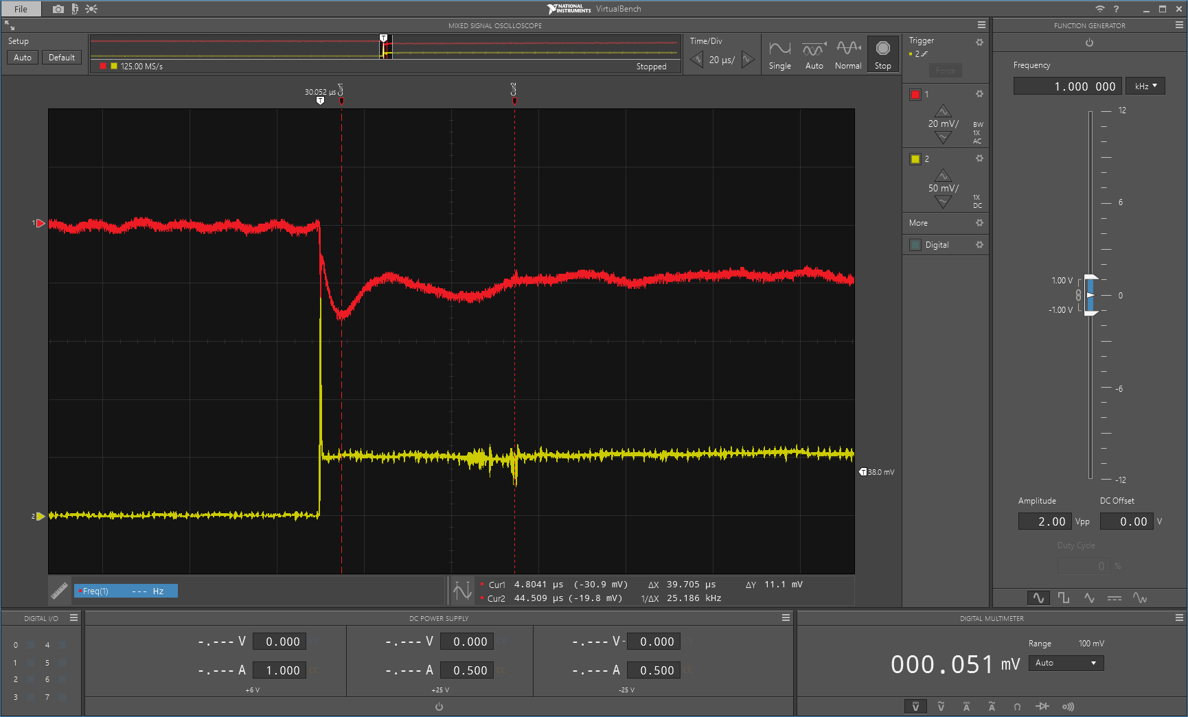

    With Cout = 10uF, Cff= 150pF at 3.3V rail, I have done the reworks to directly connect R136 to pin 8 of the TPS62410, I do not see improvement on the low frequency noise ripples and step load transient response.  please see the noise waveforms and transient response waveforms below.
  • with external resistance load, Cff=150pF, and reworks on R136 ( directly connect R136 to pin 8 of TPS62410) , I also have increased Cout  with the following values:
    1. Cout = 26uF , as you suggested. I do not see noticeable change
    2. Cout = 48uF, simulate with our original conditions, which are Cout =22uF plus  26uF decoupling caps on the loads. I was expecting worse performances, but do not see noticeable changes as well.
    please see the low frequency ripples and transient responses with Cout=26uF:
  • also please see the low frequency ripples and transient responses with Cout=48uF:
    Based on what I see with those signal waveforms, the power supply has better performance with external resistor load (even with Cout =48uF.).
    For comparison, here are step responses when power supply (with Cout-22uF and Cff=150pF) is with system load on the board. Those waveforms were captured before we had reworks on R136. I think it will be the same even we connect R136 to pin8 of TPS62410 based on the tests with external resistor loads.
  • Hi Jake,

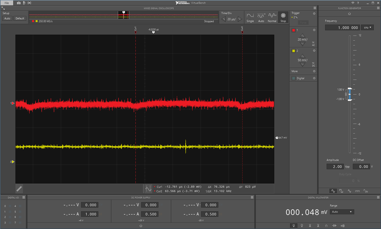

    I looks like that the Vout waveform during transient load does not have the voltage oscillation with the new setup while high frequency oscillation on the ripple voltage is still present. Anyway, can re-measure the transient load and ripple voltage and include the VIN waveforms (place the oscilloscope probe across VIN and GND pins of the IC)? I wanted to know if the voltage oscillation can be attributed with IC supply voltage.

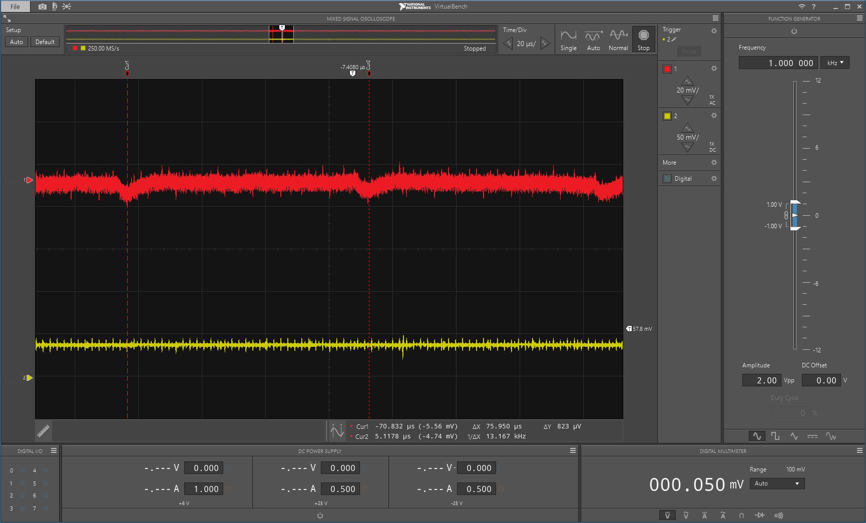

    As you suggested, I have looked at Vin with/without  load step changes. The input does some small noises, some of them sync to those output ripple noises, but some of them do not. The test setup is: 3.3V rail with external resistor load, Cout= 48uF, Cff=150pF, R136 is directly connected to pin 8 of TPS 62410. please see the scope shots. The red one is Vout, and the yellow one is Vin.
  • Hi Jake,
    Can you identify which of the waveforms were during transient load and stead-state conditions? I will ask Russell to arrange a concall to speed-up our discussion and close your issues.
    Excel
  • Hi Excel,
    Among the four scope shots in my previous post, the first three scope shots are with load step changes and the last one has no load step change.
    Also in the first scope shot, the yellow channel ( Vin ) is with DC coupling, and in rest of three scope shots, both channels are with AC coupling.

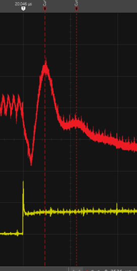

  • Hi Excel,

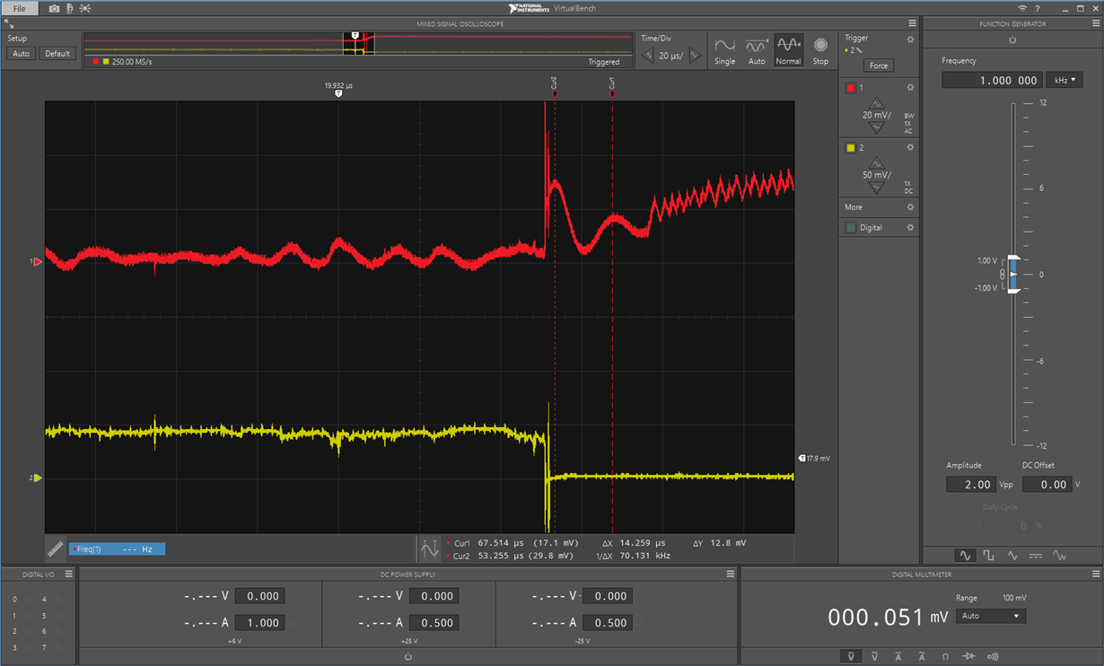

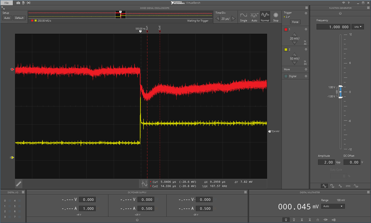

    per our discussion this morning, I have done the reworks on 1.5V rail power supply to directly connect R142 to pin 8 of TPS62410 and checked the transient response. I do not see improvement.
    Please see attached scope shots. circuits configurations are: C51 = 82pF, C192 = 10uF, system loads are connected to 1.5V rail.
    Jake
  • Hi Jake,
    Thanks for sharing the waveforms. It looks like there is no improvement in changing the R142 connection.
    Can you capture the waveform with test conditions with VIN, ILOAD, SW pin, and VOUT signals? Please zoom-in on the waveform so I can see the SW pin behavior (refer to the figure below). Lastly, add a Rload on the output to make the device operates in PWM mode, then do a transient load (capture the signals as well).
