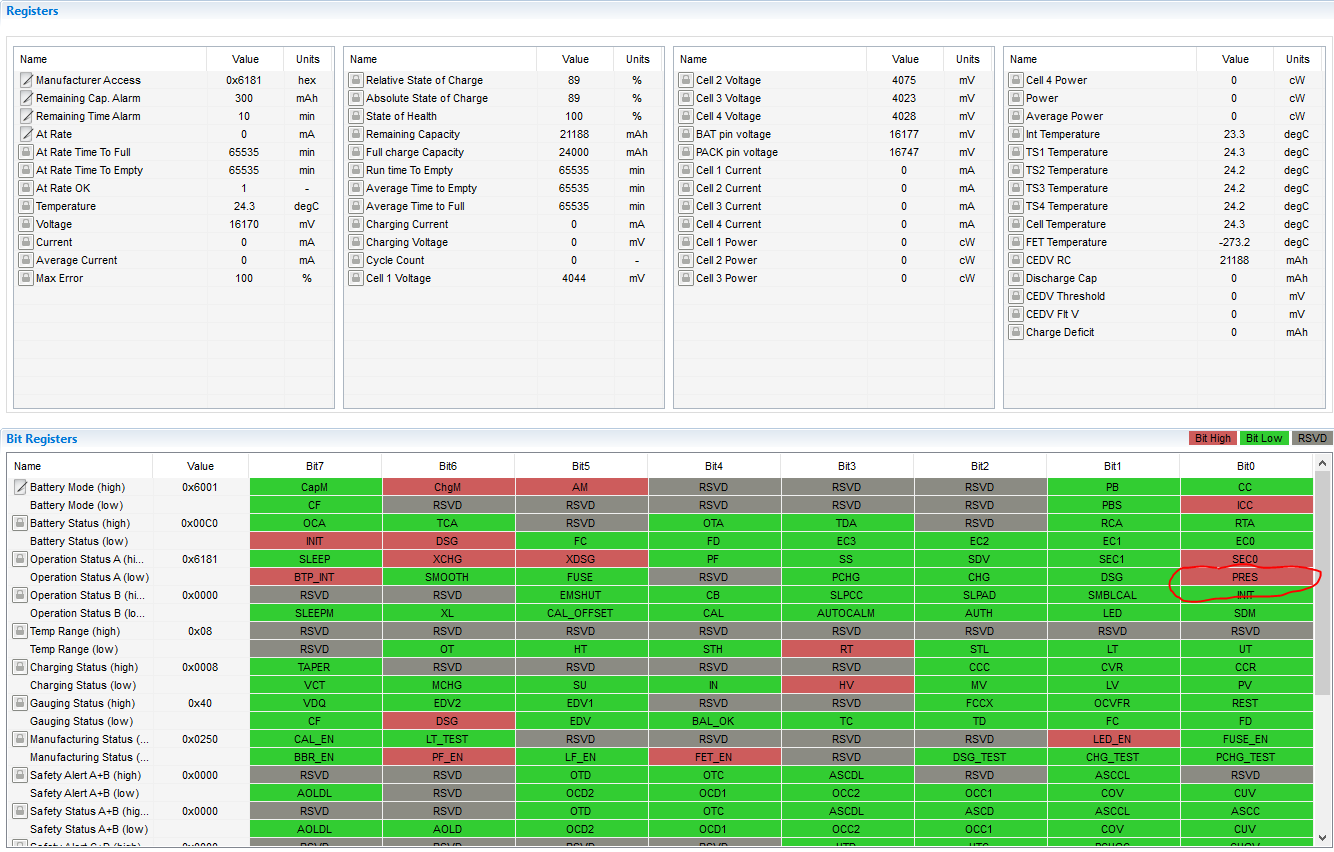

After finish init, I'm using BQStudio to read register:
 no erro in register but the XCHG & XDSG = disble
please support me, I don't know why.

  • yes, it's already configured to 4 cells ( CC0-CC1 = 1,1 )
    all PF, status, PF alert bit is 0, CHGFET=1, but XCHG, XDSH = 1
    Packet vol= 16800mV. Please check again gg file that I export when connect via I2C. Sorry, last file is original, when I no connect to my ECUEVK_After_connect_I2C.gg.csv

  • The PRES pin has to be asserted (Pulled to ground) to turn on the FETs once FET_EN is set, unless the pack is configured as a non-removable pack.
    To configure the pack as a non-removable pack you will have to set the [NR] bit (Bit2 in "DA Configuration" under "Settings" in the Data Memory.
  • Hi Nick
    this PIN already connected to GND. The status of ManufatureStatus PRES bit is 1 now

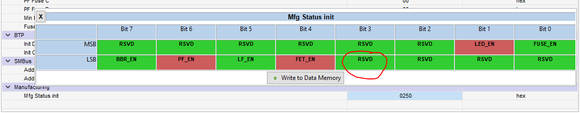

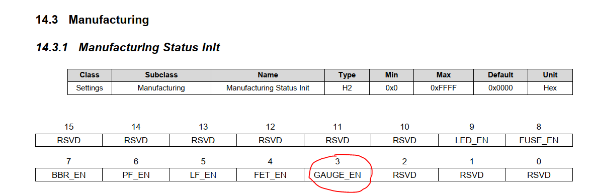

  • hi Nick, 1 more points I see:
     I see in sluuqa3.pdf page 128 have GAUGE_EN bit
    but in BQ studio, in Setting:
    what's wrong now?

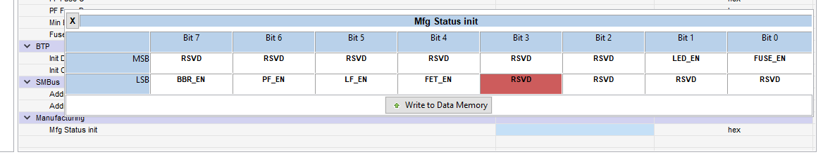

  • in sluuqa3 page 128
    but in BQ studio, in Setting Data Flash
    And status of PRES in my side is already LOW
    please support me to find the reason

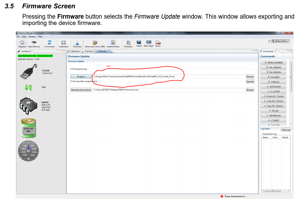

    1 more point: in BQ4050-EVM 561 manual, in Firmware update, I see the bq4050_xx_22.srec. if possible, could you please give this SREC file to write default value to data flash
    thanks
    not sure what your asking, please clarify.
  • hi Nick, my question is :
    1. if I disable FET_EN, send command CHG_FET_TOGGLE, BQ4050-EVM 561 can charge, send command DSG_FET_TOGGLE, BQ4050-EVM 561 can discharge. But when I enable FET_EN, it's not charge/discharge. The PRES pin is already pulled to GND ( PRES status is 1). No error in PF bit, same in Status Alert, PF Alert. See the picture below ( I don't know why XCHG&XDSG bit alway 1 )
    2. In TRM (sluuaq3.pdf file) page 128, the manufacture status init data flash have GAUGE_EN bit, but why in BQ studio software, don't have this bit?
    please see in picture below
    3. in BQ4050EVM-561 user manual (sluubf9) , in 3.5 Firmware Screen, could you please give me bq4050_v0_01_build_22.srec. I want to reset Dataflash to default by write this file
    thank you very much
  • Hi Ho,
    Upload the current .gg and I will take a look, also can you upload image showing all bit registers.
    No need for a new srec and you can reset defaults within bqstudio.
