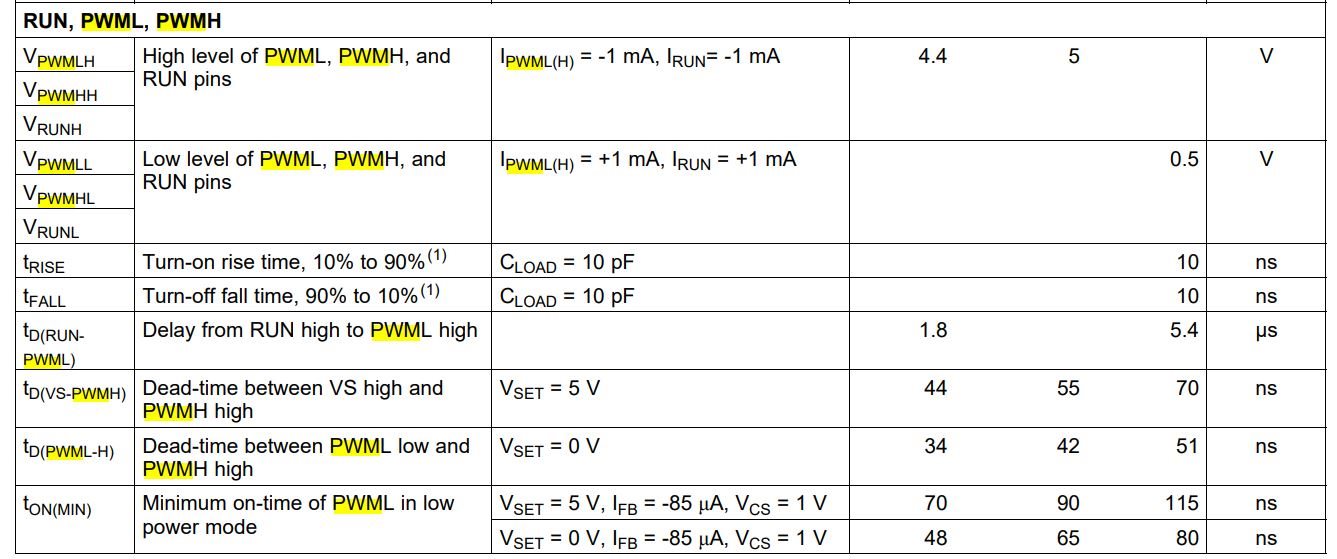

UCC28780: IPWML(H) of PWML,PWMH
Part Number: UCC28780
Hi E2E,
1. Would like to learn why at high/low level of below pins, the load current is negative/positive?  Typical high means source, positive, and low means sink, negative.
What's more, I think the name is missed for current definition, we should have IPWML(H), IPWMH(H), the "(H)" should mean reference direction of source/sink current, I guess.
2. The maximum source/sink current is ~1mA, right?Could I use 0.5V/1mA=50Ohm to estimate the pull-up and pull-down resistance inside PWM output stage?
3. The test condition for Trise/Tfall is with 10pF Cload, if no load connected to PWM, what is the rise/fall time? Will it differ much?
Let me know if you have any comments. thanks!
