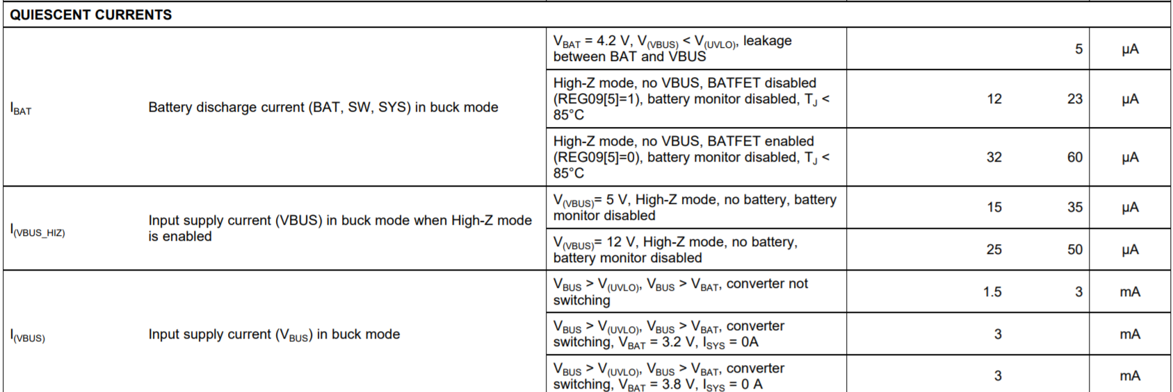

    What is the quiescent current value for BQ25895 without charger input voltage (Vbus) ?
    BQ25895 system voltage is displayed between 3.5V and 4.2V, (SYS 3.5 - 4.2), is this an adjustable value ?

    All of TI's NVDC power path charger's have SYS output that provides MINSYS voltage, when the battery is low, and then follows the battery voltage up to regulation (4.2V for typical LiIon battery).  The MINSYS voltage (when battery is below this voltage) is adjustable from 3.0V to 3.7V  If you need 3.3V output then you must add a buck converter following the SYS output.  THe BQ25895 is controlled by host software via I2C. The BQ25895 Iq(VBUS) when switching is 3mA but drops to 23uA max if when VBUS voltage is removed or HiZ is forced using I2C.   There is a MPPT reference design for solar panel input at the link below:

    Q1:  I will add TPS63802 (3.3V output) converter following the SYS output and configure I2C MINSYS voltage as 3.0V. So I will get 3.3 constant voltage in the system. As long as the battery voltage does not fall below 3.0 V, the quiescent current will be at the level of uA. Is it right ?

    Regarding Q1, it depends. The Iq values for VBUS and BAT are shown below.  When in HiZ mode, the values for each are in the uA range.  When their is a power source at VBUS and the buck converter is switching, the Iq value is also shown below.  If there is a load on your 3.3V value, the current into VBUS (up to the current limit you set) and/or current out of the battery will increase to provide power to the buck-boost converter at SYS.
    Regarding Q2, there is no issue placing two LiIon batteries in parallel as they will self balance.  In your application, keeping the input voltage to the buck- boost converter no higher than 4.2V will keep it running at high efficiency.
