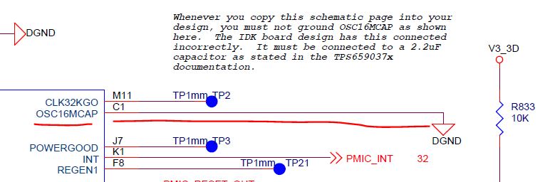

As there is a bug on AM6718IDK, did not add capacitor on OSC16MCAP. Customer followed the wrong schematic.
Now customer board, the 16MHz crystal does not active, but remain functions work, and the AM5718 also works we are not sure whether it is related the capacitor, I measured on AM5718 IDK, even without the capacitor, the crystal works and outputs 16MHz.
Questions:
#1. what factor result in the 16MHz crystal doesn't output clock?
#2. if doesn't mount the capacitor and connect the pin to GN directly, will it introduce malfunction?
