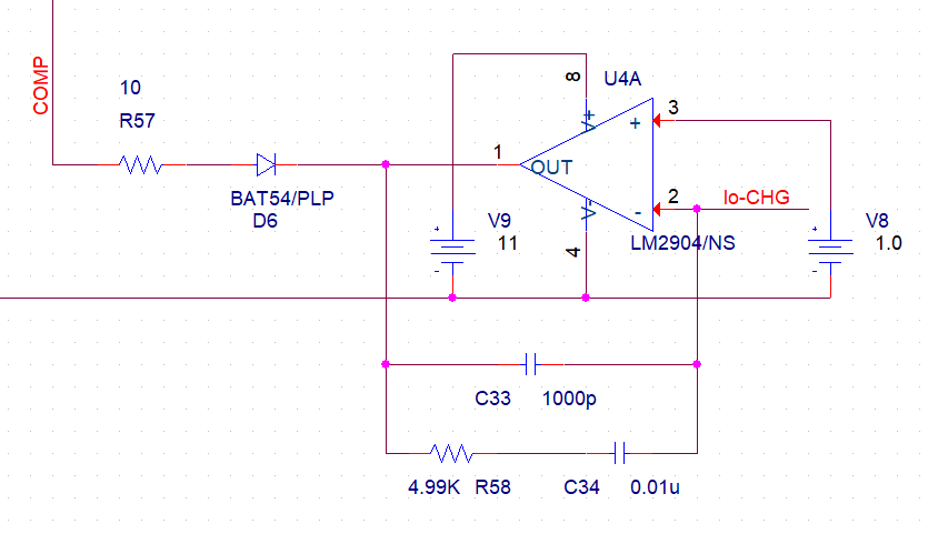

Dear TI Expert:
This converter (LM5176) charge to battery pack, so the constant current level shall be modified by external micro-controller. So the ISNS function of LM5176 is disable by Rsns=0ohm.
I simulated the circuit by TI tool and the simulated result is good. But the real test is not good (LM5176 is damaged. The resistor 2.2ohm is open.)
Question:
1) Shall the external constant current be connected to pin 9 COMP or pin 11 FB?
Now it is connect to pin9 comp. But the LM5176 is damaged during constant current mode.
Is there anything I should know?

  • Hello Aska,
    Would you please share your complete schematic?
    For an external regulation, using COMP pin is a good solution as long as you make sure that the voltage on COMP stays within the abs max rating.
    Where did you connect FB to?
    Did you disable the ISNS function or the CS function?
    You could use the device as well in the configuration given in this reference design, but would need to add your circuit to the ISNS funtion:

    1) Before pcb layout, I check it in simulation. The external constant current circuit doesn't work while connect to FB pin. So the external CC circuit connect to COMP.

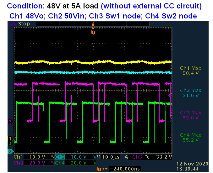

  • Dear Brigitte:
    Attached is the waveform. It is only LM5176 converter w/o external constant current circuit.
    1) By previous damaged test (enable external cc circuit), the damaged component is only LM5176.
    2) Switch node is not square waveform due to the high/low side mosfets turn-on in short period. But I don't know why.
    Aska
    Sw1 node is the first leg of inductor (the switch node of buck mode)
    Sw2 node is the 2nd leg of inductor (the switch node of boost mode)

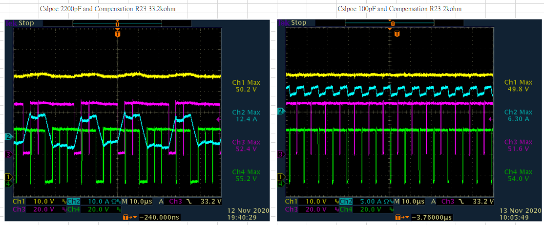

  • Hello Aska,
    Would you please try 100pF for the slope compensation and reduce R23 to 2k?
  • Dear Brigitte:
    That is amazing. The switch node waveform is pretty good. (right side picture).
    Could you please let me know what problem is?

  • Hello Aska,
    The reduced COMP resistor reduces the crossover frequency and make the converter less sensitive to noise in the system but reduces as well the reaction speed on load or line transients. So you need to check if the transient response is still fast enough for your system.
    The reduced slope capacitor reduces as well the noise sensitivity.
    In general a switch mode power converter needs to have a crossover frequency as low as possible for the system needs to make it maximum stable.
