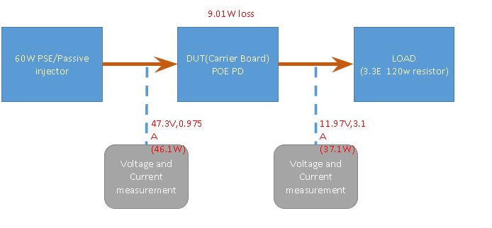

    The maximum temperature is accepted by the customer.
    We have an observation when powered our board with 60W PSE and connected a load on the output of the POE section. We observed a power loss of 9.01W on our board.
    Following are the observations.
    This is our test method :-
    Please let me know your comments on this.
    9/60 = 0.15 --> so the design is about 85% efficient at 77% load capacity. That is not far from the TIDA-050023. Please review the test report and let me know if you have any other questions!
