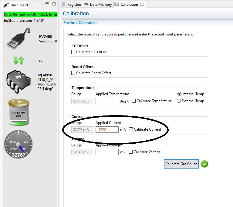

Good morning, please need some help . I followed the calibration steps as per the manual. By calibrating at -2000mA. When I do "read all", I noticed that The CC Gain and CC Delta registers are changed to 1.xxx mOhm. So when measuring current during discharge the report is fine and accurate, but if I charge the battery, the reported current value is like multiplied by 10. Please see attached picture. I made the exercise to calibrate also at positive current, for example 2000mA. The CC Gain and CC Delta are changed to 10.xxx mOhm. So when charging the current is reported fine, but when discharging the current reported is divided by 10. At this time I cannot calibrate, to have both directions current measurements reported well, meaning reporting correct current. Please advise Thank you
    Does this happen on all your boards? Can you outline the steps you take to calibrate the gauge? your offset seems very high.
    Sincerely,
    Wyatt Keller
  • Good morning Wyatt,
    this is the only eval board I have.
    I followed exactly the manual for the calibration, step by step.
    Steps I followed:
    1) Unseal and Unseal full access
    2) CAL_Toggle to set CAL_EN high
    3) In Calibration tab of BQstudio, performed only Temperature calibration for external sensor
    4) Calibrated voltage only by measuring the battery terminals and wrote that value in Applied Voltage field (in mV)
    5) Calibrated only CC Offset
    6) Calibrated only Board Offset
    7) Using electronic load of 2Amps, calibrated current only and wrote -2000mA in Applied Current field.
    8) Sealed the gauge
    9) Reset the gauge
    When measuring discharge current the value is correct, but when charging for example 1Amp (1000mA), the measurement near 10000mA. 10 times higher.
    If I calibrate current using positive current (charging), then while charging the current value is correct, but when discharging, the value is divided by 10. For example discharging at -2Amps, the value reported is -200mA.
    I have attached the export file *.gg.csv of the data memory setting for you reference if you want to look at it. My battery is 3 cells 10.8V 20Ah Li-ion.
    Thanks you
    Max L.
    BQ34110 Data memory for Current Cal Issue.gg.csv

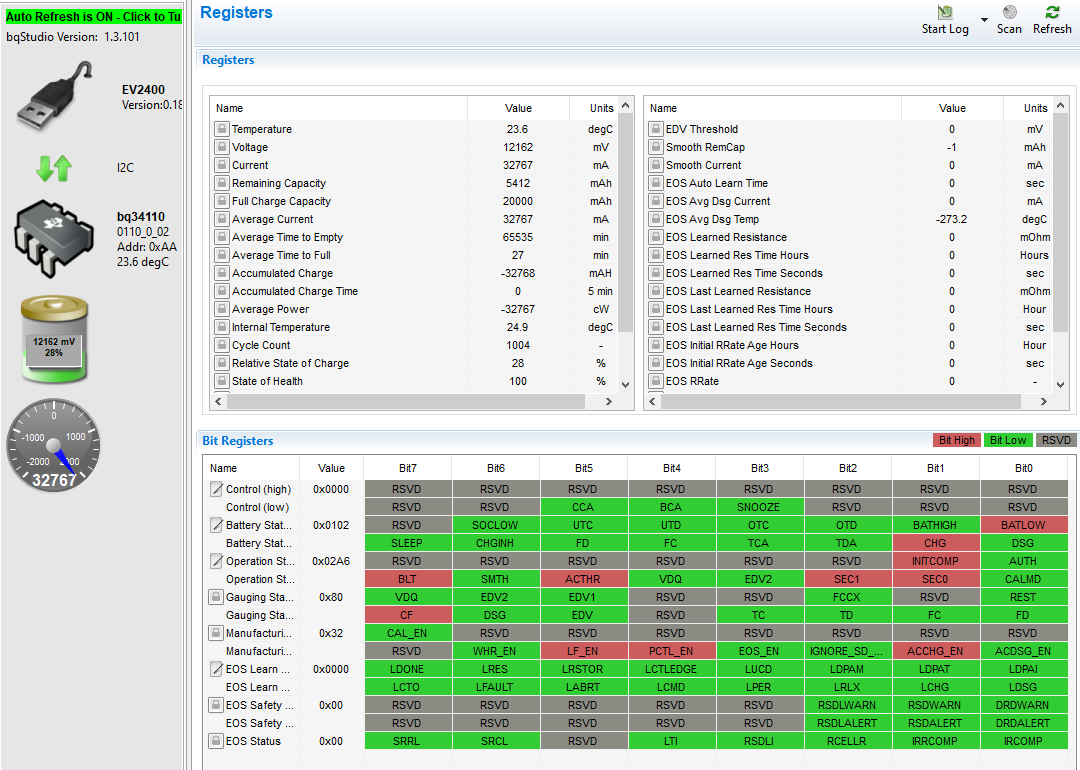

  • Hello Wyatt,
    We have an old second board.
    I connected with same setup and I am able to read all DATA memory using BQstudio. But when I try to write the complete settings or any single para meter gives me an error saying " A read of data written failed comparison". Nothing is written. When I read all para meter again, it shows the ones originally on the IC.
    Also when calibrating current and read current during charge or discharge it is always at 32767mA. It updates the voltage but the current is always 32767mA, even when not charging or discharging.
    Is there anything I am missing? Or maybe that one is damaged too?
    Thank you
    Max

  • Hello Wyatt,
    The connection of battery/EVM board/Charger is correct according the EVM guide.
    Attached is registers screenshot for Registers and Bit registers
  • Hello again Wyatt, please notice the current field is not corrected after I performed calibration. I toggled CAL_EN before perforning calibration.
    Current field is always 32767mA no matter is is charging or discharging.
    Thank
  • Hello Max,
    If the current is not calibrating correctly and it always at a max value there may be some bad connection on the SRN or SRP pins.
    Sincerely,
    Wyatt Keller

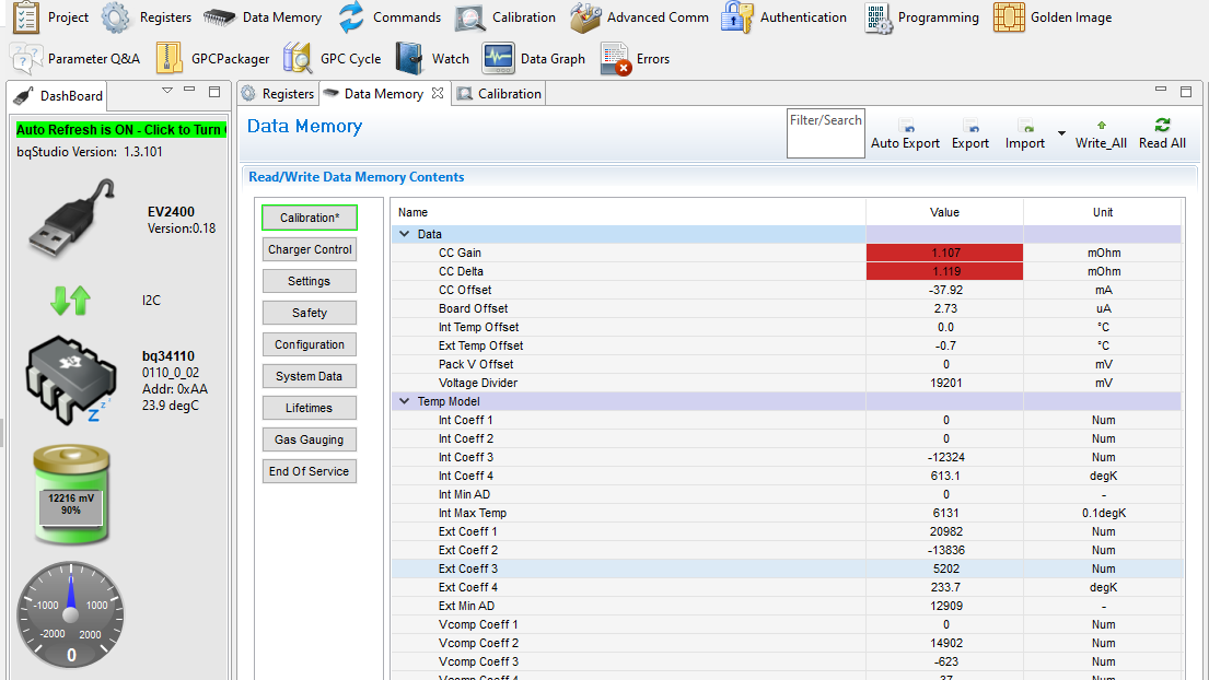

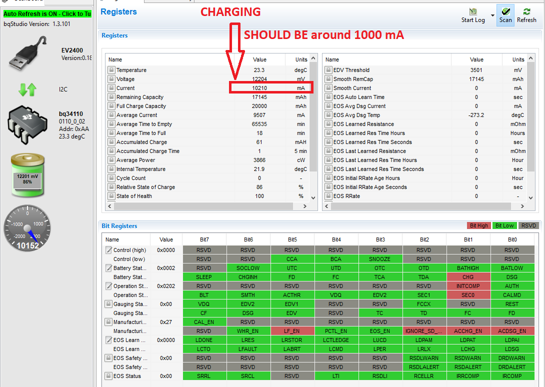

    hey look, I replaced the IC on the board that was not writing updating the data memory. Now i can write on it.
    But after calibration using -2000mA, when measuring the values in Register window looks fine, but when charging the current value is multiplied x10 + something else.
    So now I have two boards performing identical, same issue both. Please look the screenshots. Any advice will be really helpful.
    Thank you
  • Hello Max,
    Can you re-flash the .srec firmware to the gauge with the most recent? Also make sure all the connections on the EVM are correct, can you share an image of how it is connected?
    Sincerely,
    Wyatt Keller

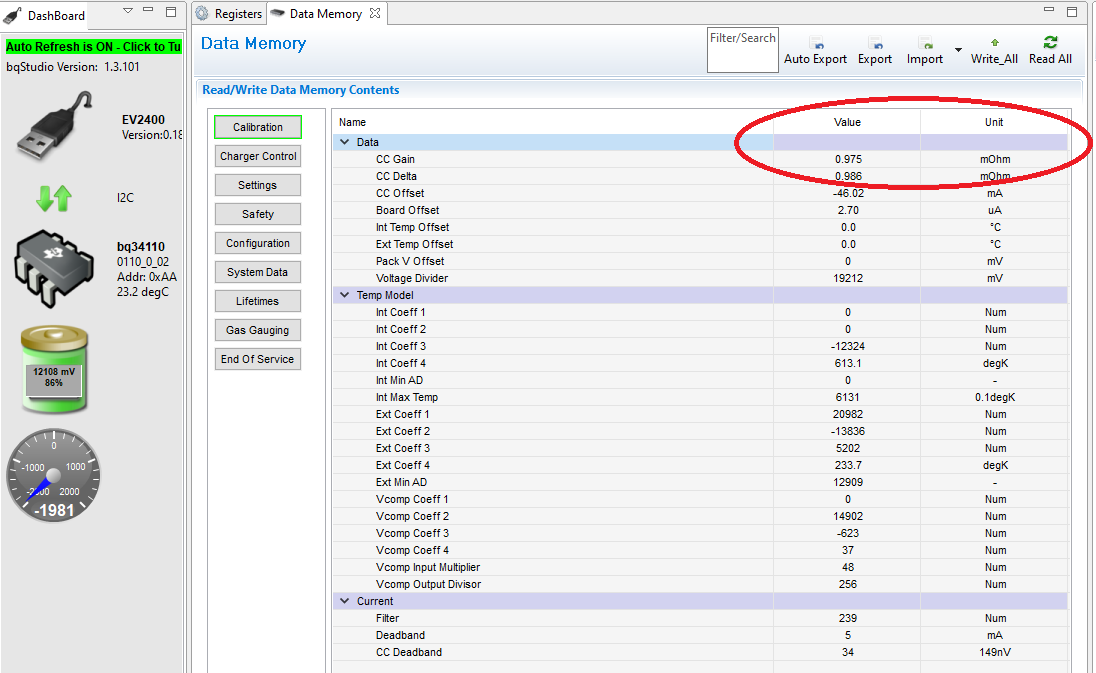

    thank you for your advices.
    I programmed the 34110 with the lastest .srec found in the TI web site ( bq34110_v0_02_build_9.srec ).
    When I clicked on the Execute FW button in the Programming window said at the left low corner on the screen ( Failed to execute firmware - No acknowledge from device)
    So I did RESET and read current values before calibration just as reference:

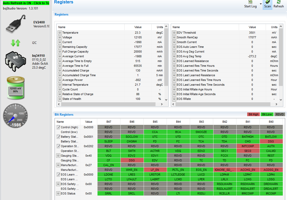

    BEFORE CALIBRATION:
    I noticed that by default CC Gain is 9.999 mOhm and CC Delta 10.000 mOhm
    1) When run charging the current almost match my charger, meaning 0.5A and the Current value on  the Registers window is 494mA, which is fair close.
    2) When running discharge at constant current of 2A, the Current value on the Registers window is -223mA, that's bad since should be close to -2000mA. It is dividing by 10.
    AFTER -2000mA CURRENT CALIBRATION:
    I noticed when reading Data Memory that CC Gain changed to 1.125mOhm, CC Delta changed to 1.137mOhm, CC Offset changed to -45.99mA
    1) When discharging at constant current of 2A, the Current value on the Registers window is now -2000mA, which is excellent.
    2) When running charge at current of 520mA, the Current value on the Registers window is now 4750, that's bad since should match the real current of 520mA. It is multiplying by 10 and substracting the CC Offset multiplied by 10
    4750 + (-45.99*10) = 5210 mA  this is 10 times the real value of 520mA
    I do not know what else to do, if there is some other settings I am missing

  • Hello Max,
    I would double check that the currents are accurate that are being applied, like I mentioned earlier I haven't seen any of gauges behave this way before. There's only a couple options I could think of:
    • The current applied/measured from the other equipment is not correct
    • Something with the reference for GND or PACK- is not correct causing some distortions
    • Something with the gauge calibration, which I have not seen before
    Sincerely,
    Wyatt Keller

  • Hello Wyatt,
    I connected the multimeter to the PAck- path to measure the current flowing through the sense resistor.
    I noticed same error. The issue was on the Battery analyzer GUI which I use as a Load. I fixed the settings and recalibrated.
    Now is measuring fine in both directions.
    All good now.
    Thank you very much for your hints and your time.
