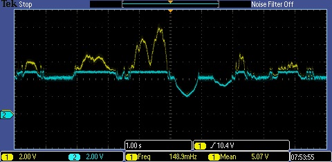

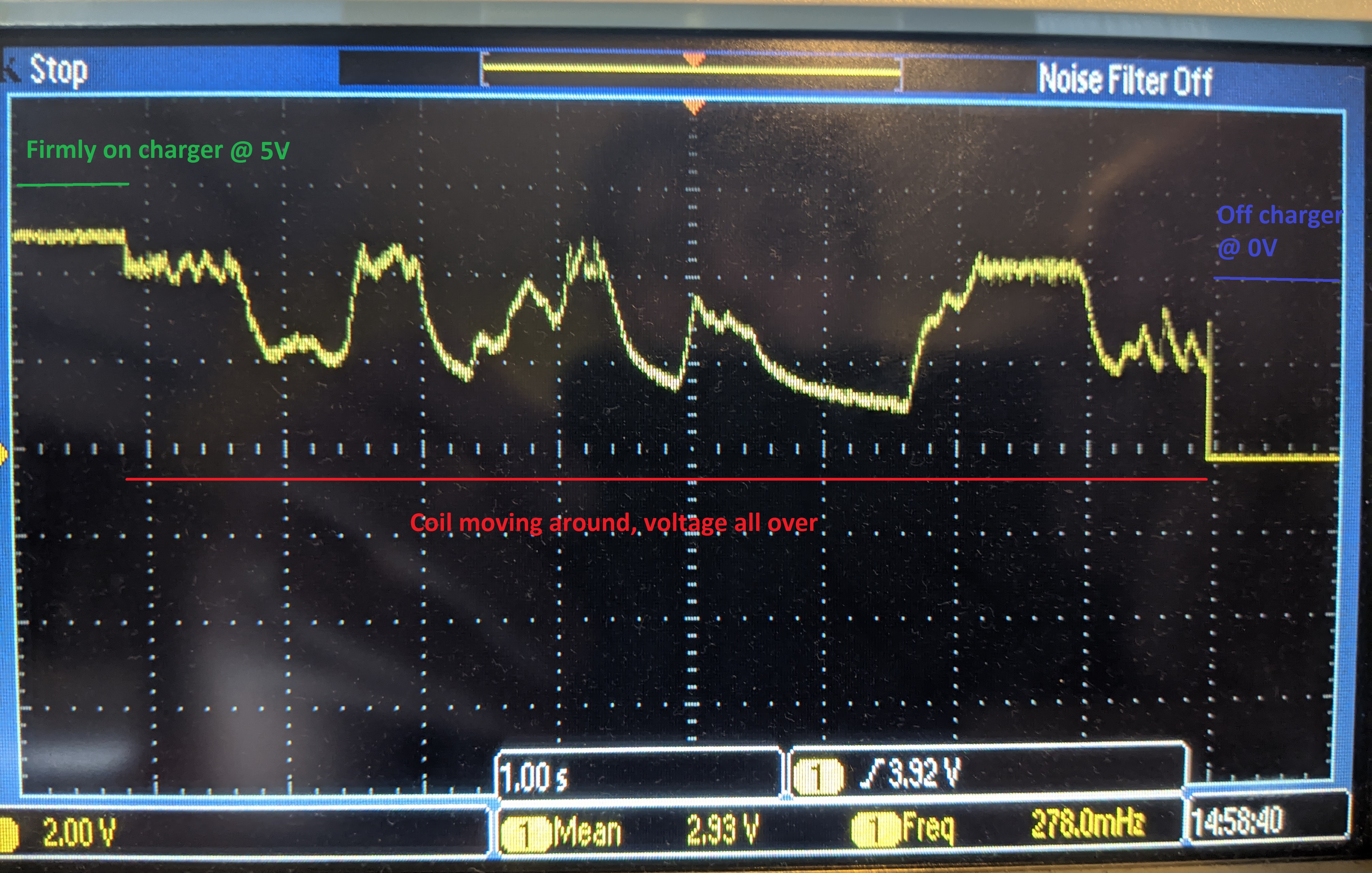

We are using a wireless charging coil and rectifier as the input to the TPS70950DRVR. The output powers the battery charger IC, which powers the rest of the system. I probed the voltage on the output pin and notice it varies from ~1V to 5V as the wireless charging (Rx) coil is moved around over the Tx coil. We believe this is causing undefined behavior with the battery charger IC, so looking for help to stabilize the output from the LDO. I'm also wondering if this is expected behavior for the output?
The picture below is the output from TPS70950DRVR (input to battery charger) as the coil is moved around.

    This is not expected behavior if the input to the LDO is not also falling to ~1V, so I wonder if the output voltage of the rectifier is just not sufficiently high to keep the LDO out of dropout and the output at 5V. Even if the rectified voltage was moving around a lot but was always high enough to avoid the LDO going into dropout, the output would not behave like this. Since these changes in voltage are very low frequency, the output would remain very stable so long as there is sufficient headroom.
    Can you please provide another scope shot with the LDO Vin and Vout together?
    Nick
  • Thanks for the quick reply, here is Vin (ch1) and Vout (ch2) as the Rx coil is moved around.
    It does look like the output drops below only when the input is too low. Should the output be disabled in this case?
    The LDO doesn't care, but that depends on your specific application. If the downstream ICs cannot properly function over the voltage range you are seeing, then you may want to have the LDO turn off if the input is not sufficient to maintain the output. You can do this by using a resistor divider at the input for the EN pin to shut the part off when the the input falls too low.
