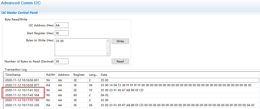

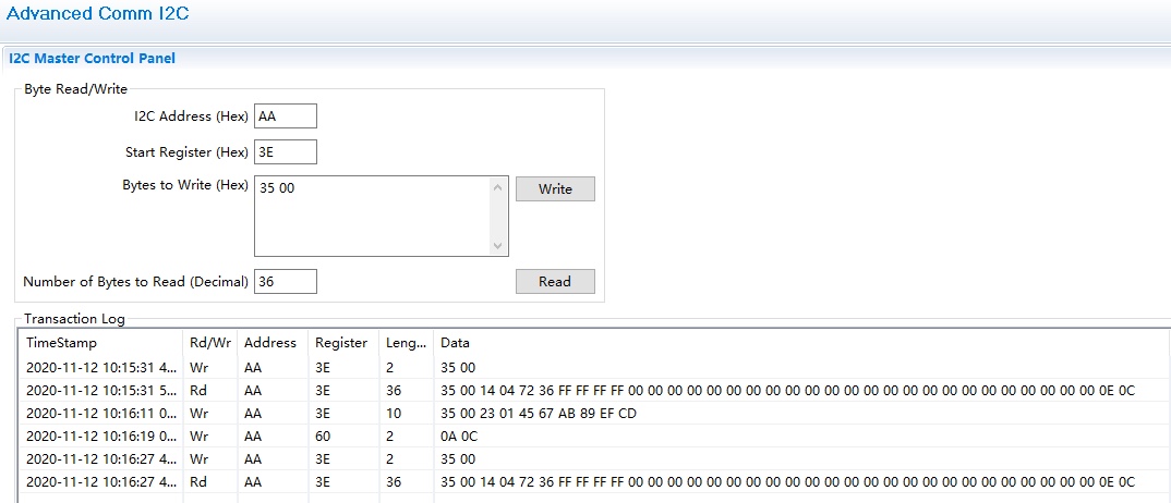

  1. In the Chapter 9.5 of BQ28Z610TRM, a guide for changing security keys is given as below. What does the 2nd key here mean? The second command starting at 0x60 or Byte1? If it is the second command starting at 0x60, how can I finish it within 4s? Customer found it is hard
And I found a picture in .
It looks like it did not follow the 4s limit between the first command and second command, which confused me and my customer a lot.
