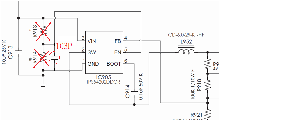

Hi Support team
since lighting surge test problem, my customer needs to add 103P cap on EN PIN to GND, but remove resistor
the application circuit is as following,
any side effect
Hi ,
It's okay to remove resistors here. for the cap, what's the value of it ?
BRs,
Young

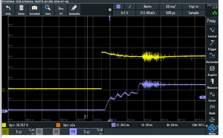

After implemented the 10nF in EN pin, my customer found another issue that VOUT will startup non-smoothly after discharge the 10nF cap (cold start)
do you know the reason?
the countermeasure right now is addition upper 240Kohm and bottom 100Kohm to resolve it
any side effect w/ this change?

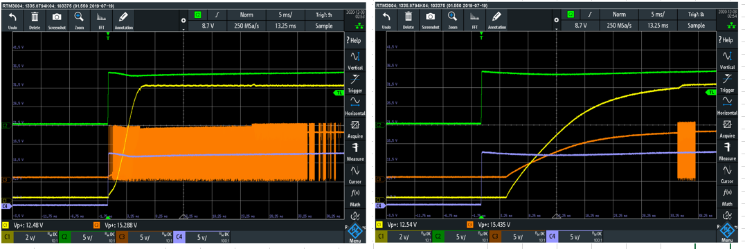

CH1 is VIN
CH4 is VOUT
I didn't see the non-smoothly Vout here. They are tested with EN resistor ?

Hi Young,
it's very difficult to capture the EN pin in this condition even used differential probe
but the symptom is quit similar, the VOUT (PVCC) will delay start up and ramp up slowly
since this case is urgent, may we off line discuss this case by phone call around noon?
Hi ,
The reason for the delay is because of internal current will charge EN pin cap till Enable threshold to get device enabled .
for the non-smoothly, it may related with the loading . We can communicate offline young-Zhao@ti.com
