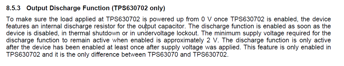

TPS63070 datasheet shows that TPS630702 has discharge function, how to apply? Is there have TPS630702 SCH? thanks in advance

The discharge function is automatically enabled after the device is disabled(enable then disable) or thermal shutdown or in under voltage lockout.
