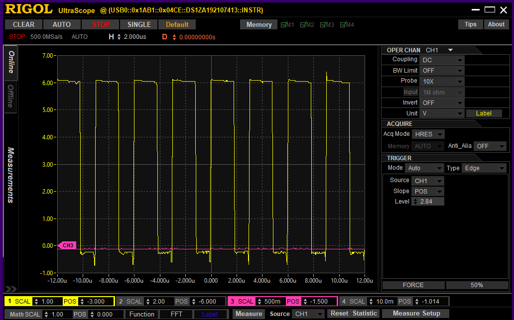

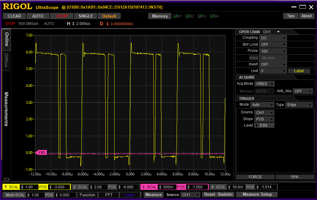

I am testing some issues with a design using the LM76002. The load regulation is not as good as it should be under certain operating conditions. The regulator is configured for Vout = 3.58V. I am finding that when Vin < 7V, and Iload in the range 400mA - 1A, the LM76002 switch node waveform changes behavior from a relatively steady 320kHz (the programmed switch frequency) to a pattern that I don't understand.. These observation are coincident with the observed degradation of load regulation so I believe these observations are related. If Vin is increased to 8V, then all of these issues disappear, and load regulation is very good across the Iload range 50mA - 1A, and switch frequency rreturns to a steady 320kHz. Also if Iload is reduced to below 400mA, then switch node waveform reverts to a steady 320kHz waveform. I have checked signals on all the pins of the LM76002 and I don't see anything unusual. PVIN looks steady, EN looks steady and well above the EN threshold, VCC (output of internal LDO) looks steady, CBOOT looks correct (always ~3V above switch node). I would appreciate if you could provide me some hints as to what maybe causing the above loss of load regulation (Vout drops by about 200mV)? Some things I note about the design (this is not my design) are that L seems a bit on the low side (10uH), feedback network resistors are quite high (RFBT = 1Mohm, RFBB - 402Kohm - I think the original designer was trying to achieve low quiescent current), CFB = 15pF. Please find attached a trace capture from the oscilloscope (yellow trace is the MOSFET switch node voltage) for Vin = 6V, Iload = 1A. Note that the switch node waveform seems to have very unsteady duty ratio pattern. Thank you, David

    Thanks for reply. A correction to my previous description; the oscilloscope trace is the LM76002 switch node waveform for condition Vin = 6V, Iload = 400mA (not 1A). Please find attached trace for switch node waveform for Vin = 6V, Iload = 200mA. The waveform shows the normal switching behavior that I expect.

    I tried adding more output capacitance. After adding 100uF (electrolytic type), I found that the issue went away with 400mA load applied, but returned when the load was increased to 800mA. At 800mA, I noticed that the duty ratio of the regulator switch waveform became unstable again for Vin = 6.0V, although load regulation didn't seem to be noticeably affected (load regulation was 3.580V +7mV/-50mV over the load range 0 - 1000mA). Prior to the change, load regulation was +8mV/-83mV. So the additional output capacitance has made some improvement. I will test the Cff change when next I get the opportunity.
