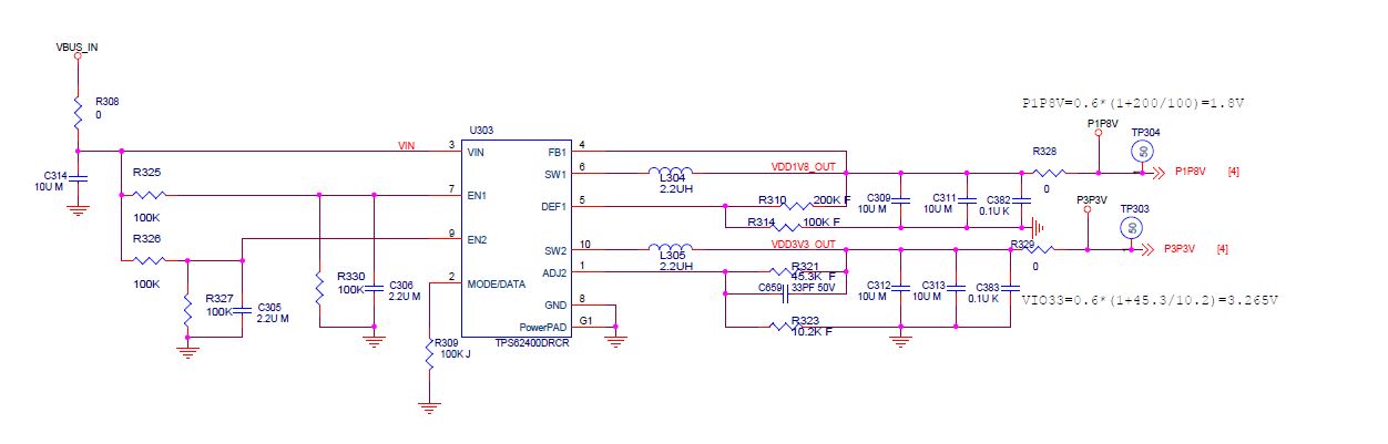

Hi team,
My customer is using TPS62400 for their power design. They have soft start requirement and the spec is 100ms and it is designed by RC time constant. They would like to consult you whether there is concern and suggestion about their circuit as below figure. Thanks.
