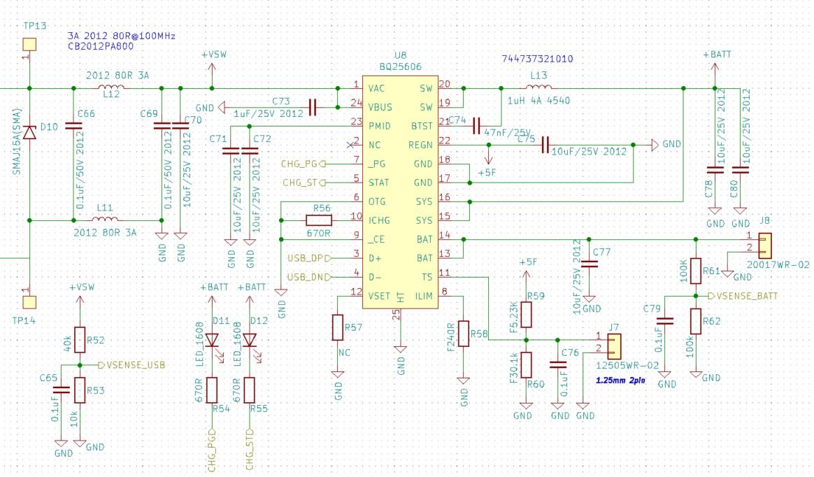

BQ25606: Precharge issue.
Part Number: BQ25606
Hi everyone!
I designed like a circuit.
Vin : 5V (USB)
Charging Currnet (ICHG)  : 1A  =K (Rset = 670R)
Input Current Limit : 1.99A (Rlim = 240R)
Battery : 4.2V 3000mAh.
When Battery is discharged about 2.615V, connect external power 5V USB type-C connector.
There is 3 states charging states.
1) 2.615 ~ about 3V : about 4~50mA constant charging  about 13 minutes . (No problem)
2) about 3V ~  about 3.23V
  - There is any Problem ! ! !
  - LED D12(STAT) is blink per 1 sec and takes 2 hours to exit this charging state.
※ Here I checked value
-  VBUS : 5.08V.
- VREGN : 5.08V (when fast charging 4.36V downed)
- VTS : 2..94V (I didn't use NTC, I used fixed resitor 10kOhms at J7 connector.)
 ==> Please suggest me where can I check it?
3) above 3.23V
 - charging 1A (No problem)
 - state led is no blink, no heat in pcb & battery.
