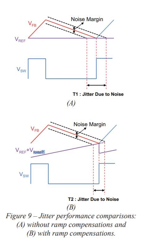

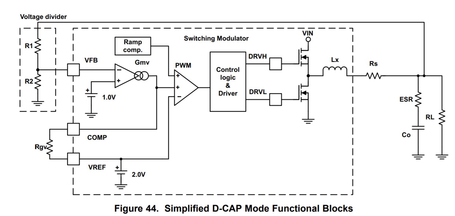

    Your understanding is correct. In D-CAP mode, the ramp comp is for reducing jitter. For the way it works, you can refer to the picture that I upload.
    In the block diagram, it can be seen that the Rcomp in D-CAP mode determines the gain of feedback inside the controller. With smaller Rcomp, the fb gain become smaller. And that increases the proportion of the ramp components in the comparator. Thus the jitter performance can get better with smaller Rcomp.

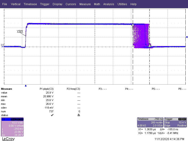

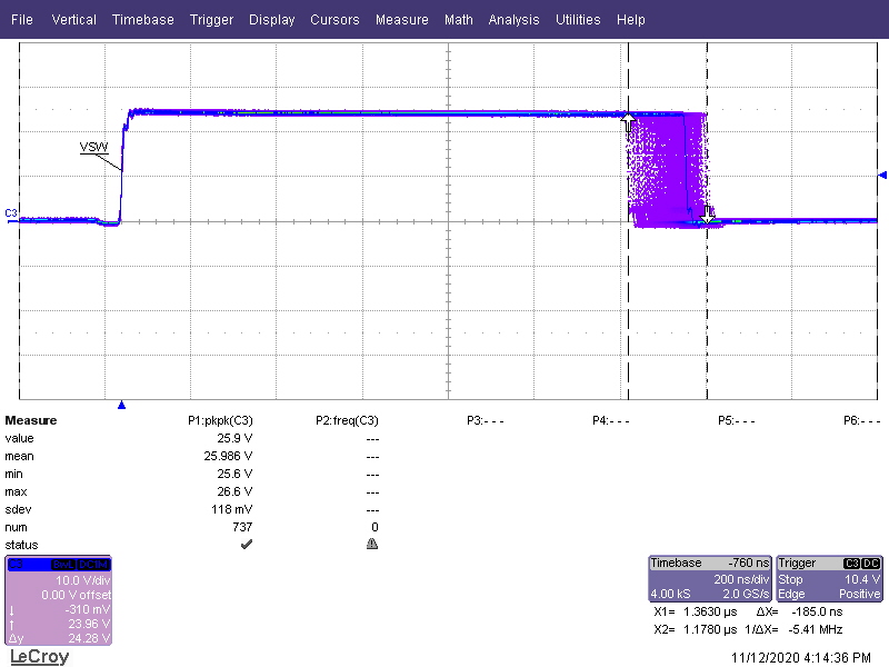

  • Hi Andrew,
    This is my Vsw waveform, I'm very confused, it looks not DCAP mode jitter.
    Bus for my controller setting, it set as DCAP mode.

    First, jitter does not represent small signal instability. In fact, jittering is a normal action of control loop against timing deviation caused by any accidental event such as noise, or the blanking time, adjusting back to the regulation point. A small amount of jittering does not harm the voltage regulation. For D-CAP mode control, since it's a hysteresis control and the time to start next switching period is determined by the time when VFB=Vref, so some noise on FB will have influence and causes the jitter.
    For the methods to reduce the jitter, I want to check that if the waveform is tested with 10kohm "Rcomp"? If yes, you can solder down the parallel cap and change the resistance to 6kohm. Also can you capture and share the waveform on FB pin? Too small ripple on FB pin will cause large jitter.
