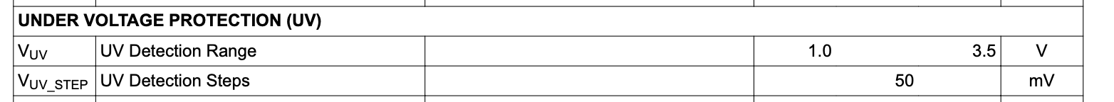

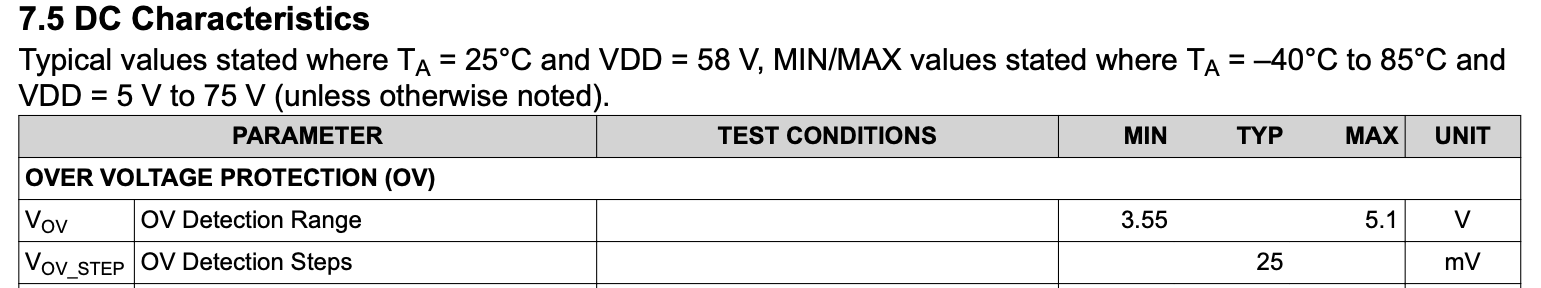

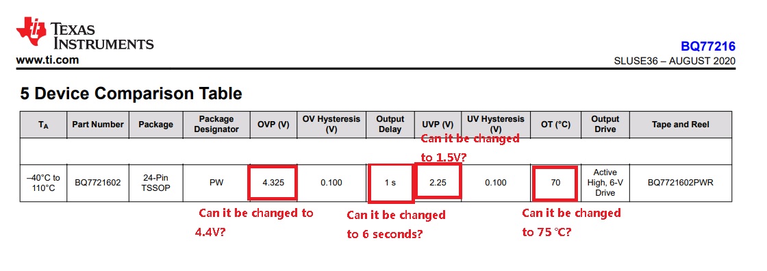

Hi TI experts,
         Considering that we use three terminal fuse, it can't be recovered after burning. So I hope that some parameters can be changed to reduce the chance of burning fuse.
  • hi Mr Yang,

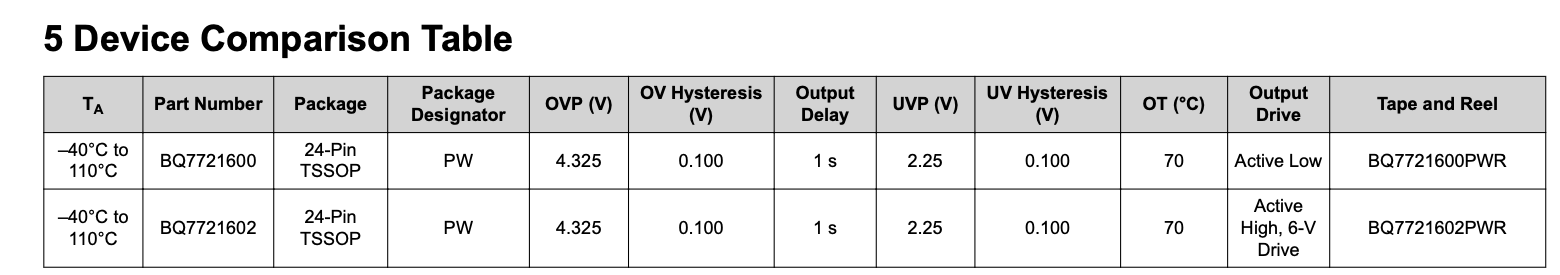

    BQ77216 has to be programmed by TI at a TI factory. We have for the time being two versions of BQ77216 which are available to customers.

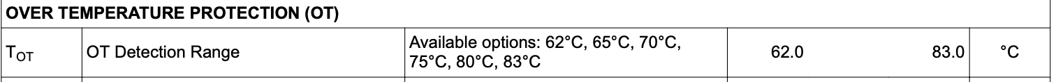

    BQ77216 design support the OVP value, the UVP value and the OT(oC) value you entered as you can see with the following extracts from the BQ77216 datasheet.
    The output delay of 6s is not support though.
    The values you mentioned would require a new spin of BQ77216. Please reach out to your TI Sales representative so that we can discuss about the conditions for creating such a new spin.
