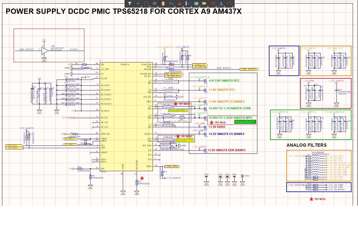

I have a design with TPS65218. I´m making tests for changing this component for the new recommended reference TPS65218D0, but I have found a problem.
When I have little dips in power supply or make a star-up ramp in power supply (EN 61000-4-11)  the Am437x microprocessor doesn´t start. But with the previsious reference, without D0, I don´t have any problem.
For example, if we power up in steps , for example, 0.4 v, many times the PMIC doesn´t start correctly. But the oldest reference, without D0, works good.
The schematic is :

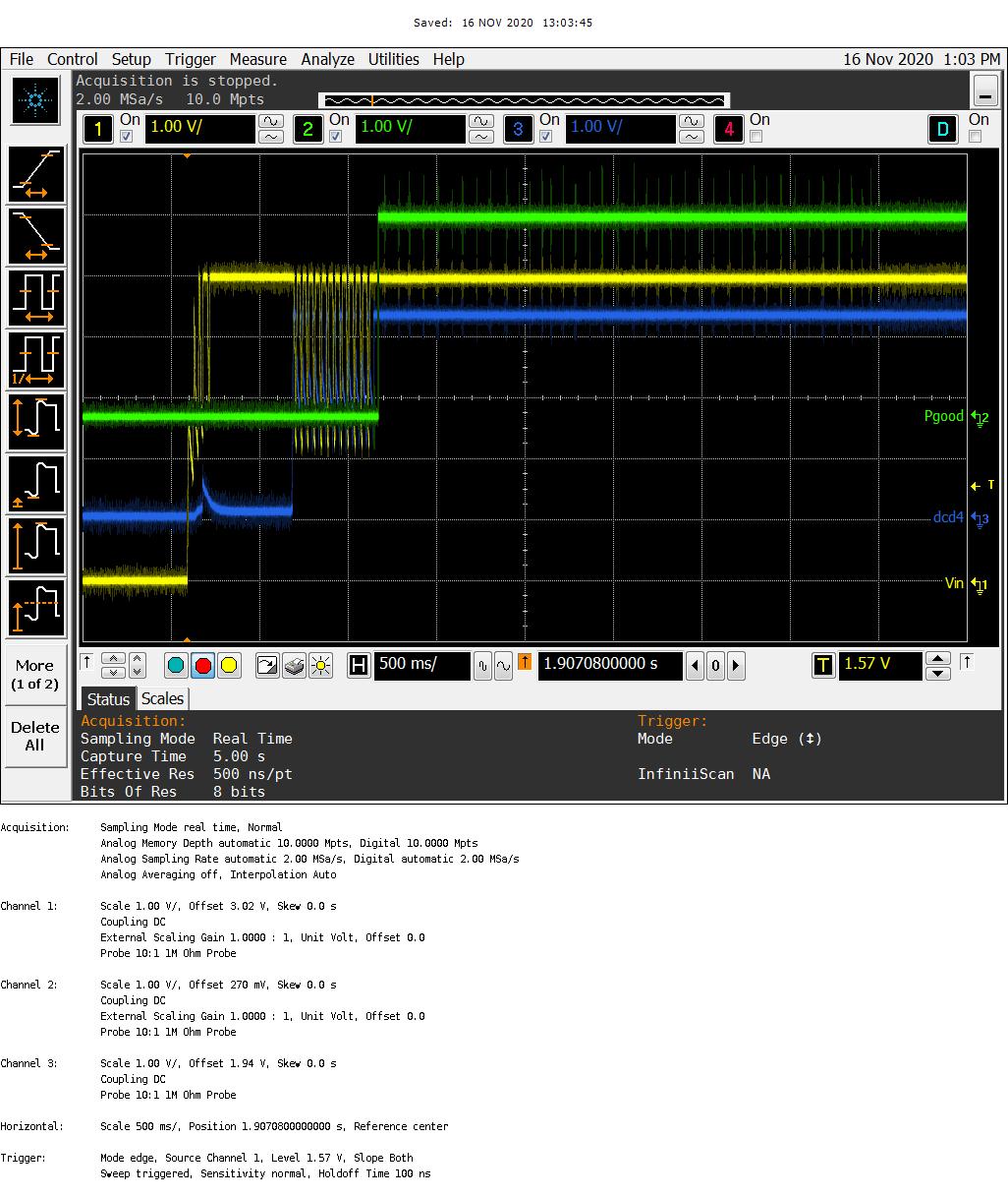

    Can you measure the input voltage (VIN), DCDC4 output, and PGOOD signal to see if PGOOD ever goes high? If not, I expect it is because DCDC4 does not ramp up to the expected voltage within the correct timing during start-up.
  • Vin has an strange waveform because the power supply is starting with step ups. Remember that the problema appears with this type of starting. During a time the power supply doesn´t work properly
  • The problem, in my opinion, is that you are using DCDC5/6 but you have CC pin connected to GND.
    If you are using DCDC5/6, then there should be an evenly-matched resistor divider from VIN (5V) to CC (R1 = R2 = 10k). Then you need to "break the factory seal" by setting FSEAL=1b according to the datasheet. Personally, I disagree with the wiring in section 6.1.1 Applications Without Backup Battery of the datasheet and I think it is the cause of your issue. Power supplies that are hovering around multiple UVLO thresholds during a "brownout" always seem to cause issues in my experience. Connecting a "fake" battery to the CC pin allows the part to transition over to the backup supply as it was intended to do and then return to normal operation when the power supply stabilizes.
    If you are not using DCDC5/6, the whole subsystem should be terminated according to the datasheet in 6.1.2 Applications Without Battery Backup Supplies which is a reliable solution. In this case, you would use an alternate wiring for powering the RTC domain with LDO1 as shown below:
    Or you could disable the RTC system of the processor completely.
