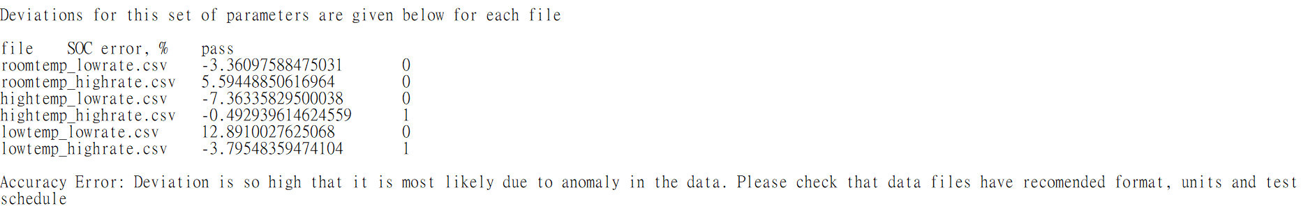

Would you please help to check why the CEDV deviation is so high?

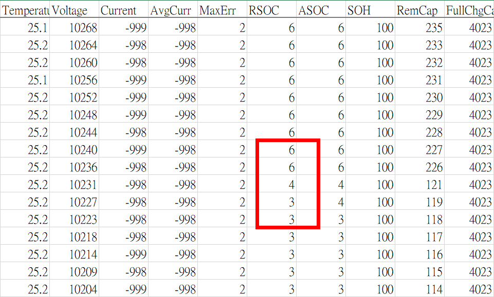

1. Chemistry is LCO, Graphite. High current charge design, low internal resistance

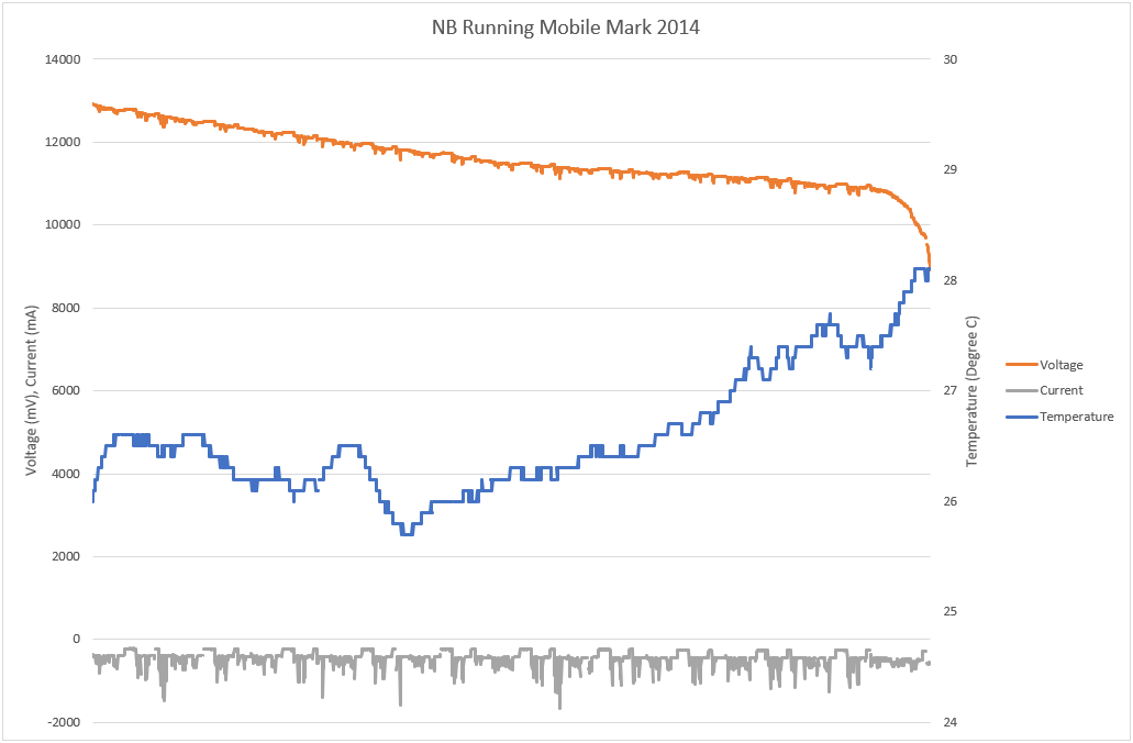

2. Do you think the error data is temperature behavior?
if yes, I put battery in Notebook computer and run a light load app @room temperature
the temperature behavior is very similar to CEDV log. discharge current around 400mA and Battery is 4000mAh 3S1P
If the error is not temperature, I can't figure out the problem, so ask for help here
I do follow the procedure of sluub45b
