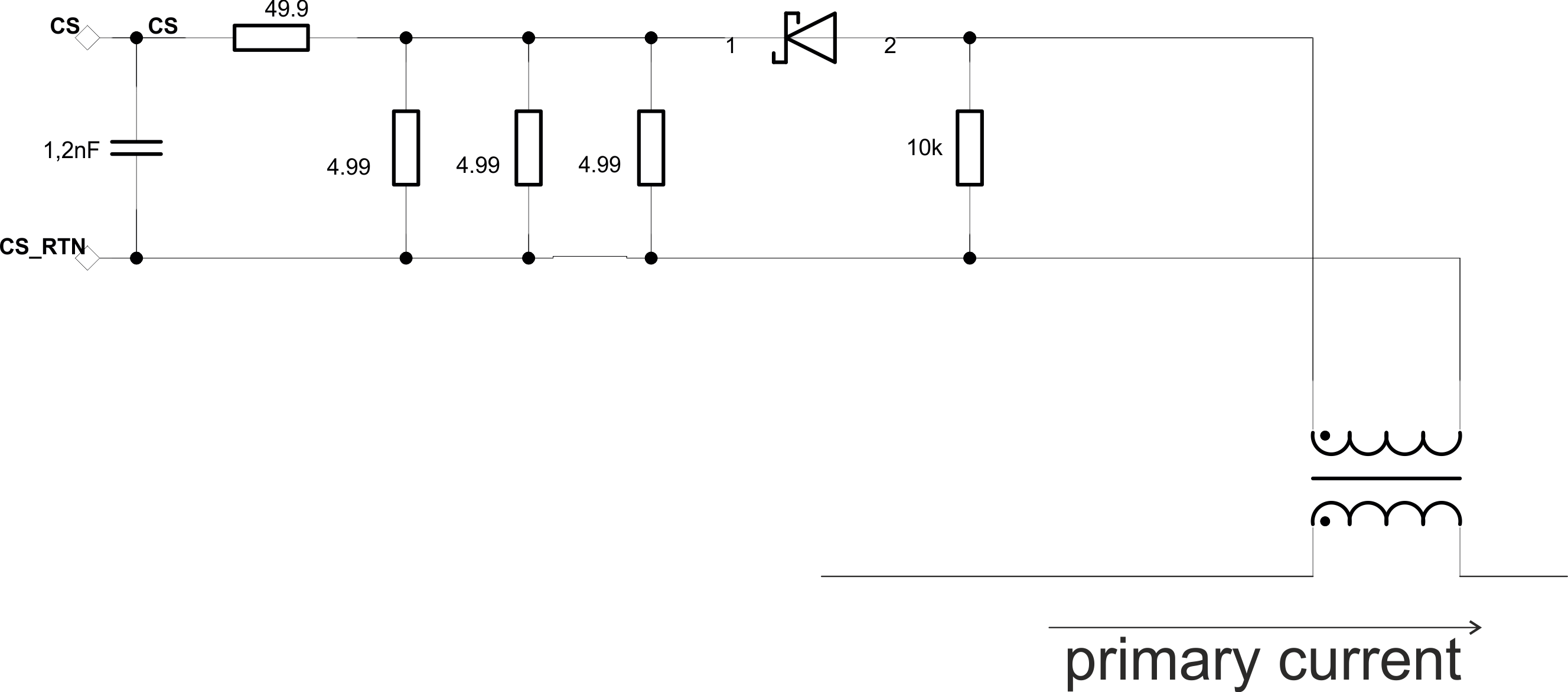

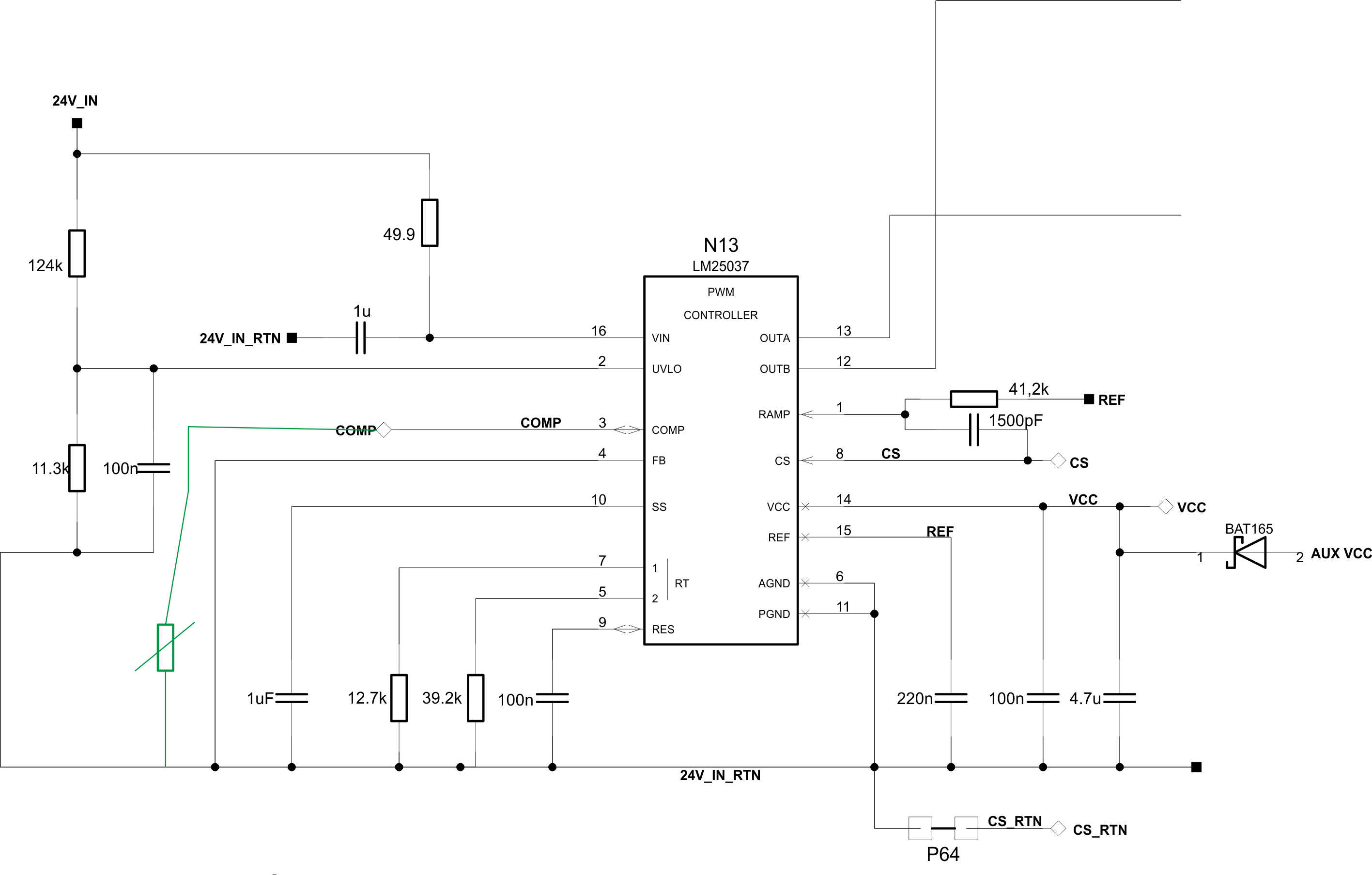

I am currently working with the LM25037 as a PWM controller in current mode in a push pull design, around 24V input / 15V output.
I attached the circuit of the LM25037.
Current sensing is made by a primary current sense transformer, feedback is made by an isolated error amplifier.

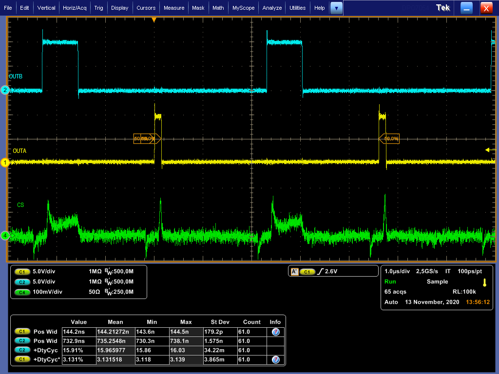

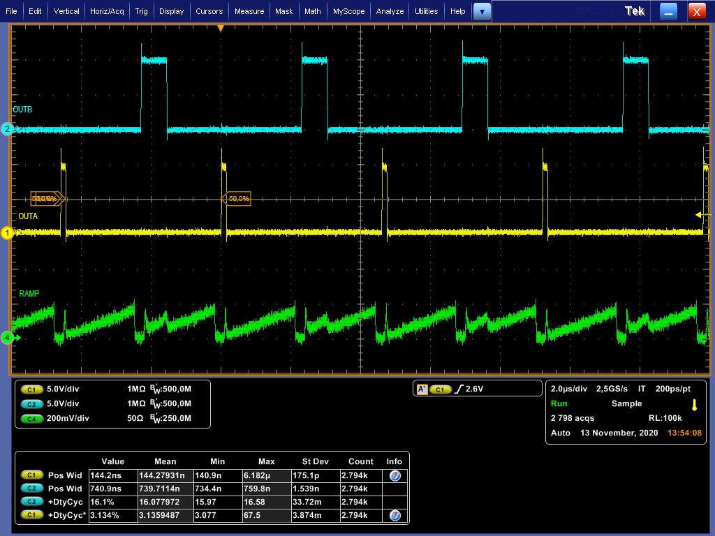

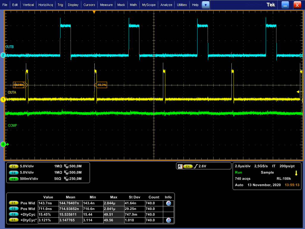

I recognized the problem that the pulse width of the OUTA and OUTB drive pulses is not equal in length. At lower loads the problem is increasing (as shown in the attached screenshots), with higher loads the problem gets better, but the difference doesnt disappear.

At the moment I disconnected the isolated error amplifier from the COMP pin and connected a potentiometer to the COMP pin to adjust the output voltage manually. The problem stll persists. At the beginning I had RAMP connected to REF via 165k and to CS via 470pF (wasnt better).
Could you tell me, what could cause the LM25037 to vary the pulse widths of OUTA and OUTB?
I attached several measurements of CS, RAMP and COMP pin.
