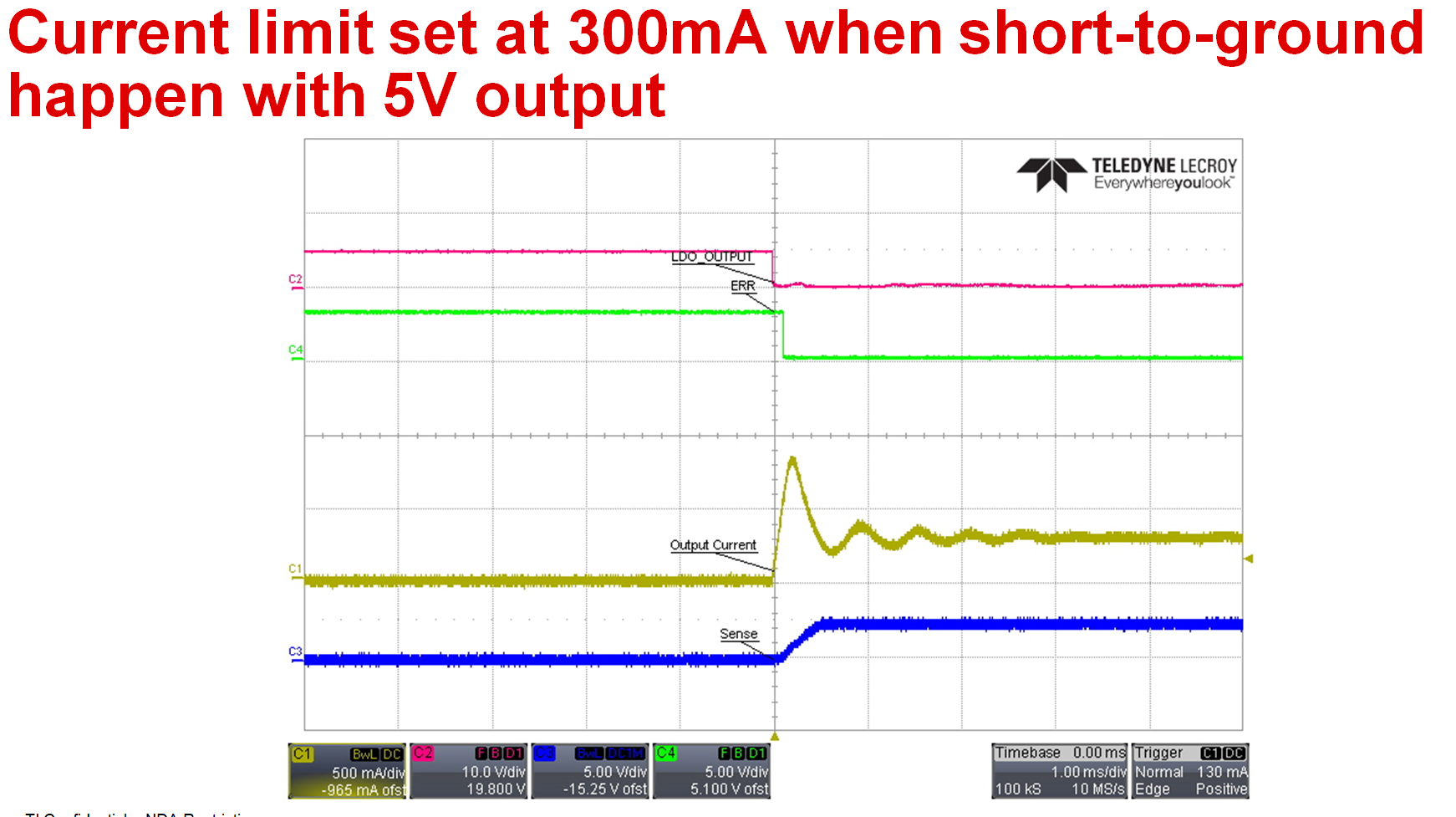

TPS7B7702-Q1: the duration time of the inrush current
Part Number: TPS7B7702-Q1
Dear team,
After enabling 7B7702, there will be an 500mA inrush current due to output capacitor. If the duration time of this inrush current is smaller than 16ms, the device won't report OCT fault, right? How much inrush current will damage our chip?
