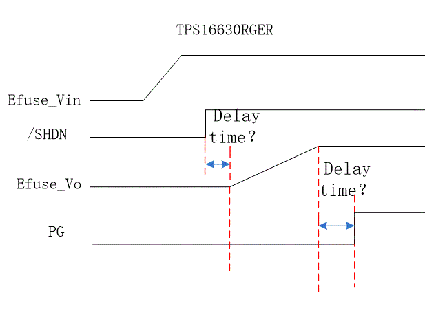

Regarding TPS16630RGER Efuse, as shown in the figure below, customer are asking:
Question 1. What is the time interval between SHDN valid and Efuse start to output? Please give the Min, Typ and Max values of the delay time
Question 2. What is the time interval between Efuse rising to Vin and PG signal valid in ms? Please give the Min, Typ and Max values of the delay time
do we have these detail spec?
  • Hi Zhang,
    It is same as "UVLO switch turnon delay". The typical value (us) is 742 + 49.5 x C(dVdT) where C(dVdT) is in nF. We don't have min and max values for this parameter.
    It is tPGOODR parameter in the EC table. min = 8ms, typ = 11.5ms, max =13ms
    Best Regards, Rakesh

  • Hi Rakesh,
    Thanks, customer just need a conservative spec. And they said they need it Monday next week.
    Could you give a spec(ensure system can work normally in this range is enough ) Monday next week?
  • Hi Zhang,
    OK. Let me check.
  • Hi Zhang,
    The typical value of "UVLO switch turnon delay" in us is 742 + 49.5 x C(dVdT) where C(dVdT) is in nF.
    From simulations, the min value of "UVLO switch turnon delay" in us is 570 + 49.5 x C(dVdT)  and the max value of "UVLO switch turnon delay" in us is 930 + 49.5 x C(dVdT)
