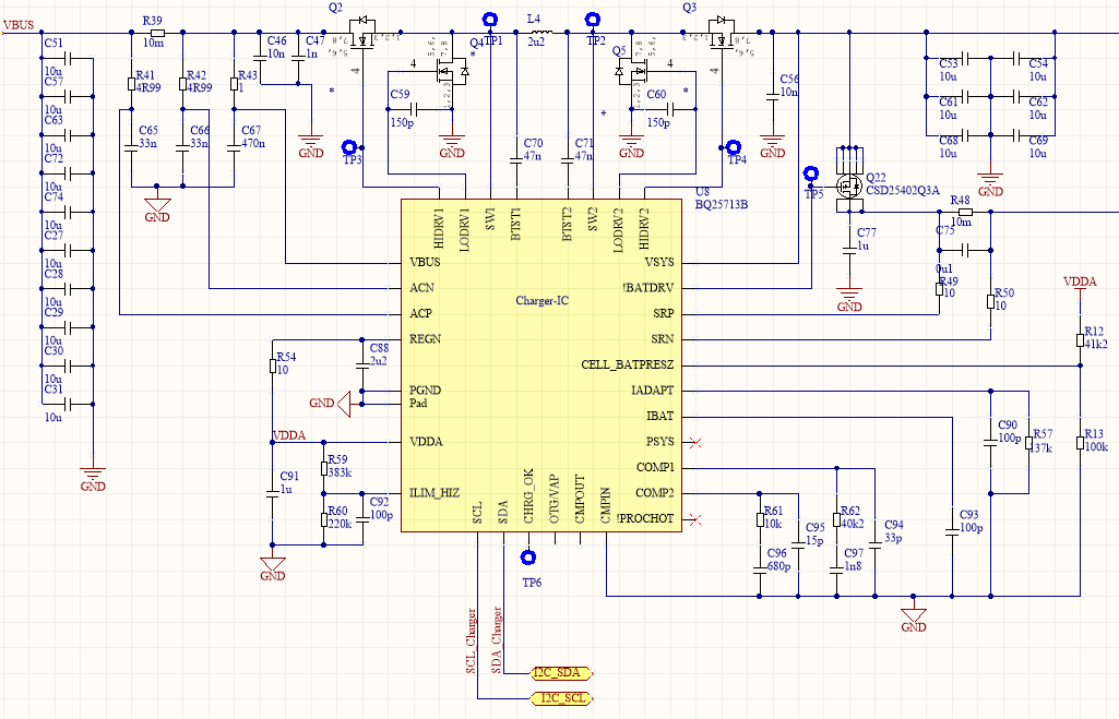

we´ve made a new board design, which is related to the BQ25713EVM-017 Ref.Design.
Our Input-Voltage Range is ether 5 or 20 V according to USB-C standard.
Unfortunaly, the device doesn´t power up from DC-Source and starts converting.
REGN and VDDA voltages are checked and ok and the CHARGE_OK Indicator is high, too.
But  there is no switching of the Hi- or Lo Drive FETS and the Output Voltage (VSYS) is only about 2.2 volts.
It´s the same behavior at Eval-Board BQ25713EVM-017 with Jumper 6 is set. But in our design, it shouldn´t be set.
Can you please check our schematic.
Are there any other things, that we can check?

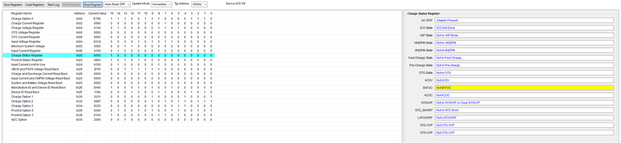

       Can you check if you have tripped the SYS_SHORT fault? You can check the chargestatus register to verify. Please also verify voltage on ILIM_HIz pin.

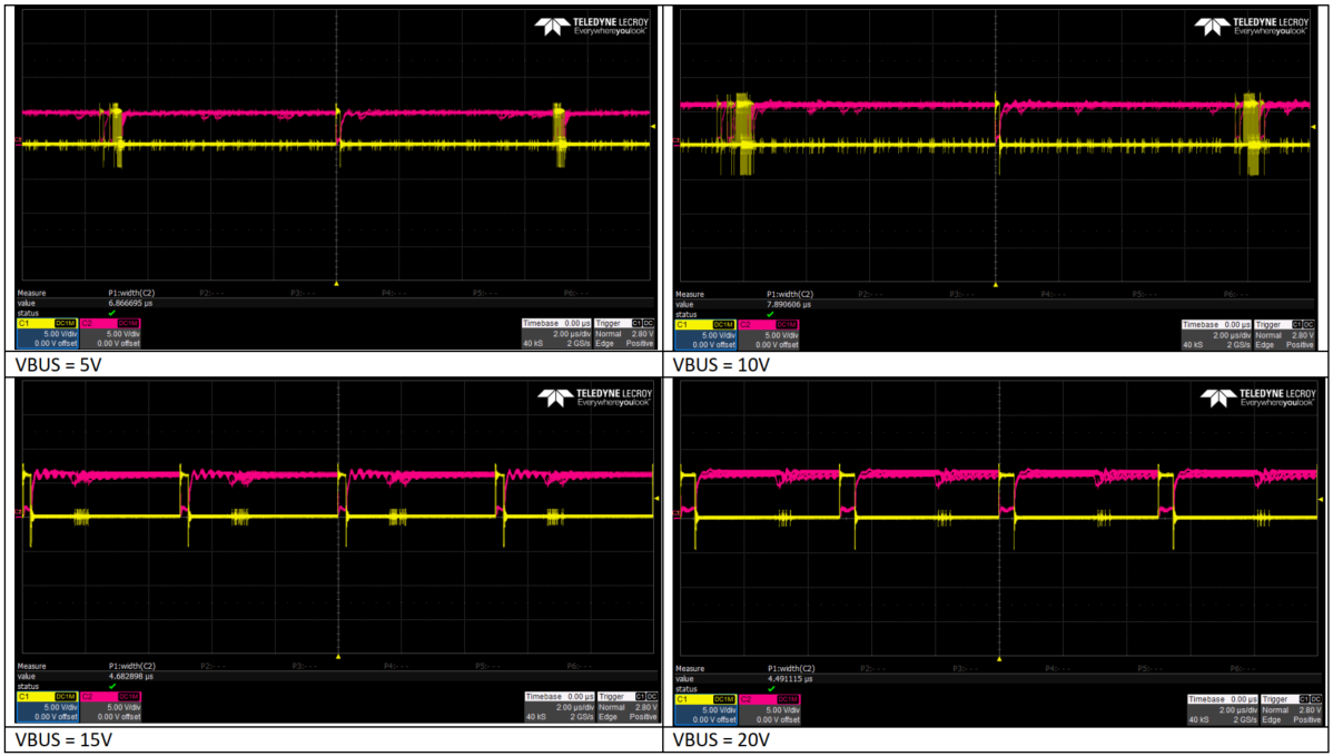

    As a supplement, here are the signals of HIDRIVE1 (red curve) and LODRIVE1 (yellow curve) for different voltages at VBUS.
    The voltages at ILIM_HIZ-Pin are:
    2.6 V @ VBus = 5V
    2.9 V @ VBus > 6V
    I´ll check the chargestatus register.
    Kind Regards, André

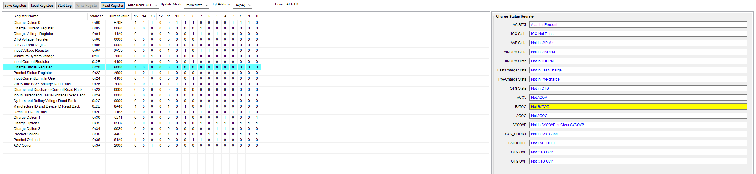

  • Hi Kedar,
    thanks for your help! Here is the missing information about the chargestastus register.
    It's the same as the eval board and I can't see any unusual.
    best regards
  • Hi Trix,
       The watchdog timer is set for 175 seconds. This needs to be disabled as otherwise it will reset to the default value every 175 seconds, and default value of charge current is 0A, which is a charge disable scenario. You can find this in the ChargeOption0.

    Is the charger circuit very sensitive to applied layout? Should the Charger-Pins SW1 SW2 connected with a polygon or is a small track enough?
    Finally, we assembled only the charger-part (parts of schematic of origin post) and no other components, and charger shows in Sys-Short fault every time.
    From showing Sys-Short-Fault, there is no signal at the gates of switching FETs.
    Can there be any other reasons for showing this fault? There is no short at VSYS or VBAT.
    Regards, Andre

    As this is a charge controller, layout plays a huge factor. Minimize the copper area of this trace to lower electrical and magnetic field radiation but make the trace wide enough to carry the charging current. Do not use multiple layers in parallel for this connection. Minimize parasitic capacitance from this area to any other trace or plane.
    A thin trace will not be able to carry the full charge current, as this is part of the high current carrying path.
