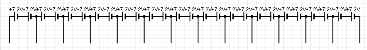

Can BQ76PL455A be configured to support NiMH battery individual cells(block consisting of cells) at 14.4V nominal voltage each with total battery pack voltage of 201.6V as shown in figure below?
Vadym
Vadym
Hi Vadym,
I think this question was addressed in the other thread - the abs max rating of Vsense pins in 455 datasheet is 6.5V so this cell configuration would cause an issue for this device.
