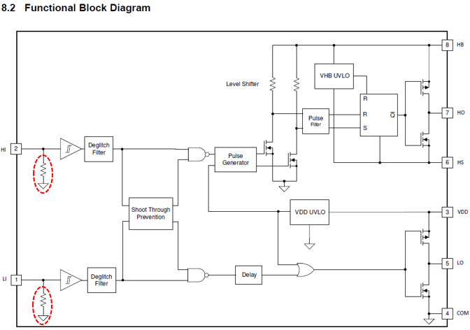

Hi team,
Could you tell me the pull-down resistance of input pin?

Hello Nishimura,
The input pin pull down resistance on the UCC27712 is 400k ohms typical value.
Confirm if this addresses your question, or you can post additional questions on this thread.

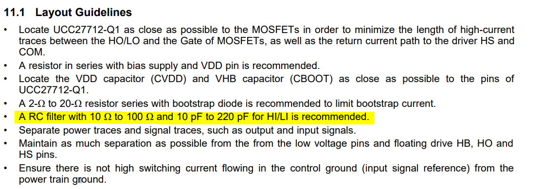

Hello Nishimura,
In the UCC27712 datasheet section 7.3.3 (input stage) there is some guidance and description of the input stage and recommended filter ranges. In general it is recommended to have fast rise and fall times on the driver inputs to avoid multiple triggering on slow input signals. The input filter time constant is recommended to be 20ns or less for reasonable rise and fall times on the driver input pins.
