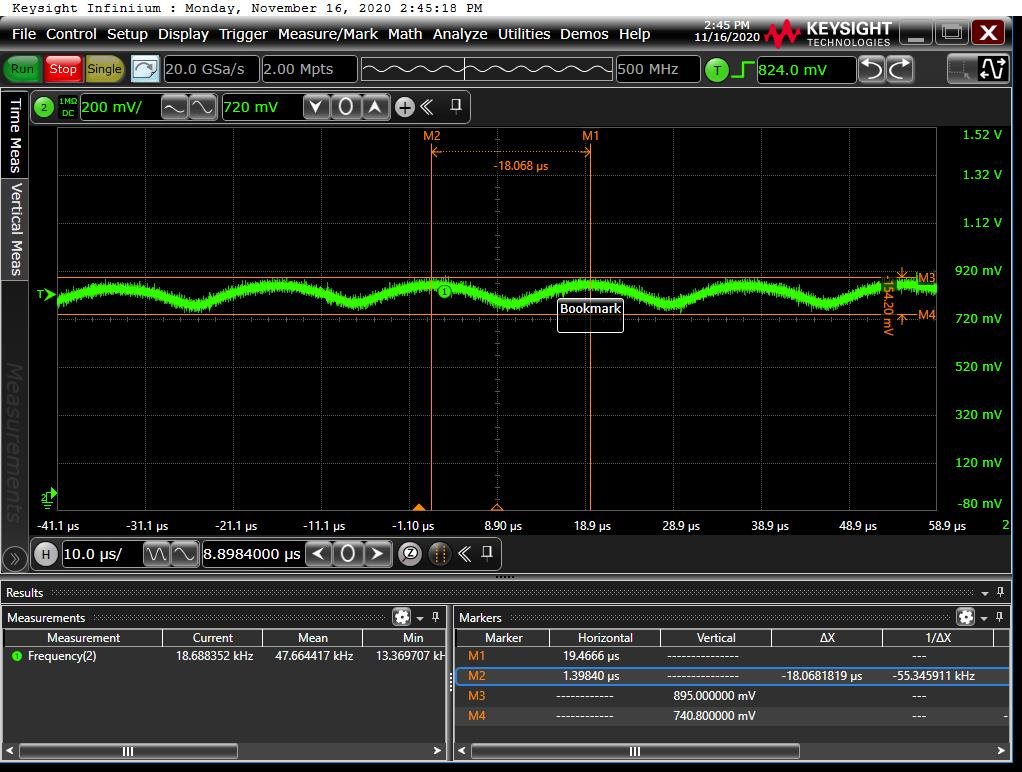

the Vout is not a fixed value, it has a 56KHZ 150+mV ripple。like as this:

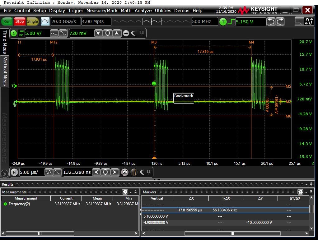

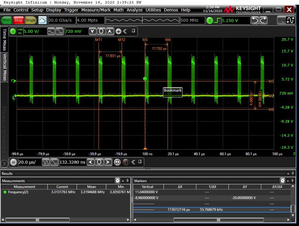

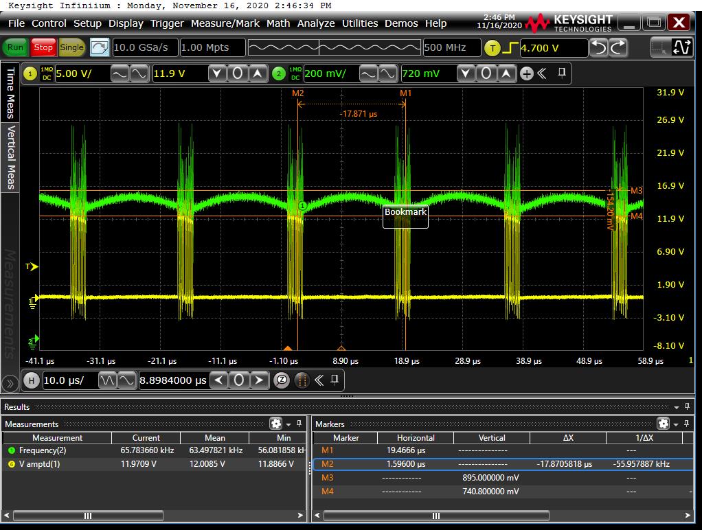

I found this ripple signal follow the PWM signal, the PWM signal is not a continued singal,it is about 56KHZ on and off。that cause the VOUT have 56KHZ 150mv ripple.
So,why the PWM signal is 56KHZ frequency ON/OFF?

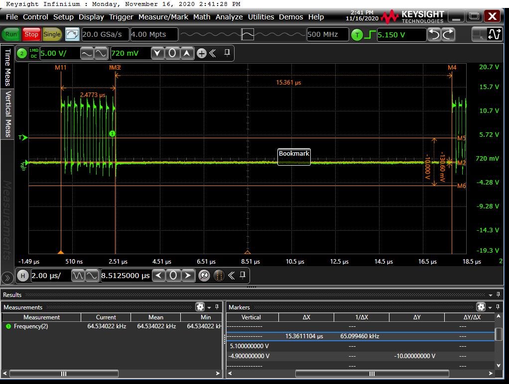

    It is likely that the 56kHz ripple is caused by additional phase-lag from the power-path signal from the output of the TPS544B20 local to the inductor, and the sensed output at the MEM_VDD_0V85_VSENSE_GPU_P and this additional lag is causing the loop to become unstable at 56kHz.
    If you look at the output voltage waveform, the output voltage is dropping through almost all of the PWM pulses, as the inductor builds up energy over 2.5us, then once the energy is built up, switching stops and the output continues to rise for almost another 8us without switching, then the process repeats.  It is taking power path 2.5-3us for the sensed output voltage to reflect the energy delivered in the PWM pulses, and that lag is causing the TPS544B20 to deliver excess energy, which is then bled off.

  • I had solved the issue,change the Mode from D-CAP to D-CAP2,connect the MODE pin to PIN27(BP3), for the CAPs have little ESR。
    if use D-CAP mode,the COT system maybe not stable.
    Yes, without the internal ramp, the loop is not stable with just the ESR of the all ceramic output capacitors.
