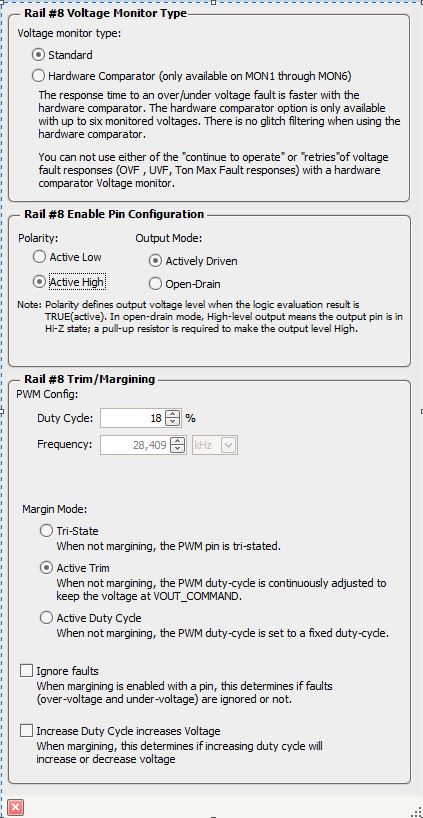

Two pins of the UCD9090 are PWM pins (pins 22 and 23) which I want to use for margining/trimming (all FPWM pins are already in use for other supplies). In the Fusion Digital power designer under hardware configuration it is possible to configure the duty cycle but not the frequency, this is grayed out (see attached picture). How can I configure the frequency and set it to for example 28204 Hz? It is now only 980 Hz. I have attached the window of Fusion for configuring the margining. Configuring the frequency for the FPWM pins no problem, the frequency is not grayed and can be set to, in my case, to 7.272727MHz.
Thanks for any suggestions, Robert.

  • Hi Yihe,
    Thanks for your reply. Yes, I have seen in the datasheet that the PWM1 and PWM2 frequencies are fixed. In an other project we use the same sequencer. Strange enough here are the frequencies for PWM1 and PWM2 set to 28.409kHz (but also grayed out). See picture below. Because this programming of the sequencer was made several years ago I can not recall anymore how we managed this. Is there maybe a main clock frequency which I can set what makes this higher PWM frequency at the end?
    Thanks for your support,
    Robert.

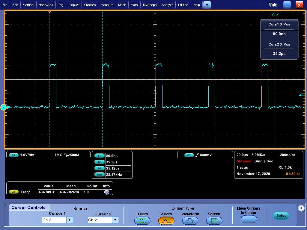

  • Hi Yihe,
    Attached the project file. Also attached a measurement done on a scoop for PWM1. PWM2 has the same output.
    Robert.

  • Hello
    Thank you very much for the project file and waveform. It is a mistake of the data sheet.
    For both UCD9090 and UCD9090A, PWM1 and PWM2 frequencies can be 1Hz to 7.8125 MHz.
    We will update both GUI and data sheet to address this issue.
