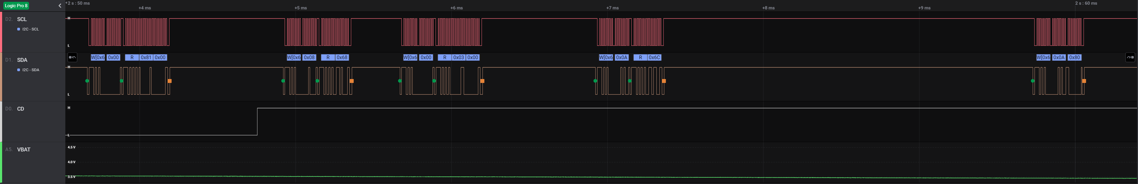

What is the expected behavior of the BQ25121A when the battery is disconnected, but an input charging voltage is supplied? I would expect that the Battery UVLO fault would trigger, but on our hardware we see the battery voltage jumping between 96-98% and no faults. Is there a recommend way to detect battery disconnection?

    That is because the capacitor on the BAT pin is getting charged and discharged from the battery regulation voltage to thee battery recharge threshold.
    You can either disable charge through I2C or set /CD high. This will let you know when the battery is absent and show the BUVLO fault.
  • I set the /CD pin high while reading the STATUS, FAULT, and performing the battery voltage sample/read procedure. Unfortunately this had identical results where the the BUVLO fault was not set and the battery voltage. How long will I need to hold /CD high before the BQ25121A reacts?
    Below is a capture of the I2C, /CD, and Battery Voltage lines at two different time scales.
    You have to hold /CD high and hold for a few ms to see the BUVLO. The capacitor on the battery pin will also need to be discharged.
