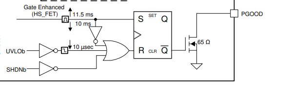

My customer is evaluating the TPS16632.
They are testing "output short to GND", however, /FLT is not asserted as the following attached file;
TPS16632 short.xls
I think that this behavior is the same as the following waveform.
How should we do to assert /FLT immediately after output short to GND condition?
