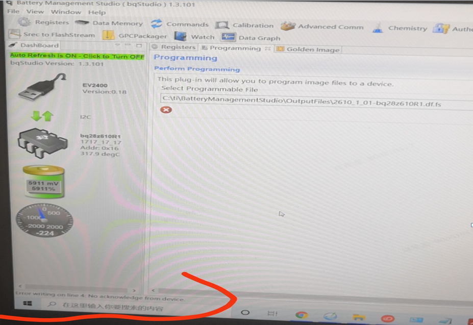

  My customer used BQstudio 1.3.101 to programming BQ28Z610-R1 device,  which used .srec could be programmed well which cost >40s, so for saving the time, my customer tried to use program DFFS file, but reported an critical issue:"Error writing on line 4: No Acknowledge from device".

  • Hi Keller,
      The connect is correct as BQstudio could program .srec to device correctly, but cost >40S,  and used the configure file which download from the website:
      and the version & error information reported as below figure.

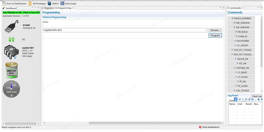

  • Hi Keller,
       Update with errors as below figure.
       Also could you kindly share your comments on how to read the version?  my understanding is that the version is 2610_1_01 like below figure.
  • Hello Benjamin,
    Make sure the gauge is in firmware mode (responding on 0xAA) I see in one of the pictures it is in ROM mode.
    The firmware version from the df.fs file most likely do not match the gauge you are trying to flash it to, make sure they use the same firmware before flashing.

  • Hello Benjamin,
    The df.fs files only contain the data flash (DF) so the gauges MUST be the same firmware version, the .srec file is recommended to update firmware with data flash.
    The gauge should be in firmware mode and the DF configured how you want it, then you pull the .srec using bqStudio firmware tab, then use the srec to flash stream tab to convert it to a df.fs file. now it can be programmed using the programming tab.
    It is only for the bq28z610-R1 that has the .srec to df.fs feature in bqstudio.
