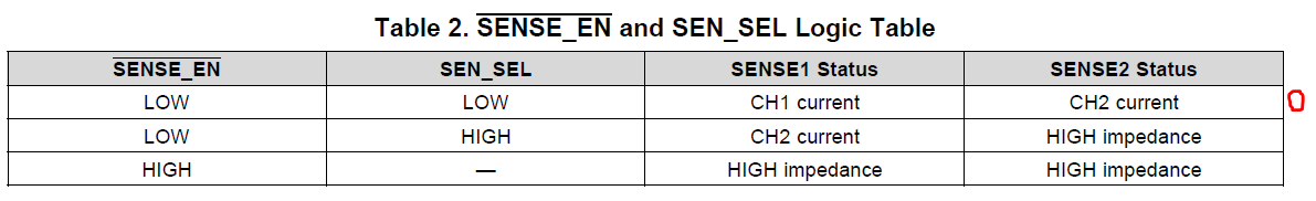

Customer will set the /SENSE_EN=SEN_SEL=Lo.
The SENSE1 is connected with MCU ADC, The SENSE2 is also connected with MCU ADC. The /ERR pin is connected with GPIO of MCU.

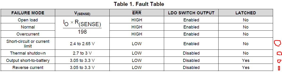

Q3. Regarding with SENSE1, SENSE2 behavior, is below understanding correct?
Short circuit or current limit : Only the correspond SENSE pin output 2.4-2.65V. (For example, if CH1 is short circuit, CH2 is normal, only SENSE1 output 2.4-2.65V)
Thermal shutdown : Both SENSE1 and SENSE2 output 2.7-3V.
Output short to battery : Only the correspond SENSE pin output 3.05-3.3V.
Reverse current : Only the correspond SENSE pin output 3.05-3.3V.
    --Yes, SENSE pins are independent.
    --Yes. The thermal shutdown will turning on and off both channels at the same time.
    --Yes.
    --Yes.
