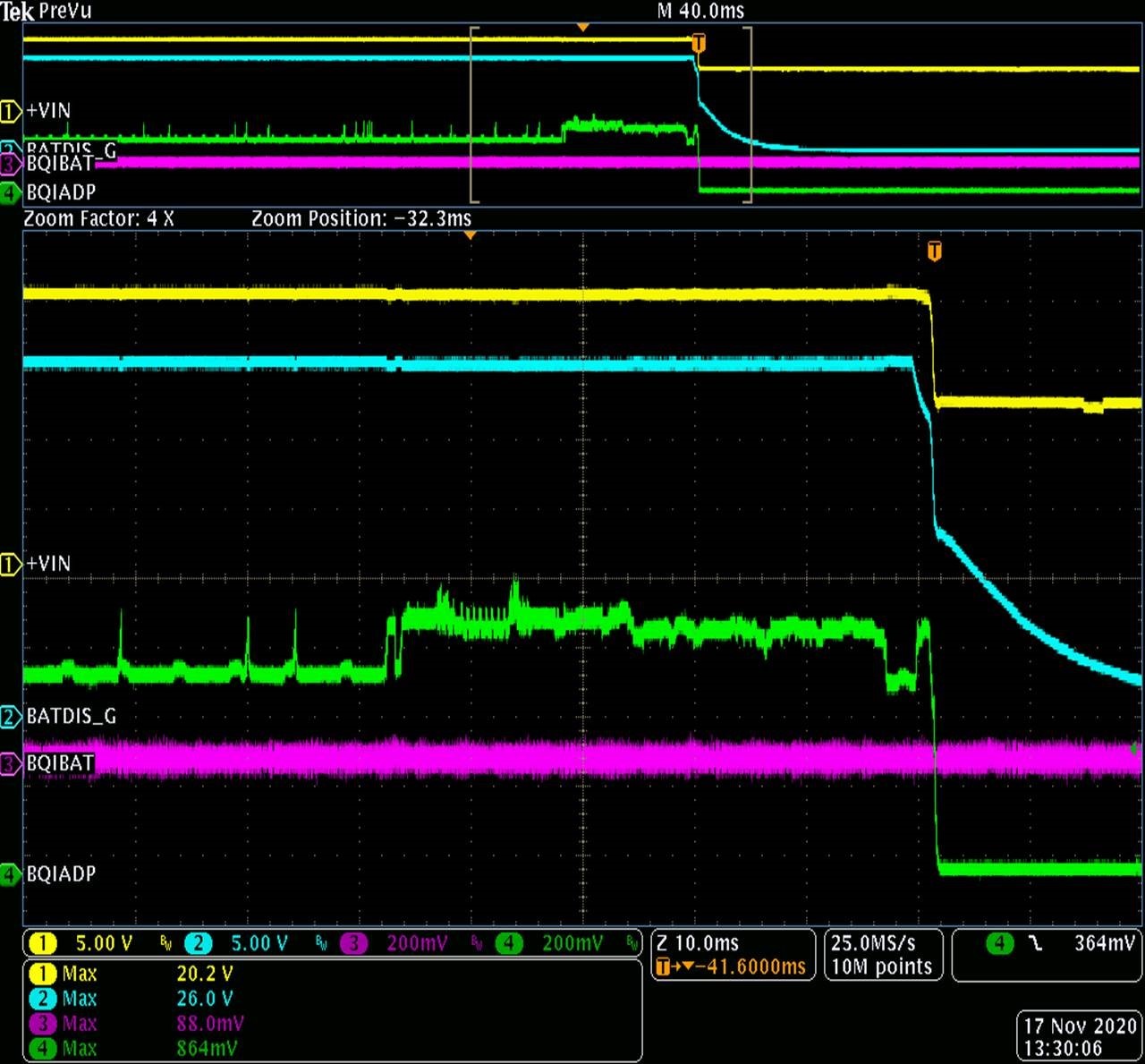

This is a NB product using BQ24781 as the charger IC.  The issue is about an unexpected ACDRV drop when the system side consume a heavy loading (170W/8.7A).  Please check the waveform as below at the moment when ACDRV drop to open the MOSFET.
CH1: +VIN is the system voltage
CH2:  BATDIS_G is ACDRV
CH3:  BQIBAT is IDCHG
CH4: BQIADP is IADP
At this moment, ACOK keeps high.  We're currently checking if LEARN mode is enabled or not.  Please suggest what else we should check to clarify this.  THanks!
