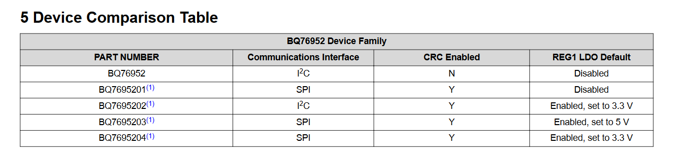

I need some clarification regarding BQ76952 variants as mentioned in Datasheet:
Are there any more differences between these variants and How can I order samples of these variants??

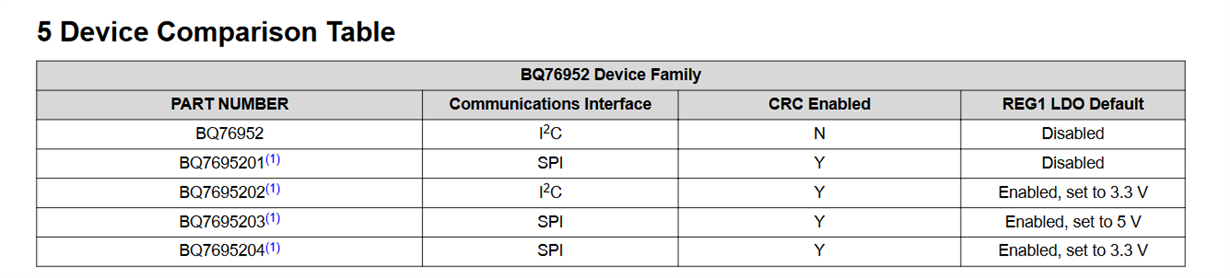

  • hi Anurag,
    The only differences between these devices are the ones highlighted in the Device Comparison Table of the BQ76952 datasheet.
    The devices with a (1) are in product preview and will be released on ti.com early 1Q21.
    You can certainly replace the early version PBQ76952 with a final BQ76952 IC on the EVM you have.
