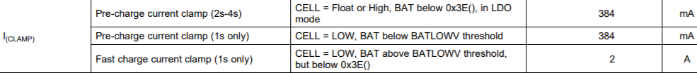

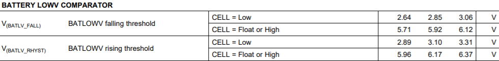

    • I think there's a bit of a misunderstanding here. The /BATPRES pin is not connected directly to VBAT. Some battery packs have an output pin which can be conveniently connected to /BATPRES on the BQ24773. When the battery pack is plugged in, this pulls the /BATPRES pin low, which indicates to the BQ24773 that the battery is present. If you are not using the /BATPRES functionality, then you should tie the /BATPRES pin to GND.
    • The /BATPRES pin is used to detect battery removal (/BATPRES low to high transition). The /BATPRES low to high threshold is about 2.2 V, as shown below. When the /BATPRES pin is pulled high, the BQ24773 disables charge, exits LEARN mode, and resets the MaxChargeVoltage() and ChargeCurrent() registers. However, the host MCU can still re-enable charge by reconfiguring the registers, even with /BATPRES high.
    • When VBAT is low (VBAT < BATLOWV for 1s charging, or VBAT < MinSystemVoltage() for 2s-4s charging), the BQ24773 can still charge the battery in pre-charge mode. In this state, the charge current is clamped below 384 mA. Here are the relevant portions of the EC table which show the thresholds:
