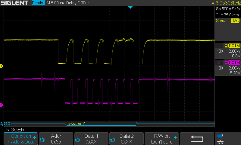

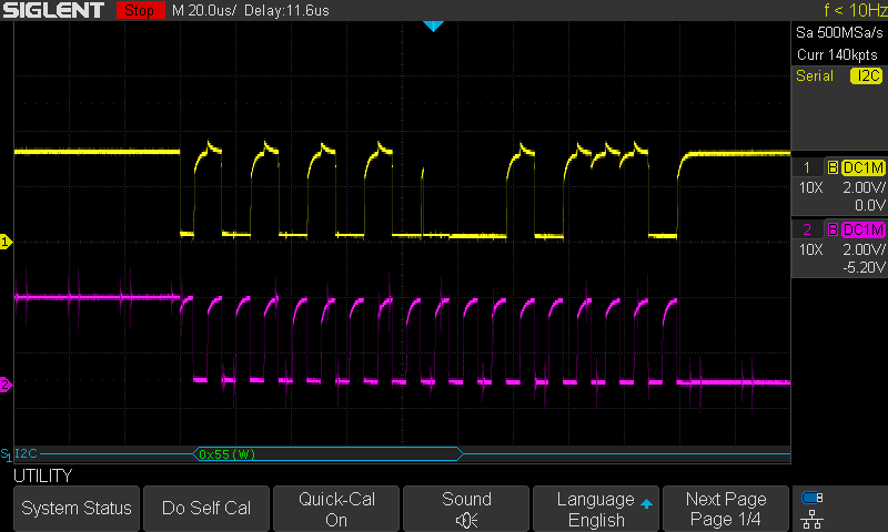

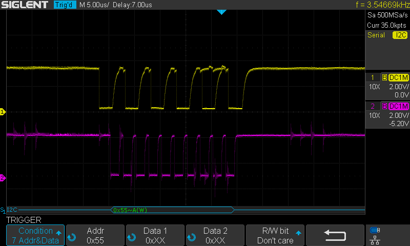

    Well, I'm not getting anywhere.  I'm attaching some scope shots.  This is with the EV2400 and BQ Studio which works.
    This is from my Linux host which does not.  Clock is 400 KHz, but that should not make a difference.

  • Hello Paul,
    If you are using 400kHz you will need to set in the gauge configuration, by default the gauge is set to 100kHz communication.
    It looks like your host clock lines are running at some duty cycle other than 50% which may be causing issues.
