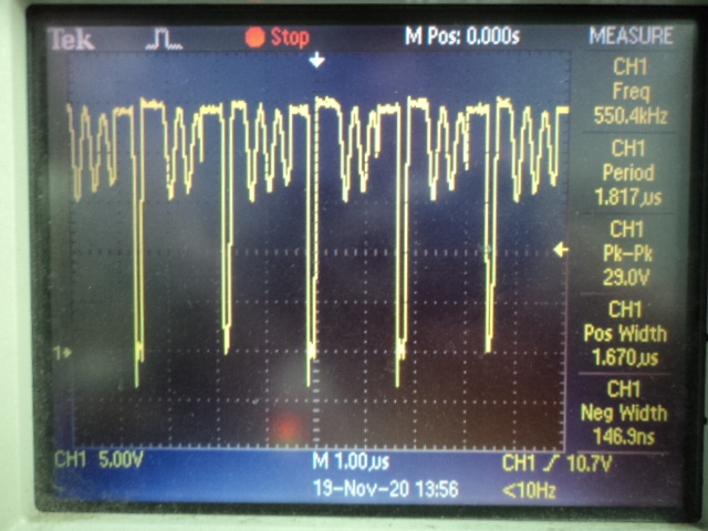

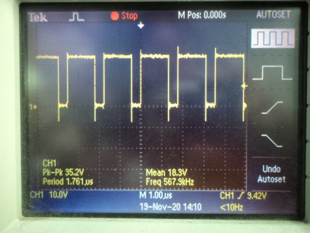

      Can you take a waveform of VCC, SRN, PH and STAT when you have no battery connected? When you see charging and not charging, can you take a waveform of VCC, SRN, PH, and charge current? Do you see STAT1/2 indicating a fault when charging stops?

    the info you requested is below:
    With no battery attached: Vcc = 23.76V, DC no waveform, SRN = 20.15V, DC no waveform, PH waveform attached. What did you mean by STAT waveform?
    Charging at 3A: Vcc = 23V, DC no waveform, SRN = 17.5V, DC no waveform, PH waveform attached.
